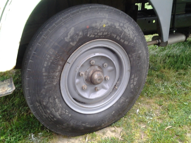

Had my first shakedown run on Wednesday, to a mates place 5km away. Oil ran freely from the rear gearbox seal. Coolant ran almost as freely from the Waterpump bearing. So I rang my local Autopro. He said he could have a waterpump next morning, and he did! I thought I would have to match up a gearbox seal, but he had a listing and had one on the shelf! Handy having that 2R Corona motor and box in there at the minute.
Got home yesterday to find Dave (dave NQ) and Joe visiting on their way to Griceys. This morning they helped me fit the seal and find some proper tailshaft bolts to replace the daggy whitworth ones that came out.
Got the old waterpump off this arvo, and the newie will go on in the morning.
A few new tyres on Wednesday and we should be good to go.
:D Matt.
Re: Elf and Safety
Posted: Wed Oct 11, 2017 11:53 am
by Farmer
Waterpump fitted and all good. A few more odd jobs and it was time for a run to town for some tyres.
Its amazing the difference new radials make. The trip in was pretty steady as the old rags were pretty hard and crackly.
Now it rides better, steers better and goes better.
Got the re covered seats in there.
Yeah, they're bright, but Dobby likes bright colours. And like Dougie the tyre service guy said, they'll bed in. Just needs a few thousand kays worth if bums.
So he went great all the way home, but then he wouldn't idle. So tomorrow brings a carb investigation. Ah well better now than on the road to Mudgee. ;)
