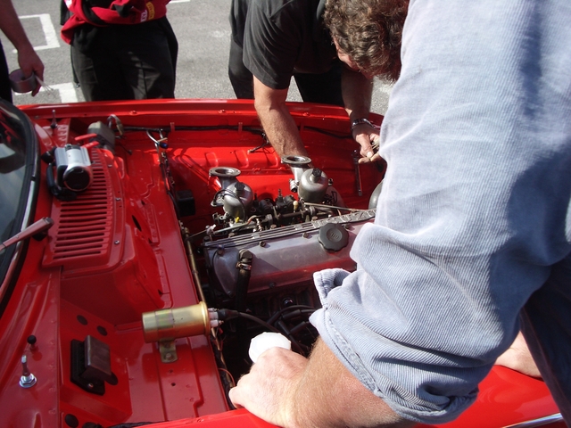

A bit of engine fiddlery

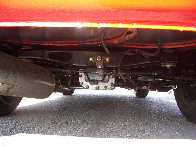

mark.... i notice in one of those pics u aren't running the rear transverse leaf spring....
can i ask why? is just they handle terribly without one, or more.
cheers.
Re: the life of rolie
Posted: Wed Jun 29, 2011 1:33 pm
by Pombellett
Hi Brett, we looked at the transverse spring and concluded that it did nothing more than limit the droop, and hence the tuck under of the wheels (and add on quite a few kgs) so the whole lot went in the bin.
We've checked the above mentioned movement with the limit of the shock absorber travel, and it all seems to work fine. The only, very minor, problem we've had with the rear is that we have a little too much tow in, which is making the turn in a little aggressive....easy fix though.

ALARM ALARM! :!:
This is a scarey prospect for me. I don't know a lot about competition, suffice to say I'm a 30-year-ago novice, but the thought of running without the leaf has me shaking.
I immagine if the shocks are hard enough they would reduce initial body roll, but if the guts comes out of the top of the unloaded shock, theres nothing to stop that wheel laying on the hubcap. I think it would be more correct to say the leaf doesn't do enough.
I suggest go to the bin, fish it out, and put it back with a second one piggy-back. I will even go over to the shed, get one out & mail it to you if needs be. I did this in 1979 along with back springs in the front, and it made the car seem like it wanted to go AROUND the corner instead of onto it's roof. The camber is adjustable with extra rubber blocks above the leaf ends.
For the record , I wouldn't drive around the block without the leaf in, let alone a track.
Not trying to tell you your buisness, just really REALLY don't want to see all that fine work undone.
Cheers, Matt. :)

My street cars are running the transfer spring modified. The club car has had it removed also. My car is running a set of vn lowerd commo springs in the rear with a set of koni adjustable shocks limiting the downward travel. The bellett that i compete against is of the same set up although i don't know what shocks or springs Glen runs (he needs to have some secrets :lol:). This car has been run most of it's life as a race car and very competitive in it's class. In saying this it is my intentions to run limiting straps in case of a shock failure. As far as handling goes at this early stage of development is awsome. I have also had a good look at pr91's set up and intend to graft a few of his idea's into the car also (i have a 3 second gap to fix Glen ;) ). It is good that people share their info it save's time and stress but there is alway's room for improvement.
p.s I did not advise Mark that this was the way to go he did know i dont run one and Glen and Mark have swapped emails. I for one would be interested in what set up is in rolie.

Well this is all very interesting isn't it? We came up with this idea for the rear end set up completely independently, and then my Scandanavian friends(where are you Ari, Antti? you can join in if you like :D ) confirmed this is how they set theirs up.
Like you Matt I had my reservations, but everyone I've spoken to (including my mate who built the shocks) said they would be man enough to handle the impact of a lifted wheel.
If this elegant Colin Chapmanesque solution works, it'll be spot on for us. If it does't we'll find out hopefully in testing and not the race. Or at least in true Chapman style maybe it'll fall apart on the slow down lap after the flag :o :lol:

after spending all my life around race cars and the building and preparation there of, including racing my own Bellett for nearly 15 years with proven results (including posting pics on here showing how well it handles which is it's strength and it's widely regarded as the best example built in this country...) i thought i may have known a thing or 2 about the traits of Bellett's and how to fix them... But obviously not. I'm only too happy to offer as much advice or knowledge as possible to help those that ask but it seems some are experts with the first one they have been involved with. Better your neck than mine racing one with no rear spring and enjoy the rebuild due to the roll over it causes... And i wish u luck with getting the front end to work too.

A std bellett (ie std spring) will handle ok, start to push it and things can get scary if the backend gets some air under it.
The prolem being the std spring drops the rear wheel down resulting when the car touches down a very shortened track and the subsequent movement of the suspension upon loading can result in at sometimes buttock clenching moments or worse :shock: :? .
A modified (ie GT works spring or various incantations of the mulit leaf) will handle better as the rear wheels no longer make radical track and toe changes as the spring limits the wheel travel and rate.
A car without a traverse spring needs to have a method of preventing the large movement of the rear suspension.
As such modern aftermarket shock absorbers have rebound and compression adjustments which will control the suspension movement and selecting the correct damper (shock absorber) will also limit the suspension travel like the traverse spring.
A car without the correct damper will require travel limiters to prevent the suspension dropping to far and causing the aforemention gymnastics.
It is probable that the spring rates will be different due to there being not an effect from the leaf spring.
Now with the car suspension travel confined to a specific amount (this may not be appropriate for a road vehicle because of ride quality, transport department regulations) the selction of springs and damper rates can be adjusted in the same manner as any other vehicle to obtain the desired feel the driver wishes.
Really its horses for courses and how you want to set your car up.
In saying that spring rates, rebound and compression, roll bar rates are easier to get from the manufactureres than leaf spring data.
Now Bella has been lowered as far as you can for the street, with selected springs and non-external adjustable shock absorbers and during some corners would wobble a little and chirp the rear tyres as the suspension moved around, her next modification is a multi-leaf spring (data provided by another forum member) as I cannot afford adjustable dampers.
