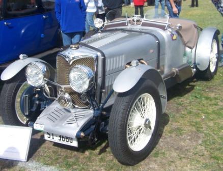

I've attached here another Tasmanian Riley for you - a home made replica of a 38 Brooklands special
Riley Brooklands.JPG (35.17 KiB) Viewed 44986 times

That's one pretty car Yellow and I bet there's NOT AN OIL LEEK IN SIGHT :lol:
