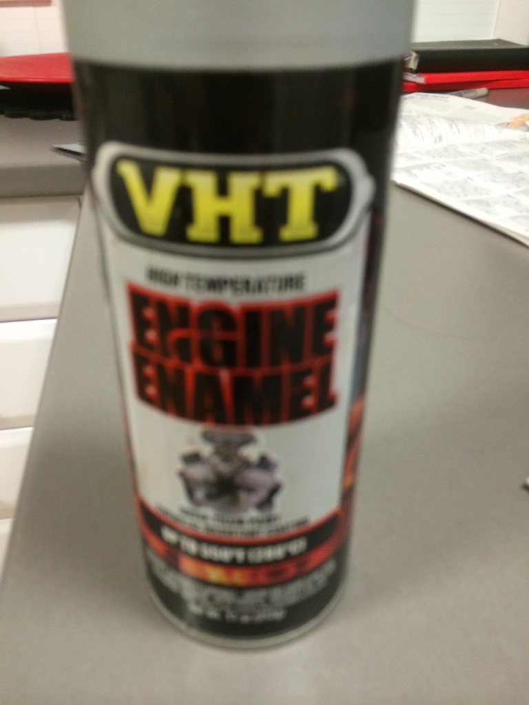

by yellowperil
VHT Engine enamel.jpg (160.91 KiB) Viewed 26077 times
Hi Mr flibbles
Go to a Bursons or Repco centre and get a can of VHT Engine enamel, they come in various colours and go on without a primer. Give it at least two coats. unlike a lot of spray cans, it goes on well but as Glenn says, best used if you have the engine out. It's also been proven that a red engine will improve your car's performance.
I used it to do the block in the yellow peril when I rebuilt the engine about 10 years ago and it's still all there.
