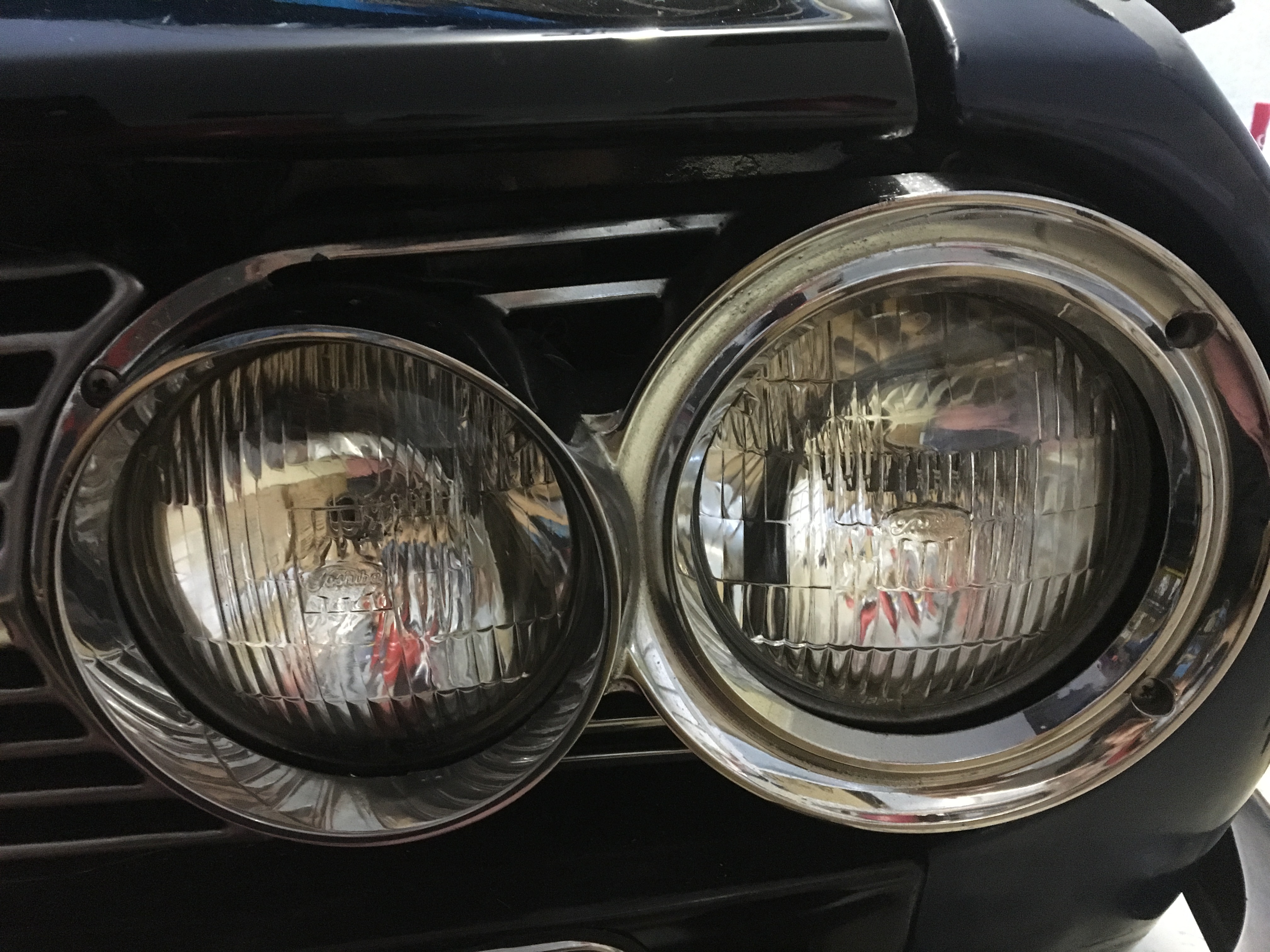

Fri Jun 08, 2018 1:38 am
Here are mine they look the same ?

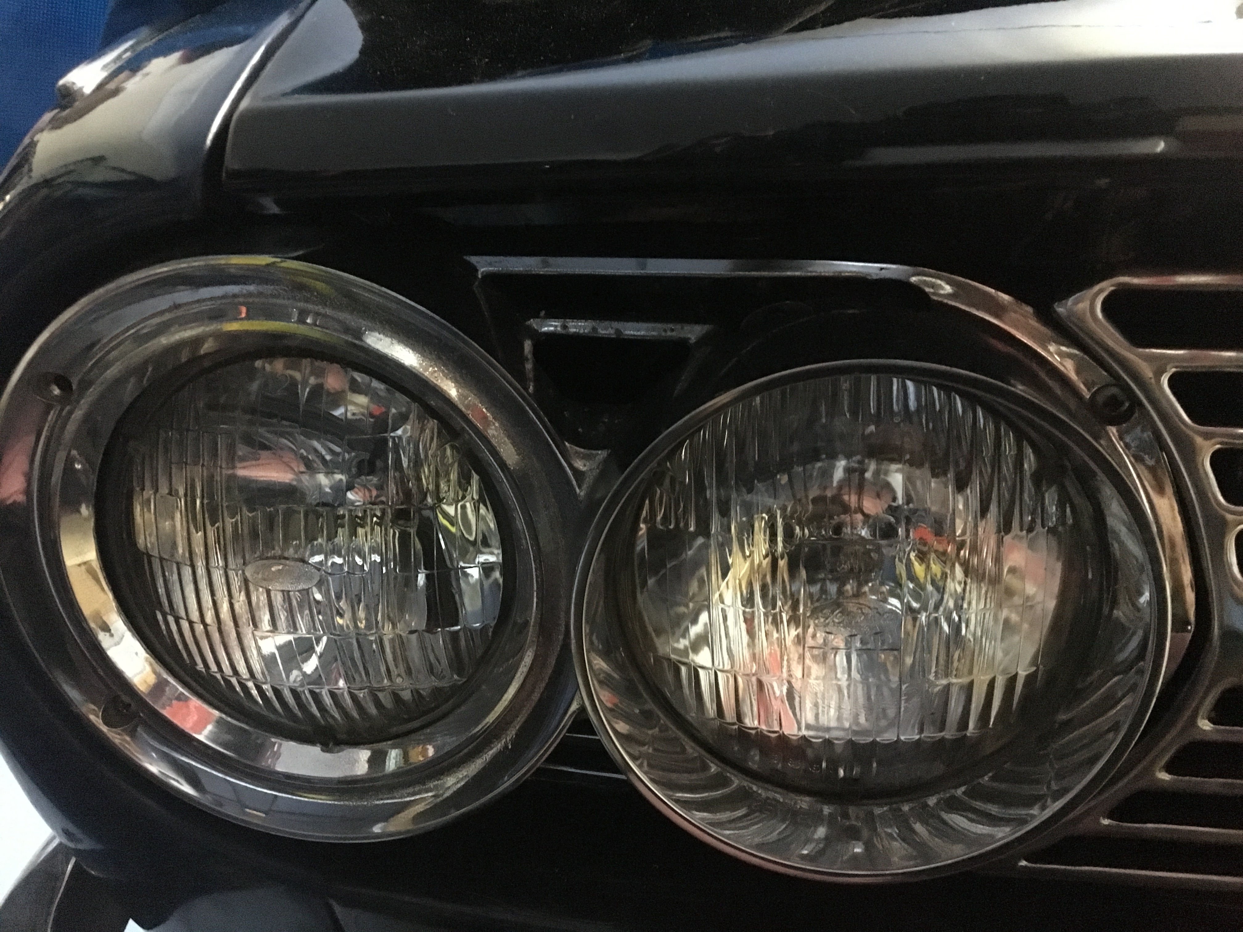

Fri Jun 08, 2018 6:51 am
The other side
