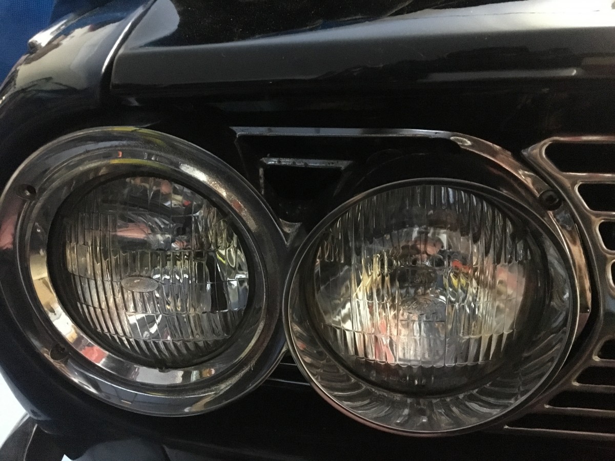

Today I discovered something interesting. The parts around the headlights are a bit different, perhaps from different year models or something. Which one are correct for '65 or '66 Bellett?
LINK to pics
LEFT
Right
As you can see, the left one has bigger "holes" between the lights and ribs, but the right one has only a narrow one just like between the ribs.
I must ask Ari if he has those parts, left one on my car is in quite bad condition anyhow.

Fri Jun 08, 2018 1:38 am
Here are mine they look the same ?
Fri Jun 08, 2018 6:51 am
The other side
Posts: 75
Location: Tallinn, Estonia
Bullitt, on your pics they are the same as my left one.
But here, on the time machine are the same as my right one.
Actually a minor difference, but still. It would be interesting to know.
