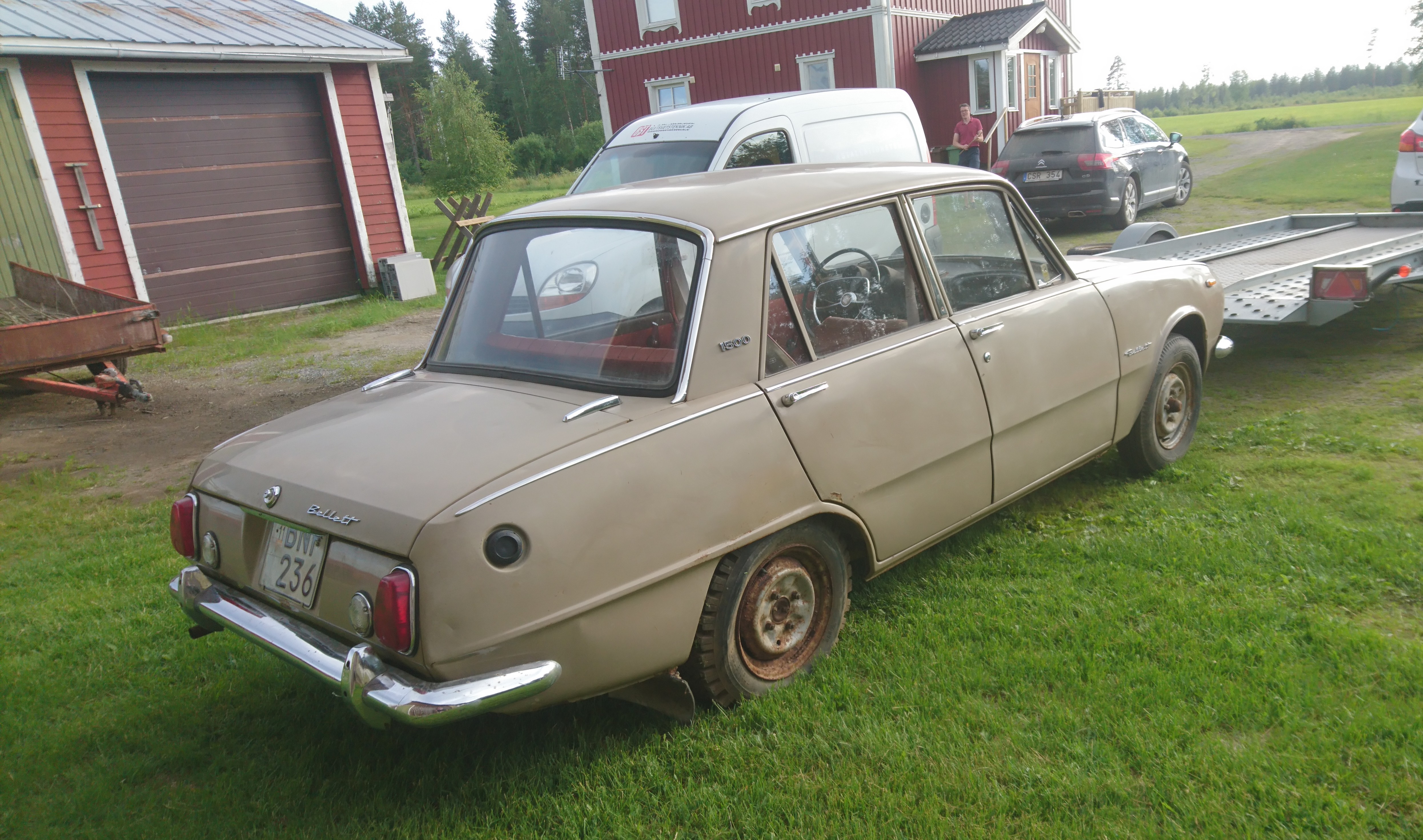

So... I found a Bellett here in Sweden! that hopefully will get back on the road someday, awesome car! but have been "off the road"/parked since 1977... any tips on finding parts? Clutch, brakes, engine stuff is the most urgent things

Great find.....well worth keeping and rejuvenating/restoring. Simple and easy to work on.
I would suggest that you contact the Bellett Club in Finland. Great people and a wealth of Bellett knowledge.
Please keep as informed of your progress. More pics. would be nice also.
Lots of information here if you Search this Forum and ask questions.......

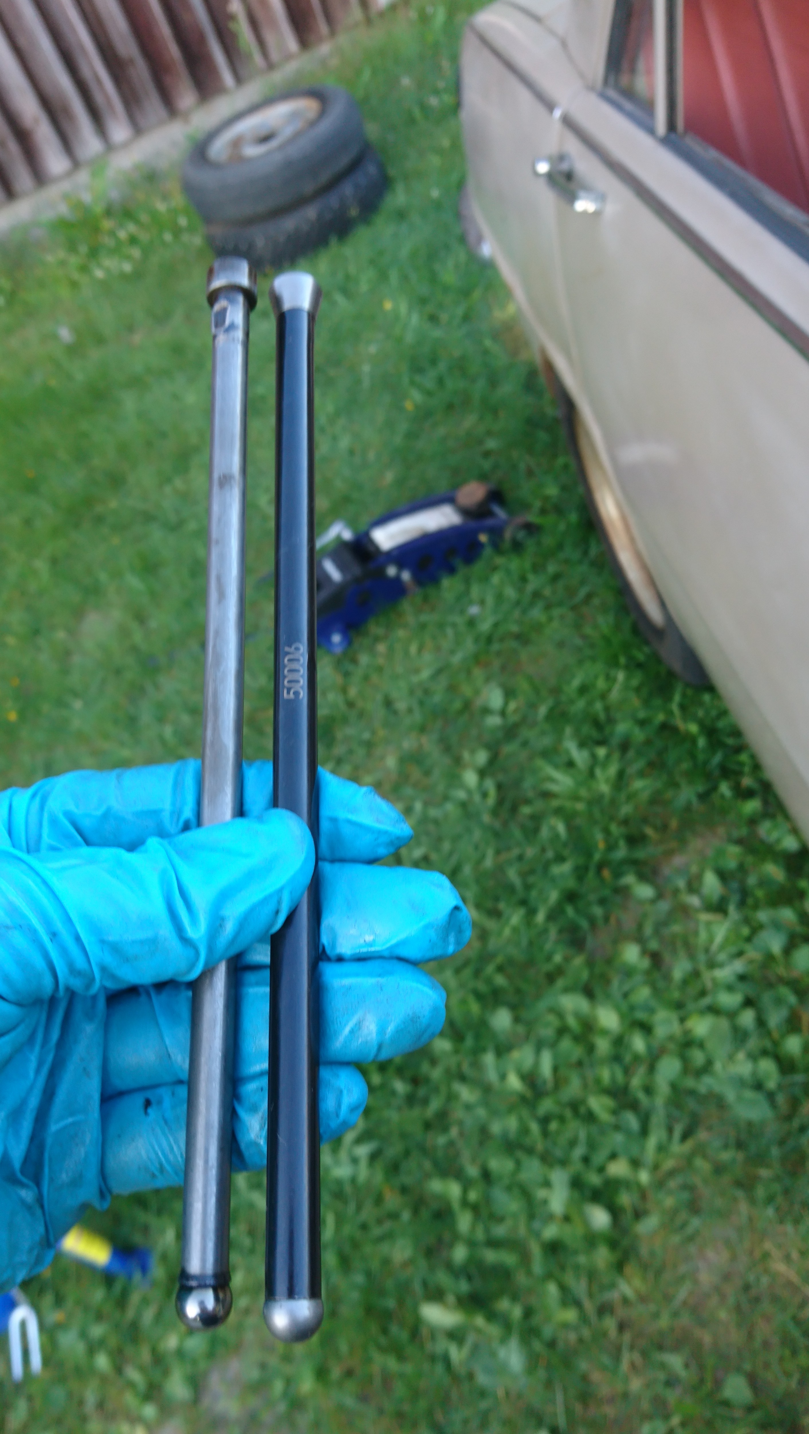

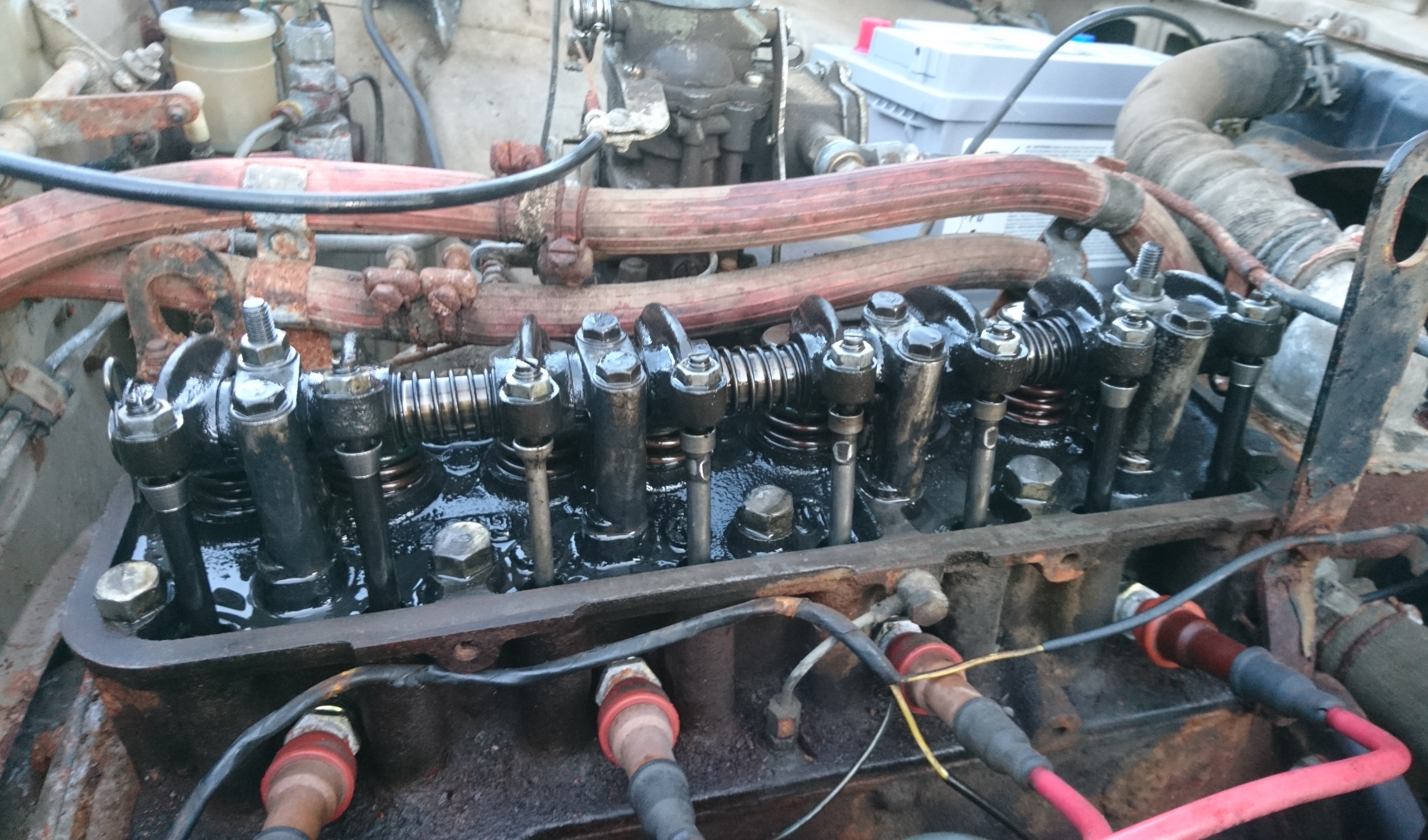

Things done/checked so far:
1. Engine turns freely.
2. Starter and starter relay works.
3a. Oil pump works (oil is getting up to the valvetrain)
3b. Discovered that I need to replace atleast 2 pushrods.
3c. Checked that all the valves move freely.

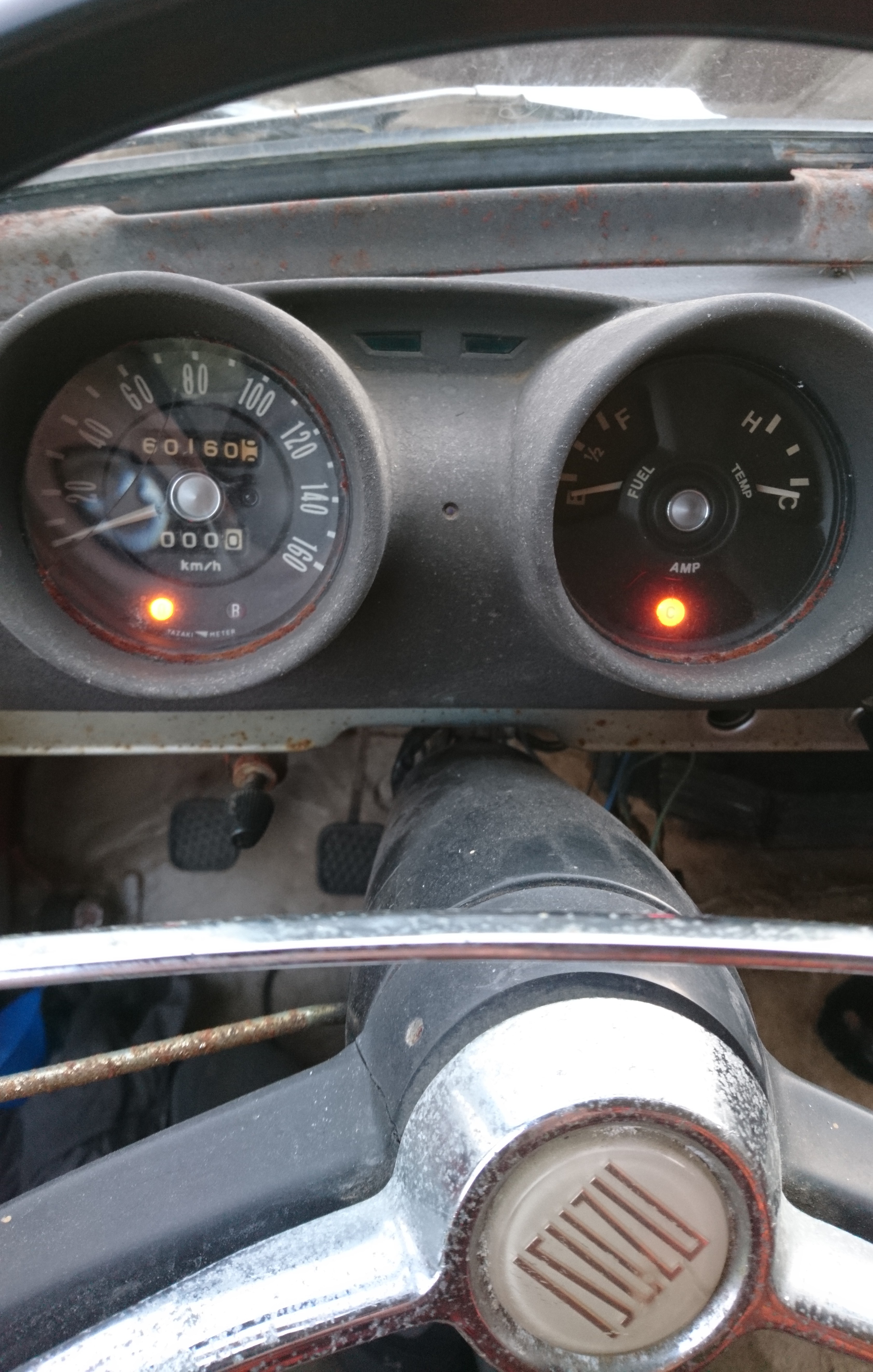

4. Most of the lights work, blinker relay is missing though..
5. Ignition stuff cleaned and gets spark all the way to the plugs.
6. Carb holds fuel and looks to be complete, valves and float moves freely.
7. Tires that aren't from the seventies and is about to pop at any second is now on so I can move it easily.
8. I have no keys but someone already took apart the ignition switch so I can turn it and bump the starter without keys.
9. Emptied the ancient engine oil and cleaned the filter housing from debris and well.. a lot of mud.. and put a new filter in.
10. Changed the cut in half/broken oil pressure switch with a new one.

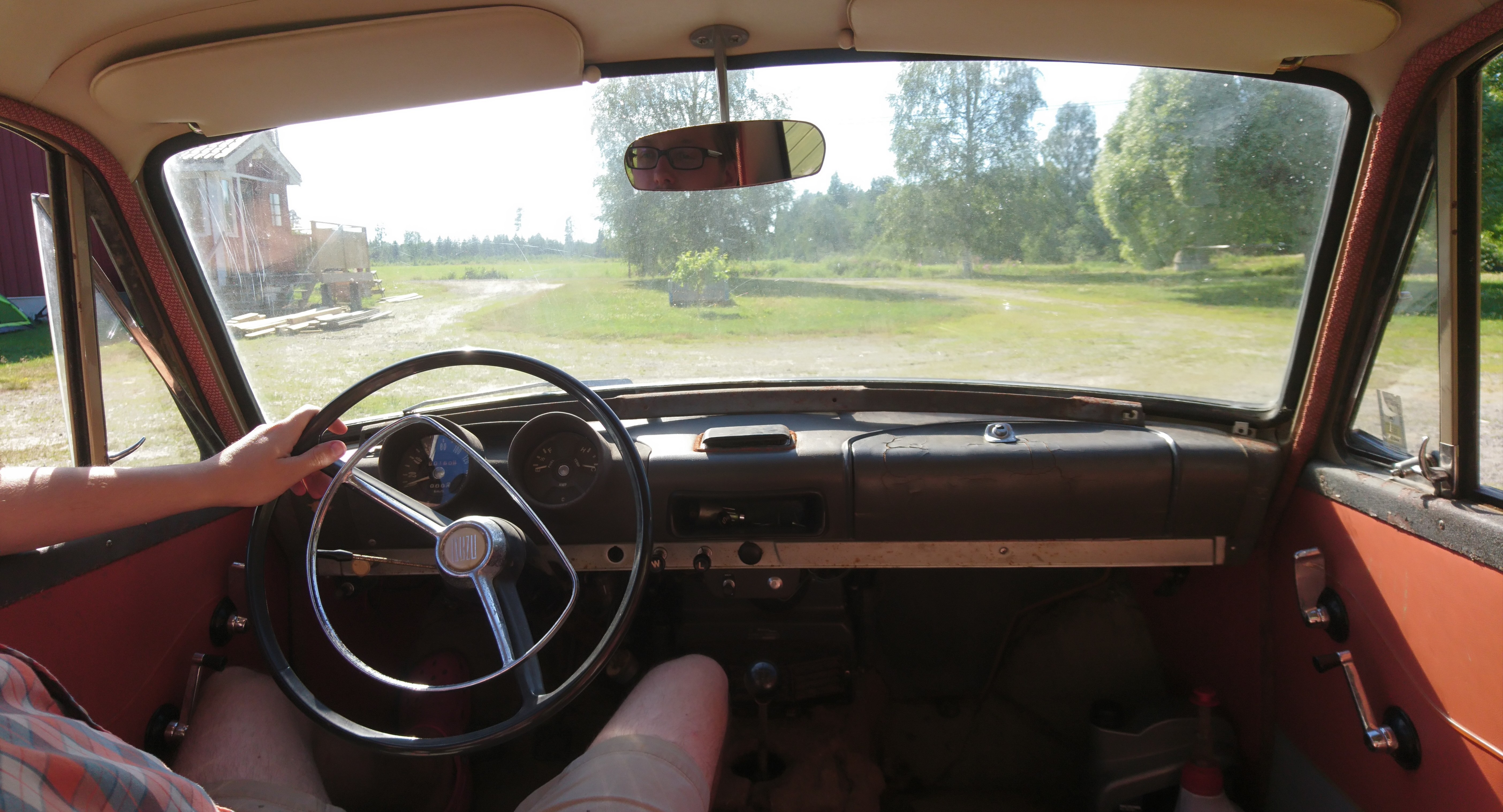

11. All the doors and windows open and close really nice, almost like new.
12. The rust situation is so far really good, might even pass the "far away in the future" inspection without any welding.
13. Ordered a few pushrods so I might here it roar before I leave it for a week of watching "Streetweek" dragracing with friends from the passenger seat of a turboed 1958 Chevy Impala :D

Finally got my custom length pushrods that I ordered! fits perfectly and doesn't rub anywhere, nice! 8-) had to use some "Tecnosil" black sealant on the very very old, crispy and broken valve cover gasket since I didn't have a new one laying around :D
Did also get most of the interior electrics working, gauges, lights, warning lights and switches.
Annnnd... Got the motor running aswell! Sounds awsome with a straight pipe :D until the carb bowl runs dry... since I haven't rigged up a fuel system yet :roll:

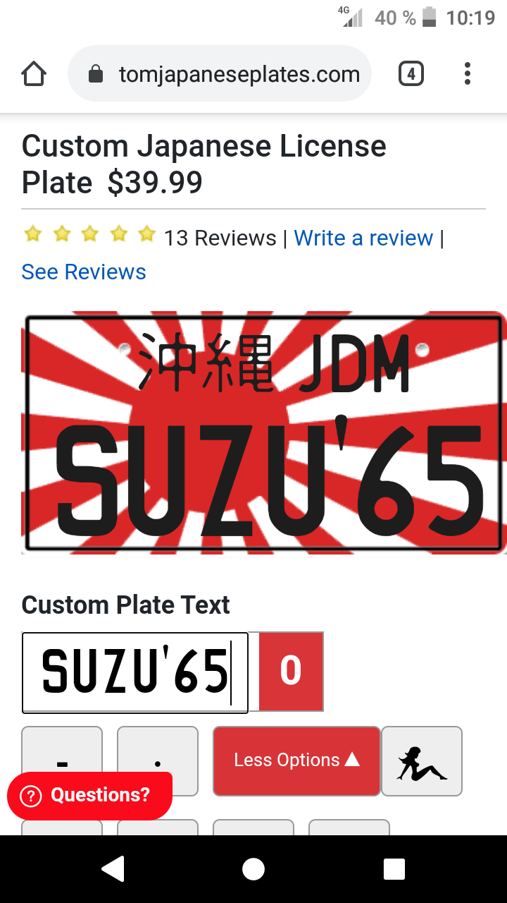

Maybe it needs some nice new reg.plates someday ;)
