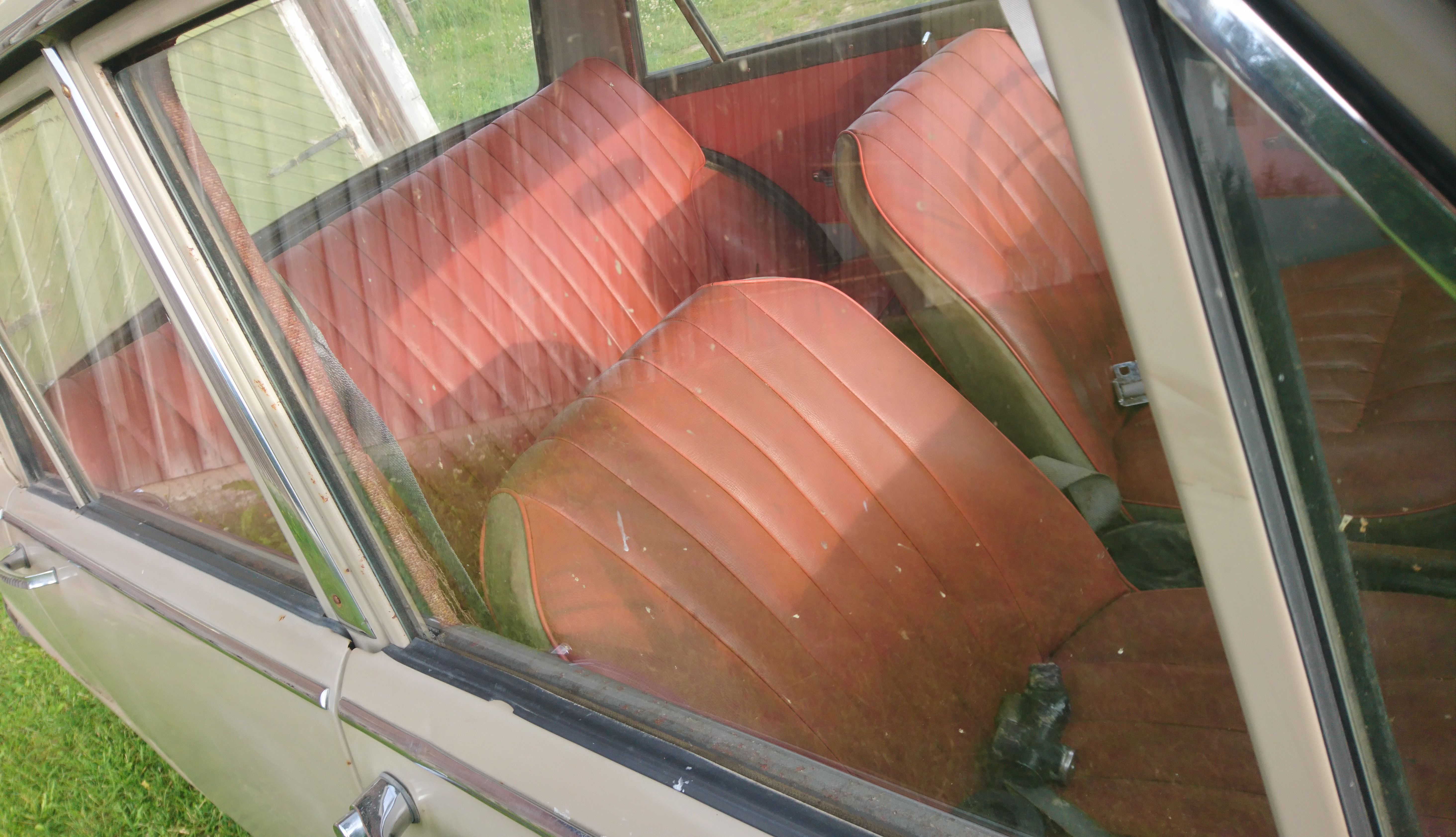

So... I found a Bellett here in Sweden! that hopefully will get back on the road someday, awesome car! but have been "off the road"/parked since 1977... any tips on finding parts? Clutch, brakes, engine stuff is the most urgent things

Great find.....well worth keeping and rejuvenating/restoring. Simple and easy to work on.
I would suggest that you contact the Bellett Club in Finland. Great people and a wealth of Bellett knowledge.
Please keep as informed of your progress. More pics. would be nice also.
Lots of information here if you Search this Forum and ask questions.......

Yea I have never even searched for a Bellett because I really thought they didn't exist in Sweden but I have wanted one for a long time...
All of a sudden one appeared in a japanese car group on facebook and not so far away from where I'm spending my summer vacation
sooo my vacation got really interesting really fast
I'm absolutely gonna keep it! and get it to running/working condition with whatever parts and things I can find, make or get renovated and later someday in the distant future
try to get it through the swedish car inspection...
When it passes that and is legal for roaduse again it will probably get a complete teardown for some serious renovation.
Ok yea I've seen that there is quite a bit more Belletts and other old japanese cars in Finland compared to Sweden so I will start looking there for parts and stuff.
This forum has already been super helpful and lots of motivating, inspiring pics of cool cars

You are so lucky as the body looks to be in reasonable condition and the mechanicals are simple.

Some more pics... I guess someone wanted a GT at some point of its life
