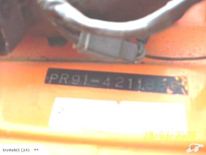

I did not recognize this when I saw it the first time.
I started out going down the used car listings for Goo Net and Yahoo JP, trying to find a picture of a VIN number. There are something like eight GTRs listed right now, and little surprise that all but one are from Eagle. Also, little surprise that none have a picture of the VIN number.
I went back and reminded myself of the location on the firewall, on the left end facing up just forward of the cowl on the cars that have the cowl. And none of hte engine compartment photos could be zoomed in on to show the number.
Then I went back to the New Zealand car that seems to have an inaccurate paint job and incorrect chrome details. The blurry picture is a picture of the VIN number. The black stripe shows the original paint, they taped over the VIN number when they painted the car orange. The car may have previously had a black cowl which they painted over in orange. The bright aluminum plaque is apparently some kind of identification added for vehicle registration.
The chassis number is:
PR91-4211866 (not positive of the last number)
This doesn't prove anything for the debate.
Either the W isn't printed on the car and this is a poorly detailed restoration of a GTR, or the W is on the GTRs and this is not a GTR.
Afterthought: Realizing that there is black paint under the orange on the firewall, either the previous paint had the black hood and cowl paint correct for the GTR, or the original color was solid black. I don't recall black as being an original color for these cars. That puts a bit of a twist on the confusion, doesn't it.
P.R.90

If the JAF paperwork is the cornerstone of the claim that GTR chassis numbers are "PR91W-#######", then that claim is very weak indeed.
I have already provided examples of errors in JAF paperwork in event reporting.
I have pointed out the observation that the JAF fills out the paperwork, not the car manufacturer, as is indicated by the JAF official's signature on the bottom of the paperwork you provided, not an Isuzu employee. Any and all statements or claims that Isuzu was responsible for what a JAF official wrote down are simply inaccurate.
And if the claim is that "race officials do not make mistakes", then either you haven't been racing, or you don;t have enough experience to witness the fact that race officials are just as human as the rest of us and they make just as many mistakes as the rest of us too.
And of all the strange and unexplainable things in the information and history of these cars, the one thing that can't possibly be is for a third party racing governing body to add a descriptive digit to their internal paperwork that doesn't match the original chassis number of the vehicle as manufactured by the car manufacturer? That's putting a blind eye to all the other strange things about these cars.
I'll ask for the clinching proof again:
1. Do you have any of this JAF paperwork matched to _any_ Bellett GTR upon which the chassis number printed on the vehicle firewall can be matched to the paperwork from the JAF?
2. Do you have any picture of the chassis number printed in any GTR that has a W in the chassis number?
There are supposed to be more than one GTR in Australia. This would not be an insurmountable feat without even leaving the country. Do any of these cars show up at shows? Are they left on display with the hood up?
If they are in public with the hood up, you can take a picture. If they never show up to shows, the owner refuses to open the hood, or the owner refuses to allow a photograph of the chassis number, then there are several questions of "Why?". Either your assertion is wrong, and they have a genuine GTR which genuinely does not have a W in the chassis number, because your assertion is wrong, and they want to avoid false accusations. Or, they know they have a fake car.
You have an interesting theory, a very persuasive theory. But it is still just a theory. The proof is finding visual evidence that there is any car anywhere with a W in the chassis number stamped into the firewall. You don;t have that proof, so you still have a theory.
But, you've taken that theory and put it into practice as if you have proof. Basically, you saying: "If you have a you believe is a GTR and it doesn't have a W printed into the chassis number, your car is a fake!". You're also telling "PR91W", the gentleman in New Zealand, member of this message board, who is selling his car right now that "he has a fake, he now knows he has a fake, and he is a crook for presenting that car for sale as the genuine article and at a price of $19,000-25,000".
Up until examining the chassis number picture of that New Zealand car, I was leaning toward the opinion that it was not a GTR, and that an unfortunate fellow Bellett owner had spent a lot more money than he should have, believing that he was buying a GTR.
But there is black paint under the orange paint on the firewall of that vehicle. Black is not a primer color that anyone would use under a light color like orange. Black was not a color offered as original on these cars.
This leaves me leaning toward the opinion that the New Zealand car is a genuine GTR, and the claim of a W in the chassis number of GTRs is not accurate.
If someone comes up with a picture of a chassis number stamp with a W, I'll change my opinion and the debate will be over. But, without some visual evidence, it's still just an unproven theory.

I posed the question to the Bellett Owners Club Tears.
Original message:
すみません。 変な外人は質問があります。
英語のベレットのコミュニティに大きい議論があります。 議論はベレットGTRの確認の為にです。 車のfire wallに車のシャシの番号は質問です。
[車のfire wallにGTRのシャシの番号はPR91W-#######です]と一つグループは言っていました。
[車のfire wallに全てのベレットGTとGTRのシャシの番号がPR91-#######です]と他のグループは言っていました。 [車のfire wallにベレットGTRにWがありません]と他のグループは言っていました。
日本人のベレットのオーナーズは助けて下さい。
Translation:
I am sorry. A crazy foreigner has a question.
There is a great controversy in the English speaking Bellett community. The controversy concerns the identification of the GTR. The question is the chassis number on the vehicle fire wall.
One group says that the GTR chassis number on the fire wall is PR91W-#######.
Another group says that the GT and GTR chassis number printed on the firewall are all PR91-#######. The second group says there is no W in the chssis number on the firewall of the GTR.
Japanese Bellett owners, please help.
The answer from Koji:
こんばんは。
お答えします。
fire wall(バルクヘッド)のシャシ番号はPR91-#######が正解です。
車の書類にも、一切「W」の文字はありません。
ボディはGTもGT-Rも共通ですからね。
私のGT-Rも、もちろんPR91-#######ですよ。
このため、GT-R用のパーツを取り付けたGTとの外観での違いはなかなか判りません。エンジンをG161W(DOHC)に換えてあれば、ますます判りづらいです。
あとは細かい所を見ていけば判りますけど・・・
Translation:
Good Evening.
I answer you.
The correct answer is that the number on the firewall (bulkhead) is PR91-#######.
In the documents of the car, there is not a W either.
This is common to both GT and GT-R.
The chassis number of my GT-R is also, of course, PR91-#######.
Because of this, it is difficult to know the difference by the appearance of a GT which has GT-R parts installed. If it has the G161W (DOHC) engine, it is harder and harder to tell.
Though I can tell if I look at a small place...
This would seem to be confirmation that there is not a W in the chassis number printed on the GTR, or the paperwork that accompanies the GTR.
It also confirms that there is a way of telling the difference between the two that those in the know are not willing to share with the rest of us.
