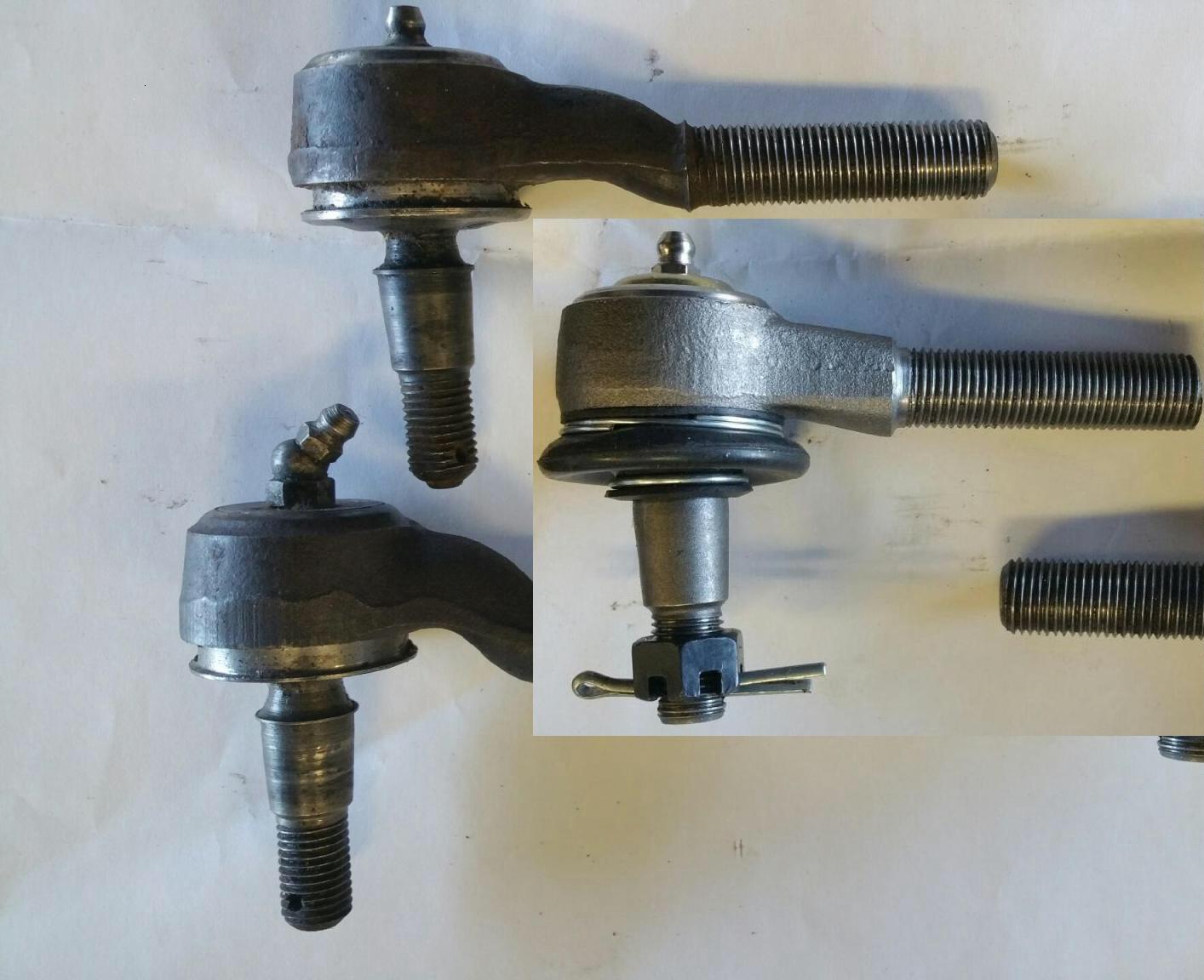

Re: TIE ROD ENDS

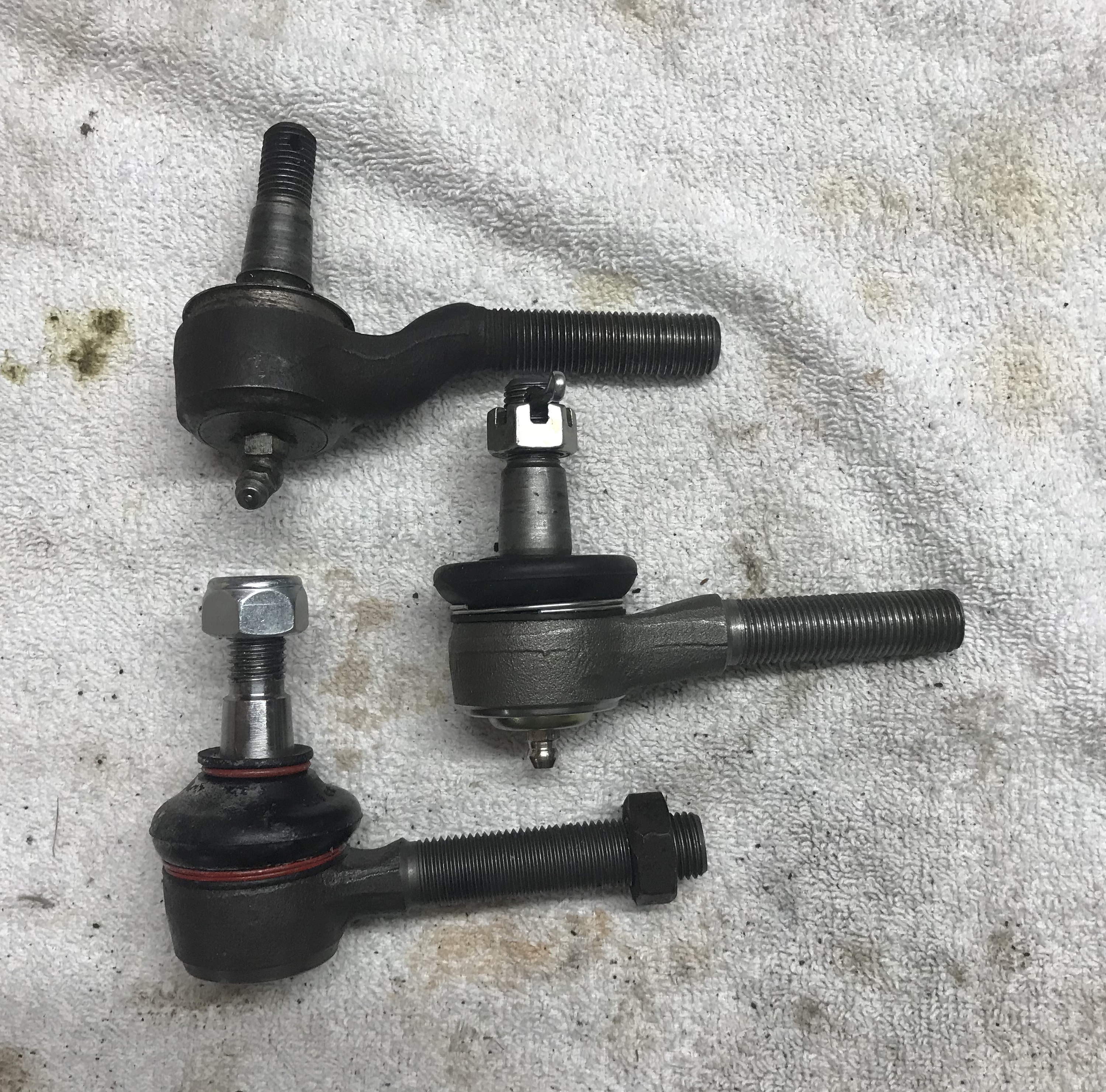

I assume they will be left and rh versions? I 'think' one side has left hand thread ?Asroc66 wrote:Mike is a top bloke
He does ask that someone fit and test drive to be 100% sure no hang-ups
We are pretty damn sure all will be good though for early models as I supplied 66-67 rod ends as in picture as well as steering arms off the spindles
Bulk order would be welcomed though
That's up to you guys from here
J

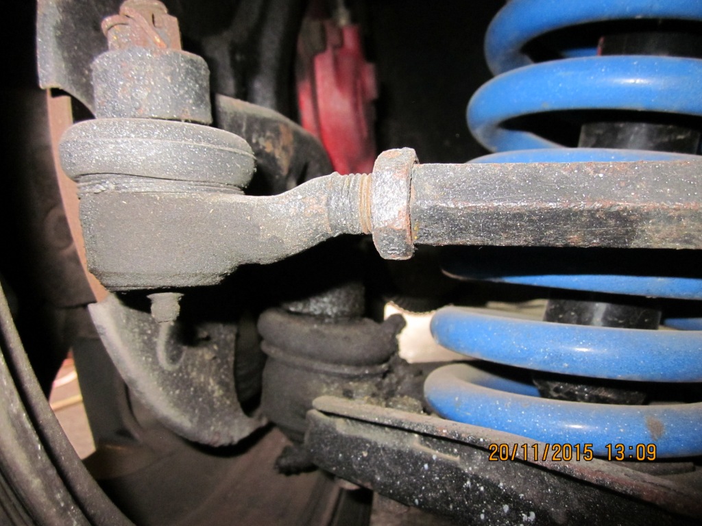

On appearance it appears my Sport is the same. anybody confirm ? (pictured)
Is he happy to tell us what they are off ??? Rough costing?
I am guessing that bump steer 'might' be affected with the different offset..... although Belletts have it already, could be better or worse.

Re: TIE ROD ENDS
The threads of the tie rods are the same from left to right and hence one fits both sides
The leg work is my gift to the Bellett fraternity
The knowledge of the tie rod is Mike's to divulge but remember, this is his bread and butter so to ask
Could be construed as rude
J
J

Can he advise where they are made? Some parts like this these days are poor quality in aftermarket.
Looks like the rack ends are LH threads.

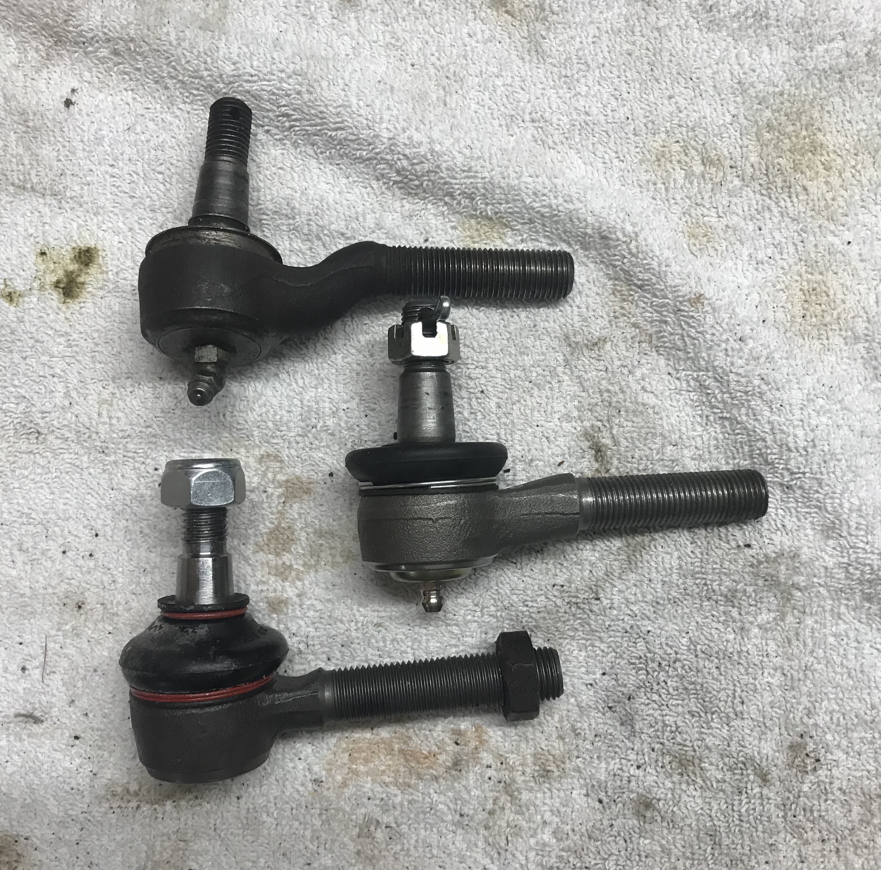

Re: TIE ROD ENDS
I couldn't get my head around the pic so flipped around the new part.... this makes it appear it has LH thread though.....it does not.
Hi Kerry, yes i think you might be correct. Although i wonder why they (Isuzu) put the bend in it ?
Are the Bellett ones two different years in the picture? early/late ?

90% of the knackered tie rods I have are the ones with minimal offset
+ my cars are lowered so I wanted minimal offset centre of thread to centre of ball due to travel requirements of the steering ends
They sit in defined orientated slots
J

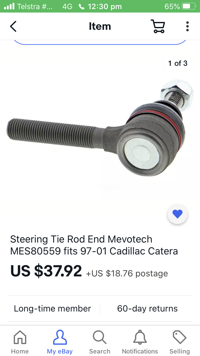

Hi All
No responsibility taken as have not fitted to my cars but have been busy beavering behind the scene and finally found these, they seem to be a good tie rod for lowered vehicles,
Has been a real challenge to find with a right hand thread
J
J

Re: TIE ROD ENDS
The Cadillac Catera is based on the Opel Omega built between 1996 to 2001. This vehicle has the "V" series
platform the same as the Commodore in Australia.
Which leads us to the assumption that if the Commodore (not entirely metric) tie rod ends may fit the Bellett
and be readily available in Australia.

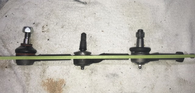

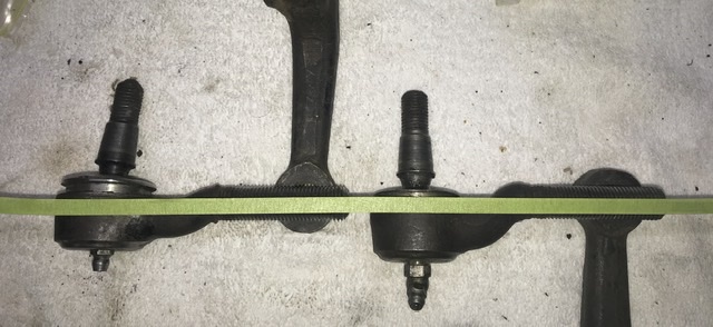

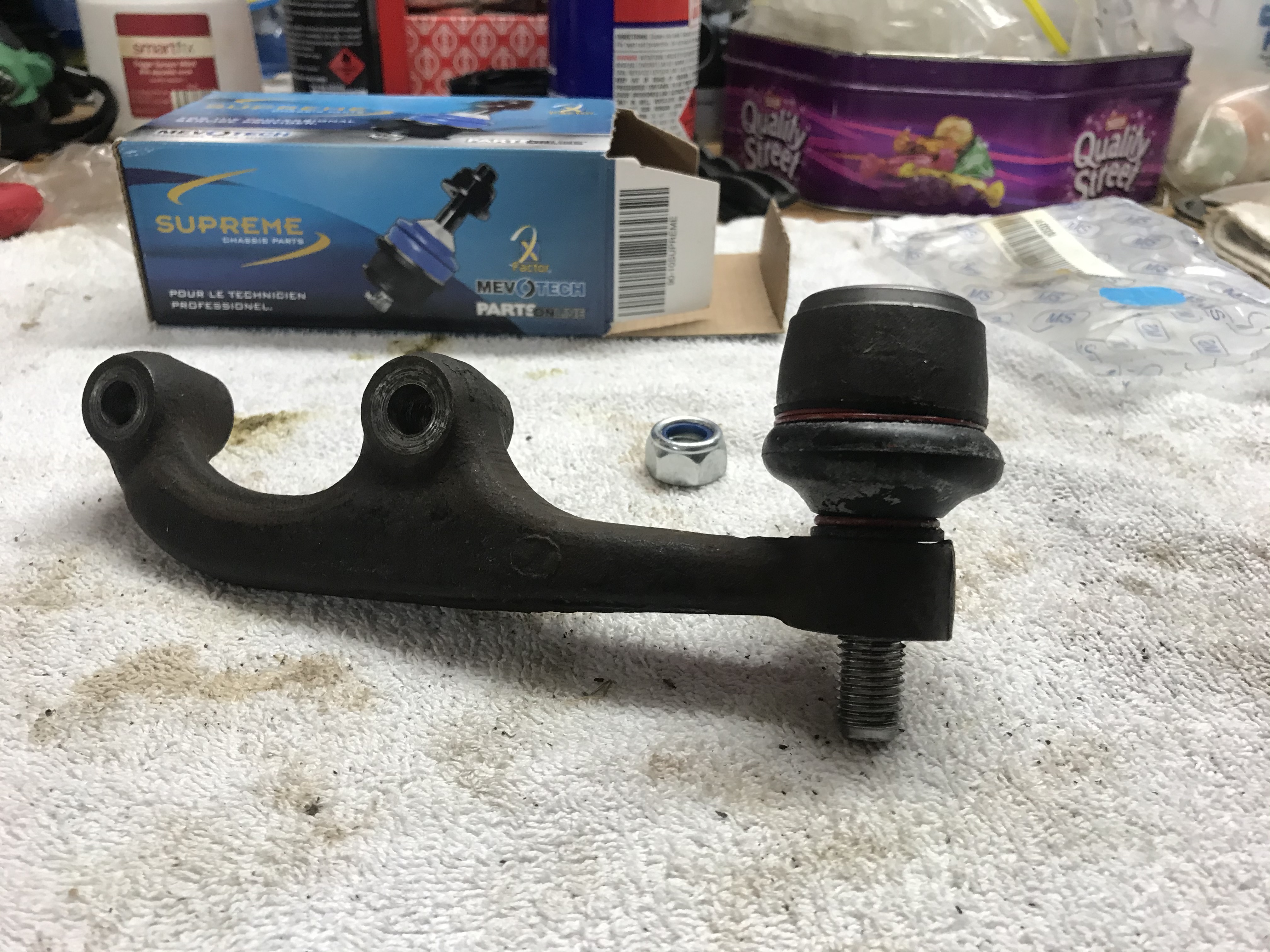

Be VERY CAREFUL.
Those looks like the ball is located slightly higher than the original in relation to the threaded section. Any change in things like that can give problems with handling, especially bump steer.
Might not look like much but believe me.... 3mm can make a huge difference.
- Asroc66
- Posts: 428
- Joined: Tue Jun 18, 2013 5:09 am
- Car(s): PR91 1967 GT, PR20 1966 1/2 with GT Goodies
- Location: Sydney NSW
Re: TIE ROD ENDS
As I said I take no responsibility - investigate with your own merits
Arrr the black art that is Bump steer
For those with keen eye sight amongst us......
The tape is 6mm
J
The tape is 6mm
J
