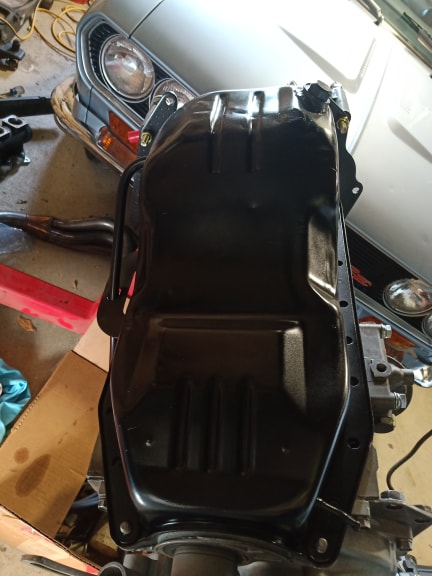

I have this type sump. Or does anyone know what other dipstick would fit this sump? One i could cut down to suit that will just fit the tube

Posts: 259
Car(s): 1967 GT Bellett
Waldo
That sumps looks similar to mine
I will have a look tomorrow night
i do not have a spare but i will take a photo, measure it etc
Cheers Flying
Wed Oct 09, 2019 1:57 am
Try a Gemini stick. I think the rubber sleeve is the same size and the length should be close. A tape measure will confirm or deny.
But make sure it's the same style Gemini sump.... because they had a couple of different ones as well.
