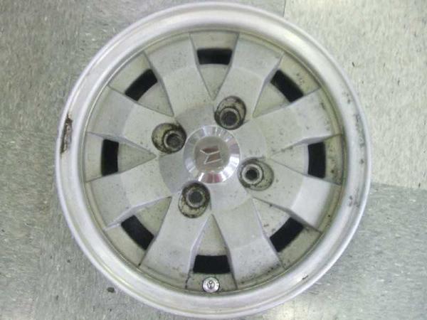

Found another set of wheels identified as being for Isuzu cars.
Anyone know which one this one might be from?
