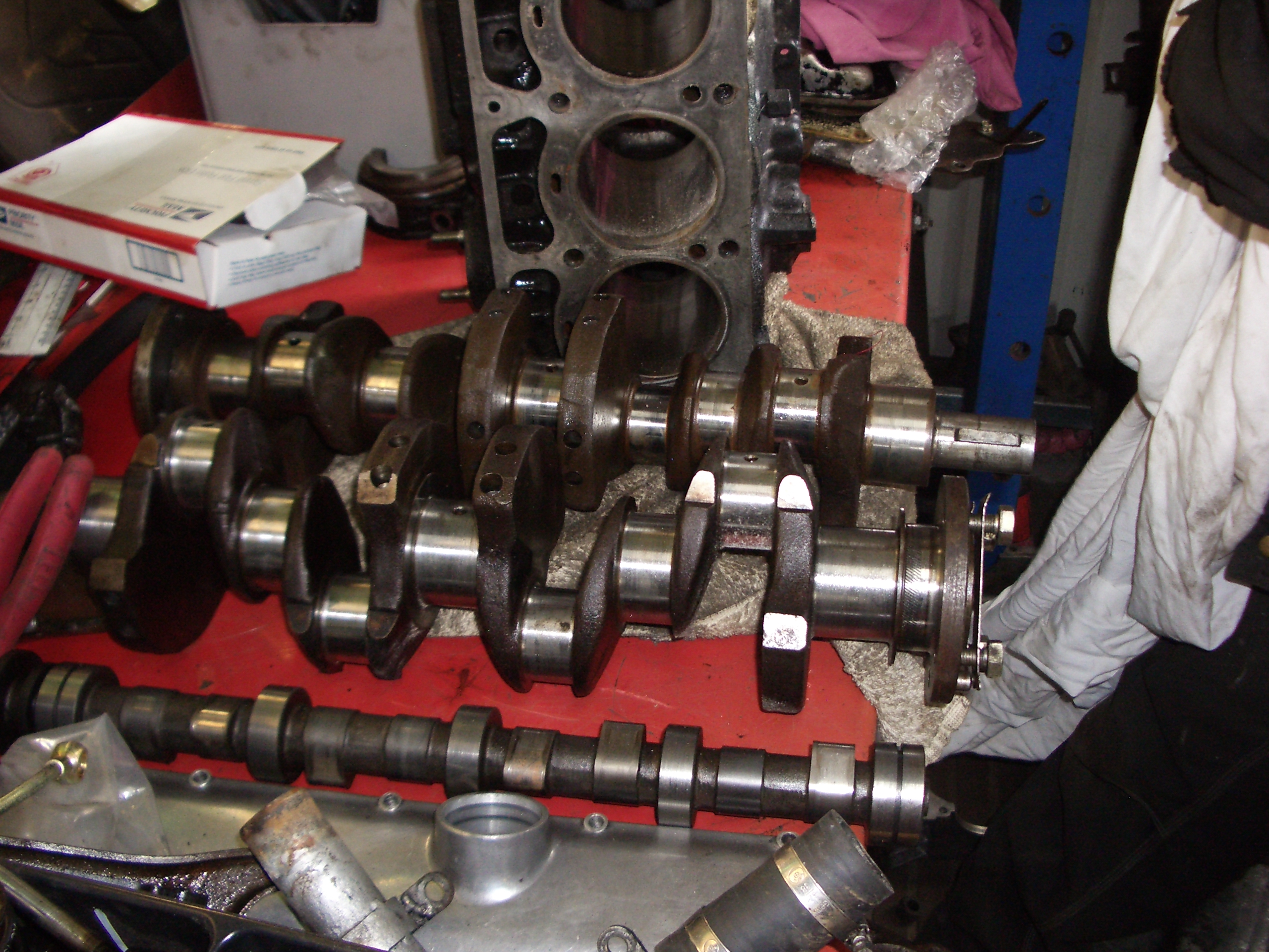

And on the right is the head being remodelled. We've had a little set back with the crank, and we're going to take a look at the one from the front cut that Greg sent with Rolie. The guys from mainland Europe reckon it might fit.....fingers crossed.
RobSA
Posts: 576
Re: the life of rolie
Post by RobSA »
I'm guessing you can't get JE pistons in the US to make you a custom one from a blank that is close (ie Honda and Toyota, from my trawling the various catalogues).
By the way where are you getting gaskets from?
As I have the same engine to rebuild.
The G150 crank should fit the G161 as they have the same bottom end, Dave or Brett may correct here but the bore was the thing that changed (oh and 3 bearing to 5 bearing no fit).

From memory the front cut was a 5 bearing.

hi greg from my limited knowledge the first few entries show the cut it looks like a 66/68 model hornd either side perhaps it is a 5 bearing ...my 2 bob ..geez thats a great little car cheers davo

Yeah, Greg, I'm pretty confident (back in Nov 2010) that we reckoned the front cut was a 5 bearing job.....you wouldn't believe how useful the whole cut's been, what an inspired idea it was for you to shove it into the container with Rolie.

Excellent info YP, that's a lot of research you've put in. Thanks, although, still a little undecided on how we're going to attack the valve train.
The good news is that the crank from the front cut is a good one and will fit...see below
The tale of two cranks.
By the way what do you guys do when you want to renew the rear crank oil seal? Even Ari is stumped by this one.

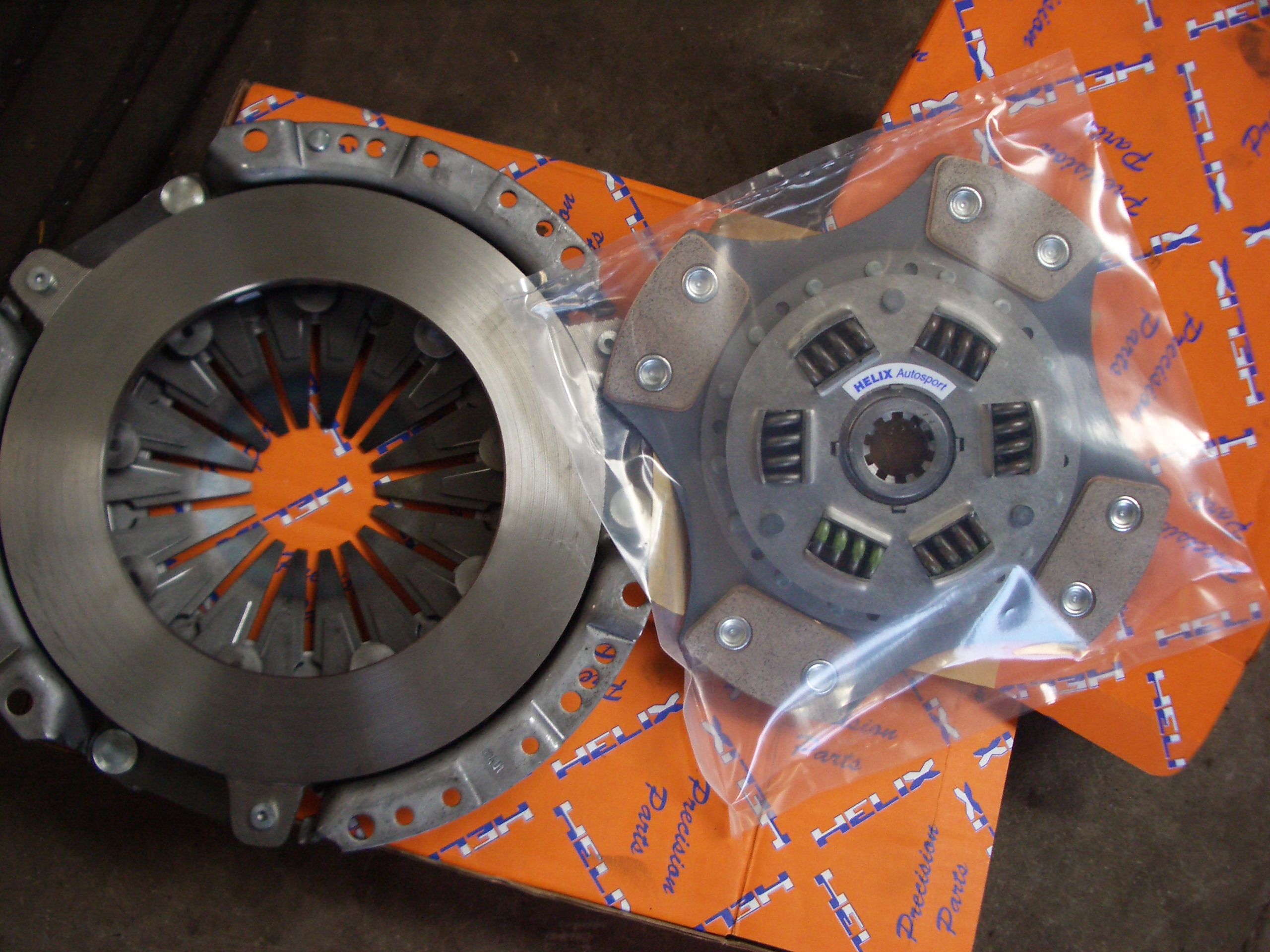

One other interesting discovery was made last week, when we went to a race clutch specialist and found that with only minor jiggery pokery a Triumph Dolomite Sprint clutch will do the job......so with the shaved flywheel and this little lightweight thing we're shedding the pounds where it counts (no jokes about my wallet please :D )

Your find with the Dolomite Sprint clutch is very good to file away.
