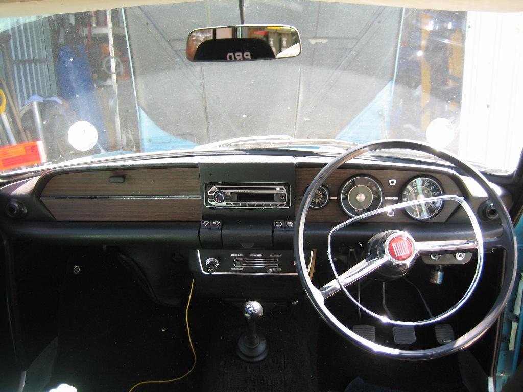

Hi guys,
Here's the dash photo that I promised from a previous post.
1969 Deluxe dash photo
Bellett Dash.JPG (222.36 KiB) Viewed 37093 times
As you can see it has the older style wheel even though this is a 1969 model year deluxe. I recon that it has the '68 style spline which would make sense looking at AriNorjd's photo above. This has steering lock but the ignition is still on the dash like the older model.
Does anyone know what steering adaptor will fit the older hub? I've got a sports wheel here but I can't fit it as I don't have a boss kit to suite!
My opinion for this is that the emblems were all baby-blue.
At least -69-> emblems are same colour regardless of colour of the car.
I agree with you AriNorjd! I think that they are all that colour, before Isuzu settled on the red emblem.
Ross

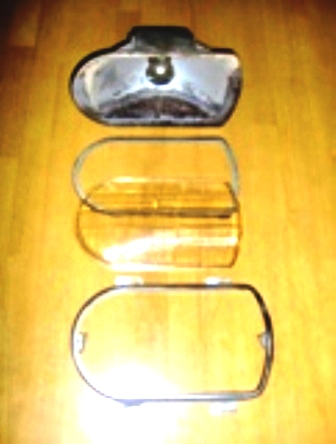

Post by BELLETTPR10 »
Square type headlight assembly for the pr10
Mark

BELLETTPR10
Posts: 210
Location: Florida
Contact:
Re: 1968 PR10 1300
Hey all, isnt the spline talk way off the original thread? please ....
Regards
Mark
C716
Posts: 7
Joined: Sun Nov 23, 2008 3:20 pm
Car(s): 1965 Mustang
Re: 1968 PR10 1300
Post by C716 »
BELLETTPR10,
Nice Pics on the breakdown of the "single headlamp" version. Of all the searches I have done on different flavour Bellets, the single headlight variety appears to be a rarity.
Oh yes, in answer to your question, Yes, this thread DID get sidetracked. This happens when people dont pay attention to detail.
C716
