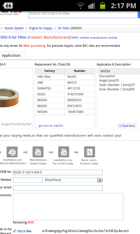

I was flicking through the Isuzu Bellett parts manual in that it has given me the isuzu part number of 14215-050 inwhich google-ing just the number provided me with some results on sites unsure if I am sending people on wild goose chases but I hope it provides some positive results. This is numbers one site gave me. Hopefully a Mazda AMC or othe manufactures aircleaner

GT air filter - TJ Filters B12 for Rover 2000TC. Old stock, so this is one for eBay, but they're around. Other than the John Deere filter all the others are now out of stock anyway.

Bah! At great expense to the management...these don't fit. Correct height, but taper towards the outer diameter and don't even make contact with the top of the filter housing. These bloody things are almost as hard to track down as a freakin' water pump!degruch wrote:GT air filter - TJ Filters B12 for Rover 2000TC. Old stock, so this is one for eBay, but they're around. Other than the John Deere filter all the others are now out of stock anyway.
