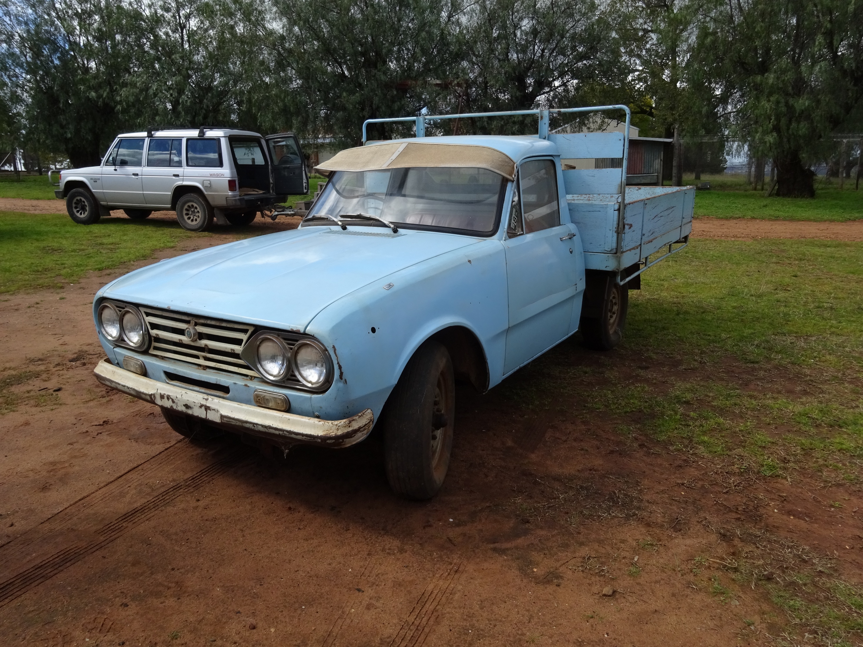

The Facebook picture that made me fall in love with a 1 owner, baby blue ute from Dubbo.........
My Dubbo Wasp

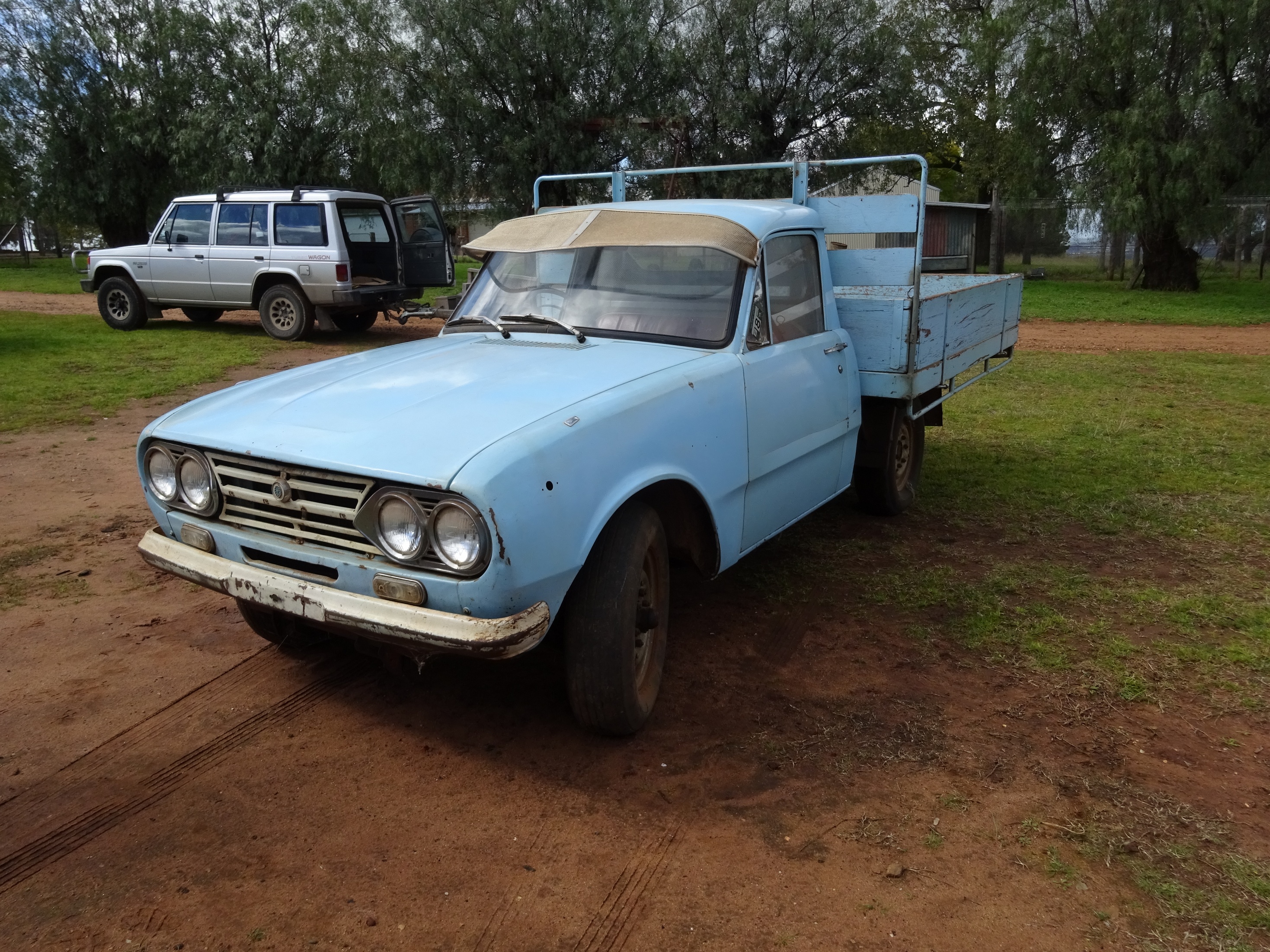

Some pics from the day I picked it up and the road trip home..... back roads style
Last time it was rego'd was 1981 and the sticker is still on the quarter window
Loaded up and ready for the journey north to live with Donkey
