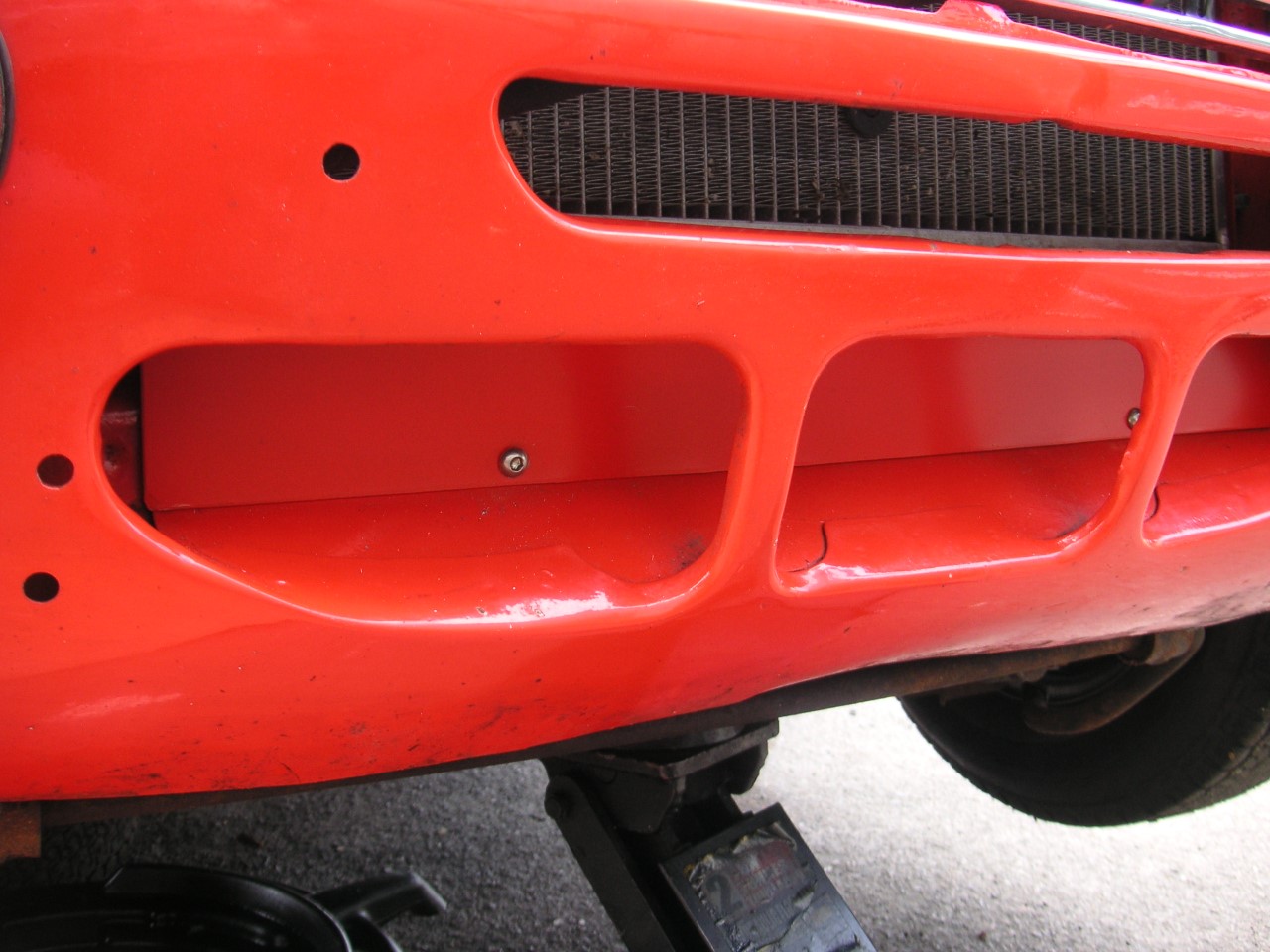

Another trick, if u havent done it, is to make a plate that directs air from the 3 cutouts in the lower stone tray to the radiator so it uses that air as well because if u look at a normal Bellett, that area just lets air into the engine bay and not thru the radiator. That higher pressure air can then stop the hot air from exiting under the car, as hot air always rises..... ;)
Fri May 05, 2017 4:47 am

Good stuff Brett......great minds and all that....have a look at what we did the other day!

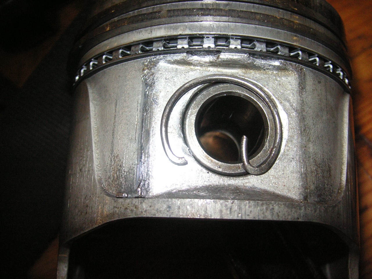

True enough Sticky....and we need it even more, as it turns out all the clattering has shaken a clevis pin loose....
....and now we have to re-bore as well......so it's a full on rebuild now.
A year or two back I found some NOS flat top 1.5mm over pistons...these will put us up to the best part of 1900cc....we have time to properly balance every thing, and put the flywheel on a further diet....so hopefully this cloud has a silver lining, and by silver lining I mean a second or so!

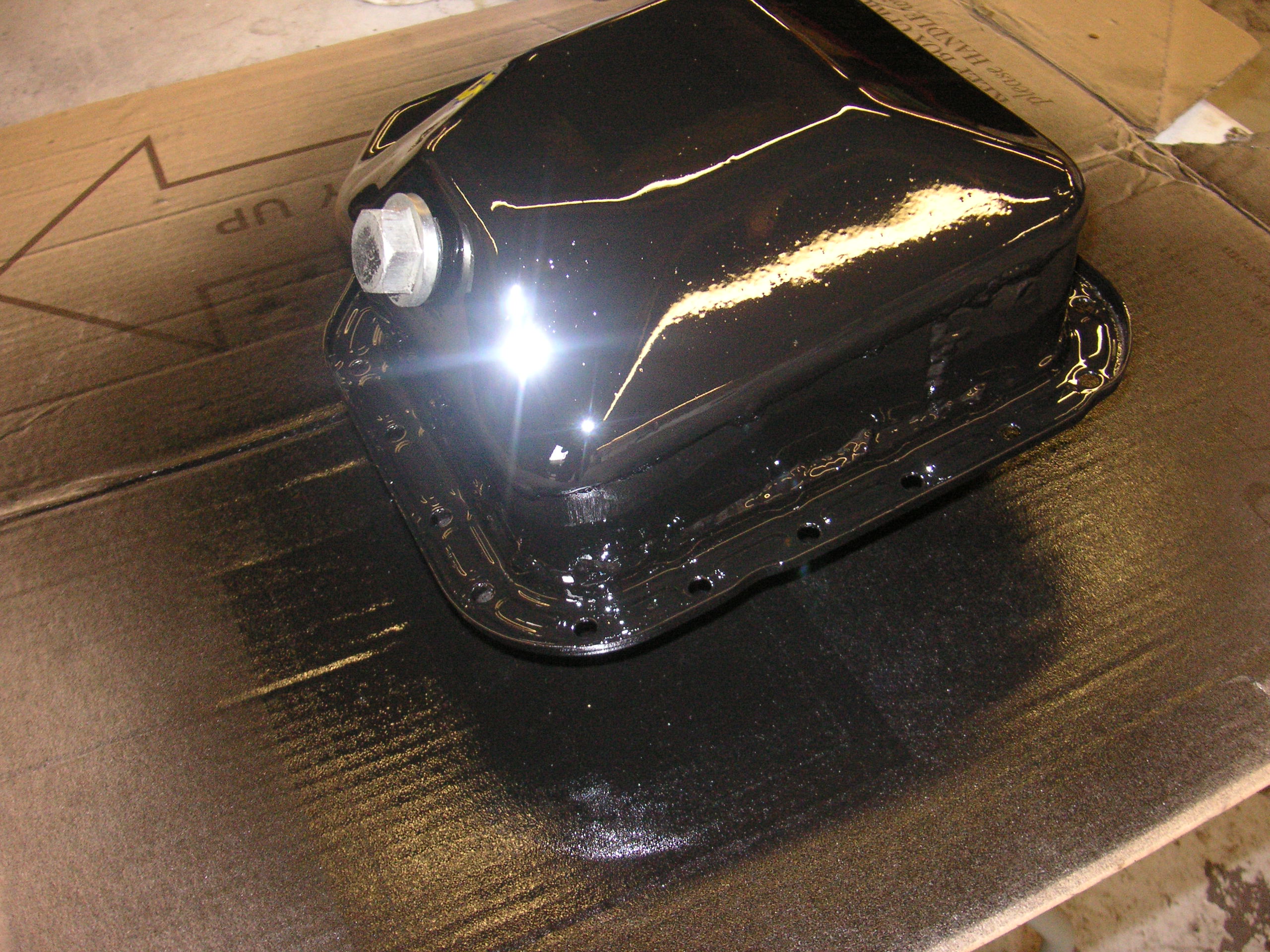

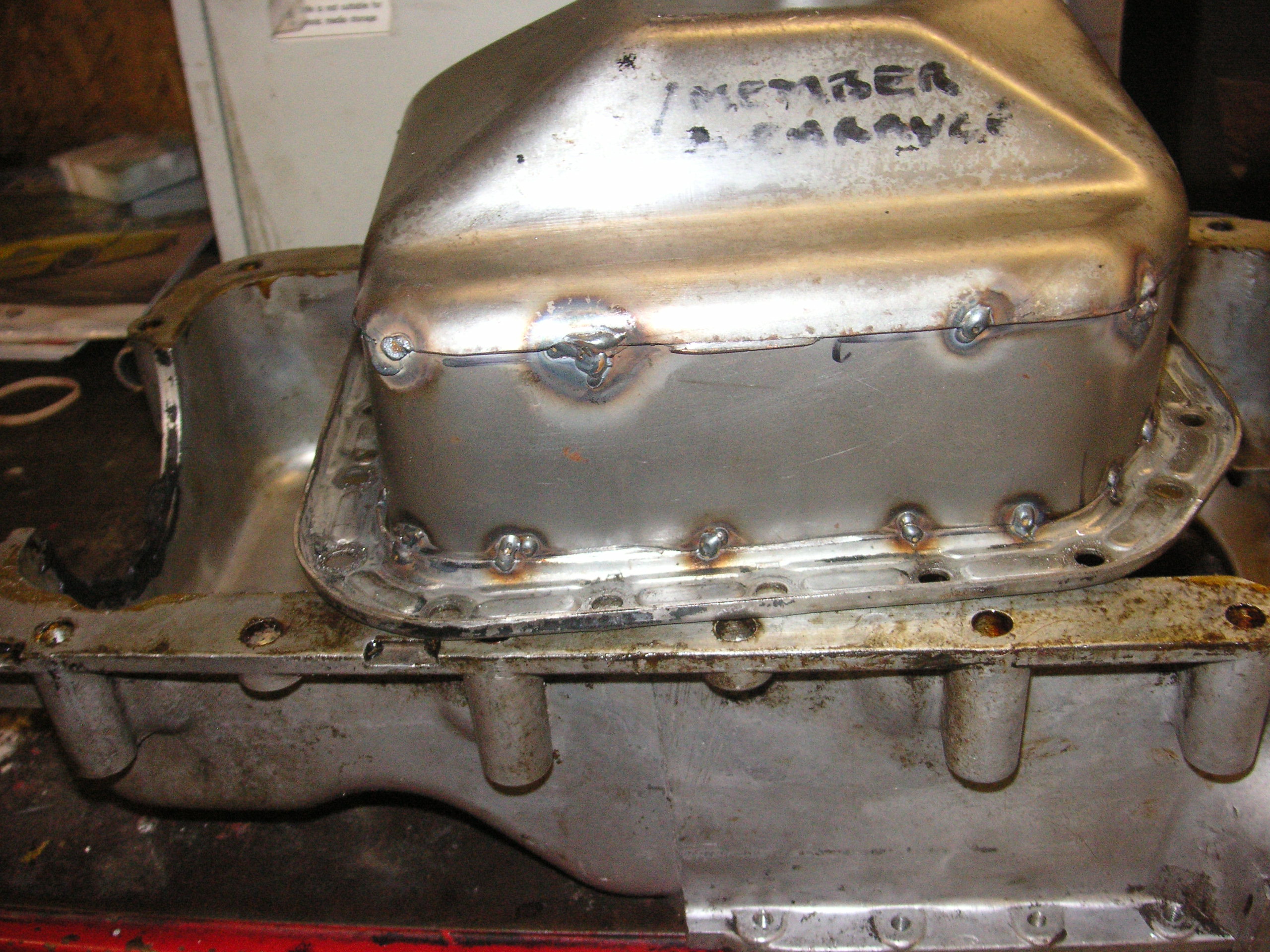

Whilst the block is at the machine shop, we've created our new 'deep' sump in order to counter the surge.
This has been an interesting exercise, also involving extending the pick up and accompanying shroud.
And finally giving the end product a coat of 'speed' paint.
Don't you just love the development process?

Hi Pom.
Have you gestimated how much extra oil is needed. :?: It looks like half a gallon. :lol:
Better more than not enough. :|
That gudgeon pin clip must have made a racket. I had a circlip on a rear axle short shaft let go once.
The noise it made would not have been the same as what your engine had produced.
You may have mentioned it before, but I'm going to ask. Did you get hold of another engine after the debacle with freight out of the USA. . :?:
Thu Sep 07, 2017 2:21 pm
Posts: 490
Dave, there's another 1.5 litres, so just over a third of a gallon......and the sound of me swearing drowned out the circlip noise!
