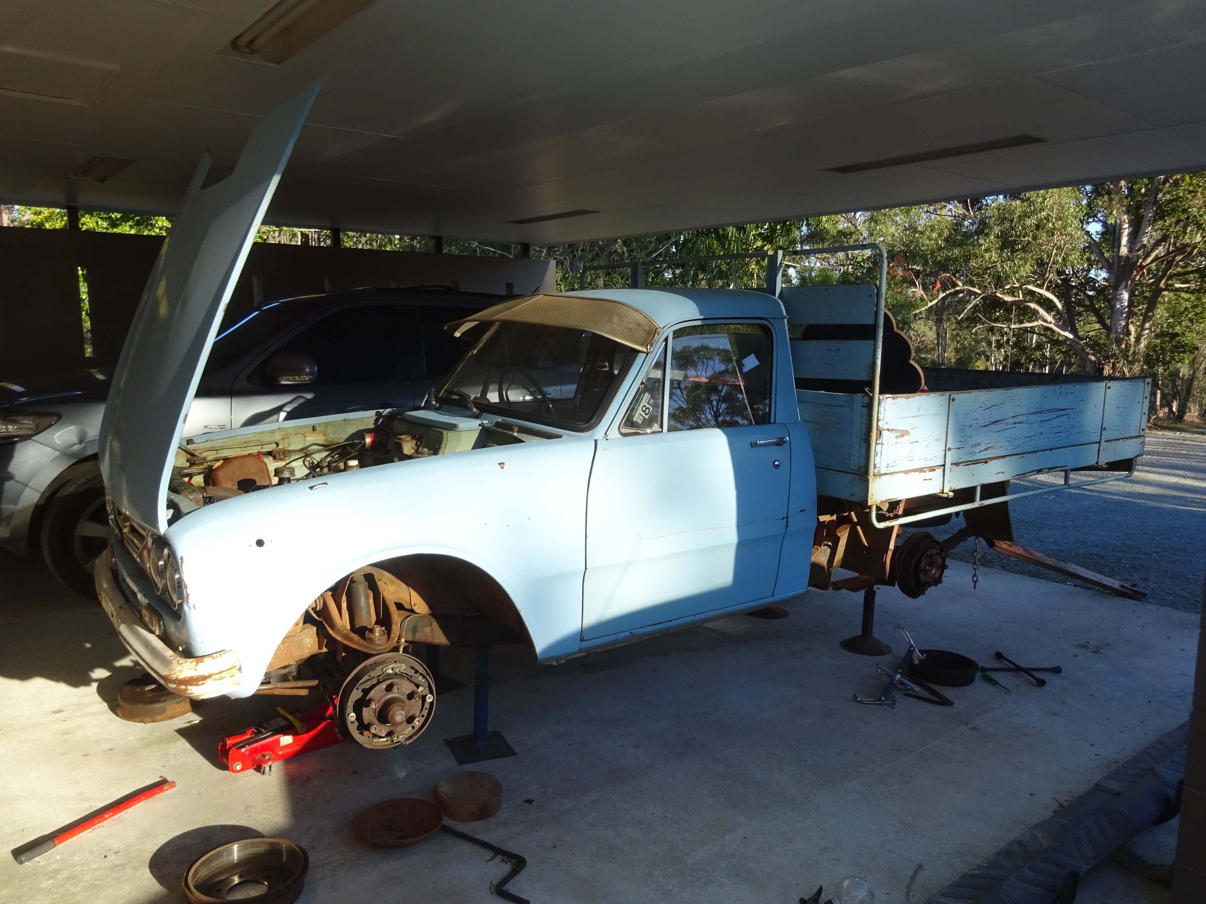

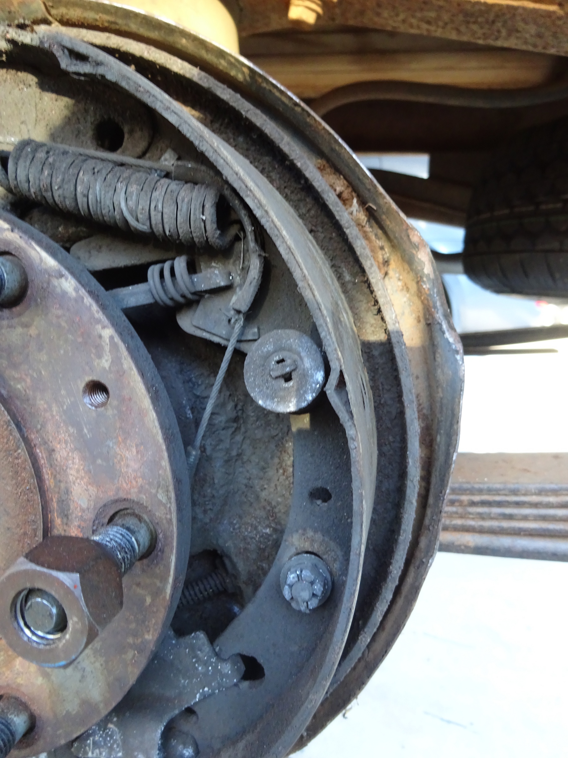

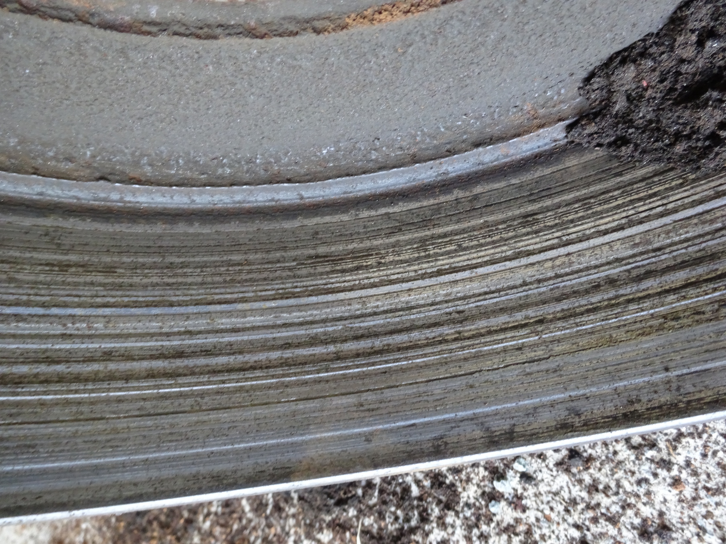

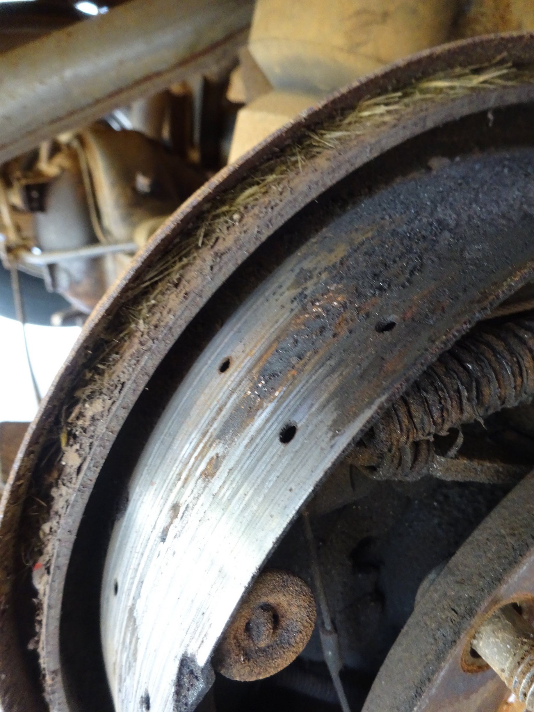

Been tackling the rear brakes today.
The rear RH side was pretty well seized up but with a bit of persuasion I got the drum loose enough to get to the adjuster cog so that I could wind back the shoes.
What I found once the drum was off wasn't pretty :oops:
I think it had been running metal on metal for quite some time as the steel body of the shoe itself is worn half way through and the drum has 2mm deep grooves across the whole face. So needless to say, the shoes and drum g straight to the pool room :lol:
Looks like new rear drums are on the shopping list

Ahh mate, that is extreme! :shock: How loud would the squealing have been?
So, do you have any spare drums or shoes?

After 3 1/2 hours of trying over 2 afternoons the rear LH drum still wouldn't budge, not even half a mm
Tried tapity tap tapping, soaking in WD40, heating with the bottle torch, tapping while prying with a screw driver, soaking with a white vinegar/WD40 mix, more heat and even some naughty words were tried but all to no evail :evil:
Time to improvise......
I made some custom arms for a gear puller that I've had sitting in my kit for years (used once for a 2min job) so that it would fit over the drum.
I had to bend the dust cover to get the jaws in (which I will straighten it up again after the brakes are sorted properly) then started winding in the pressure bolt.
It loaded up with a fair bit of pressure when I though....... better put the wheel nuts back on just incase this thing lets fly and takes my hand with it :|
I kept winding and winding, putting a hell of a lot of pressure on it and thinking, any moment know, when BOOM!!
Very happy to say I still have all my fingers, albeit with a couple of bruise knuckles and the drum was stopped by the wheel nuts (glad I had that thought cross my mind) but the puller and spanner landed six feet away in the yard.
Good news is....... the drum is finally off :D

Rear shoes weren't as bad as the other side but they were definitely on their last shreds too

Thanks for the pics. Centre of drum to axle face would have been the problem. Very little tolerance in that area.
Had a sedan rear with same problem. Not only damaged the backing plate. Had to use a large drift to get the drum to move. Hence a few small chips to the outer of the drum. :|
