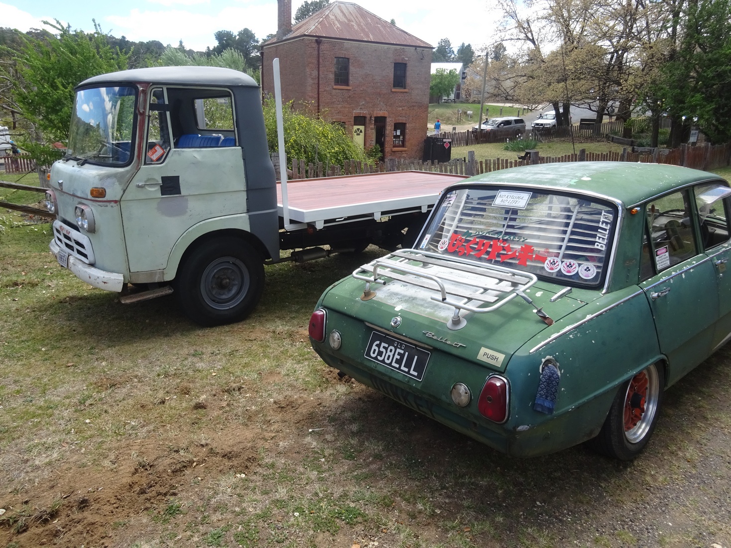

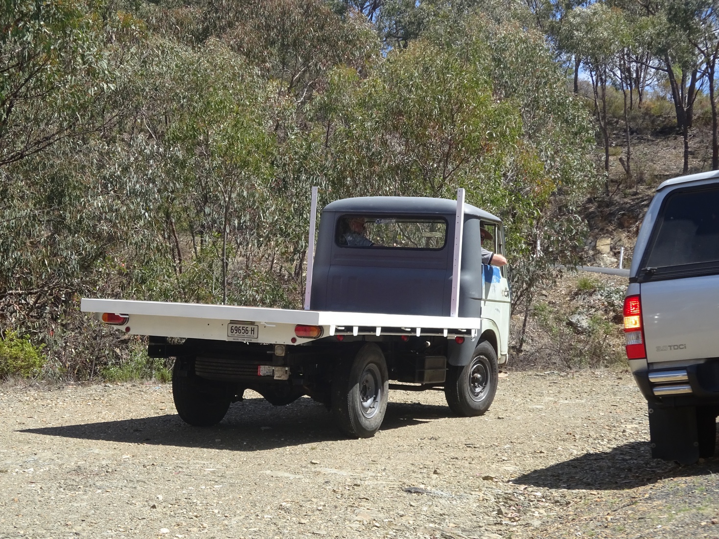

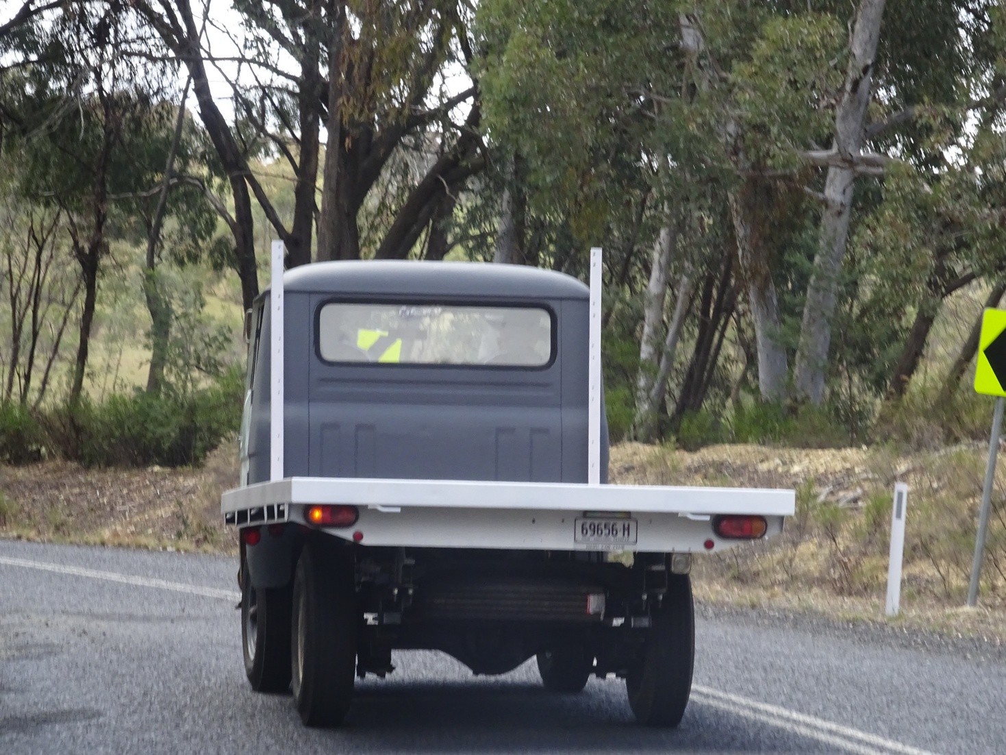

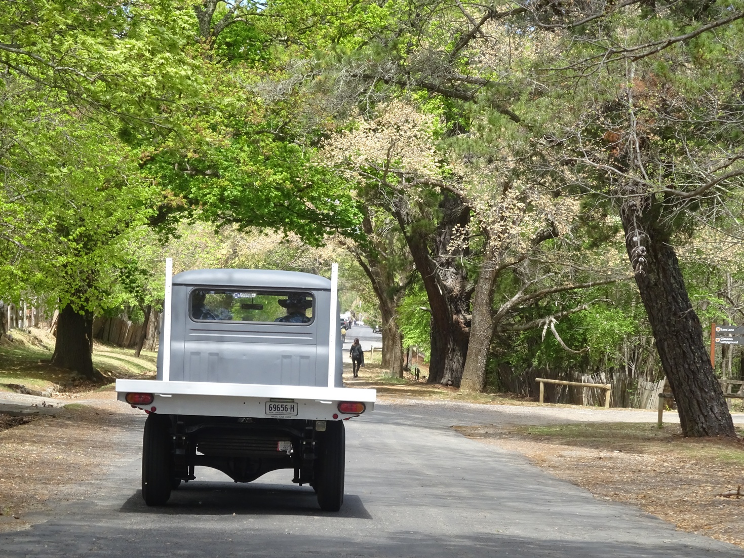

Stickman, that is a lot of pics of Dobby! Thanks for taking and posting them all. I have to say I like looking at him, and driving him. It would be nice though, if everyone else on the road liked driving at 80 km/h, because thats his comfort speed. Over that things get a bit loud and a bit bouncy.
My next tasks with him are to make the exhaust quieter and get some padding in the cab.
Highlights of the weekend include seeing Dennis sit in him, 48 years on from the last time I saw him in his one, and seeing you in there too. You just look right.
Fun weekend! Matt.
PM me a postal address Matty and I'll send you full size copies on a USB (I have more pics than that of Dobby ) inc a couple that Peggy sent me of Donkey and Dobby driving together too
