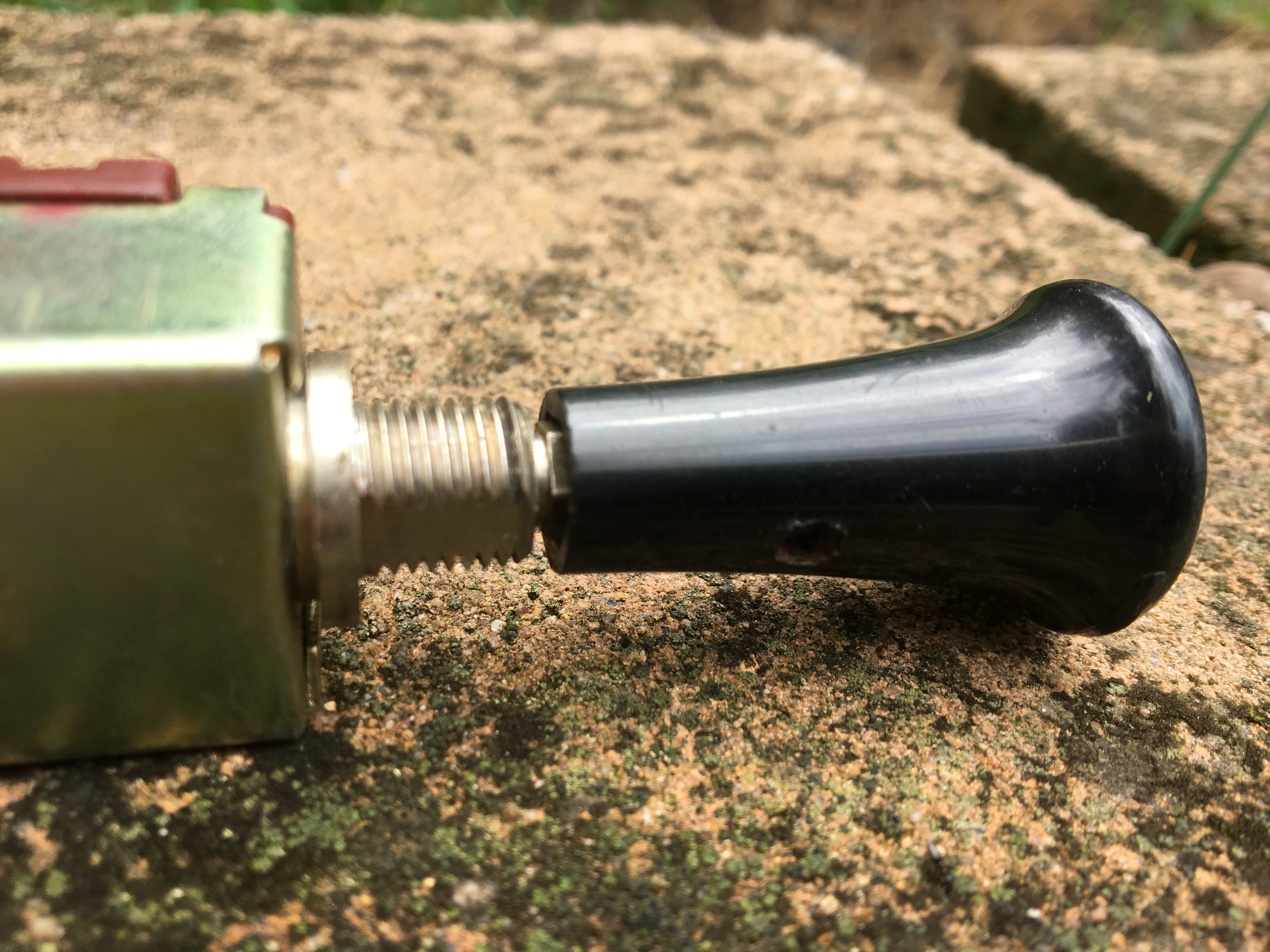

Every time I visit the garage, I seem to find another problem or some. Today I discovered, that one connector on the light switch is broken. That caused the heating.
How to remove the light switch plastic knob? There seems to be some kind of a brad in the knob, but I couldn't figure out, how to remove it.

Re: My 1966 Bellett 1500 sedan
push the little button on the side under the front of the switch I will take a photo tomorrow for you all is good ..cheers dave
Hi Bellett EST
On the bottom of the switch knob there is a small pin that holds it on. Just press a fine tool ( screwdriver or drift etc ) into the hole and gently pull the switch knob out. Unscrew the chrome ring and the switch will pull through the dashboard toward the front.
Hope this is a little more helpful.

The push in clip is the same on the wiper switch. A nail or sharp object. Pushed in and wiggleda bit then as abivescew it out cheersdave

as warren said push into that hole and pull off the plastic piece with L see how you go on it

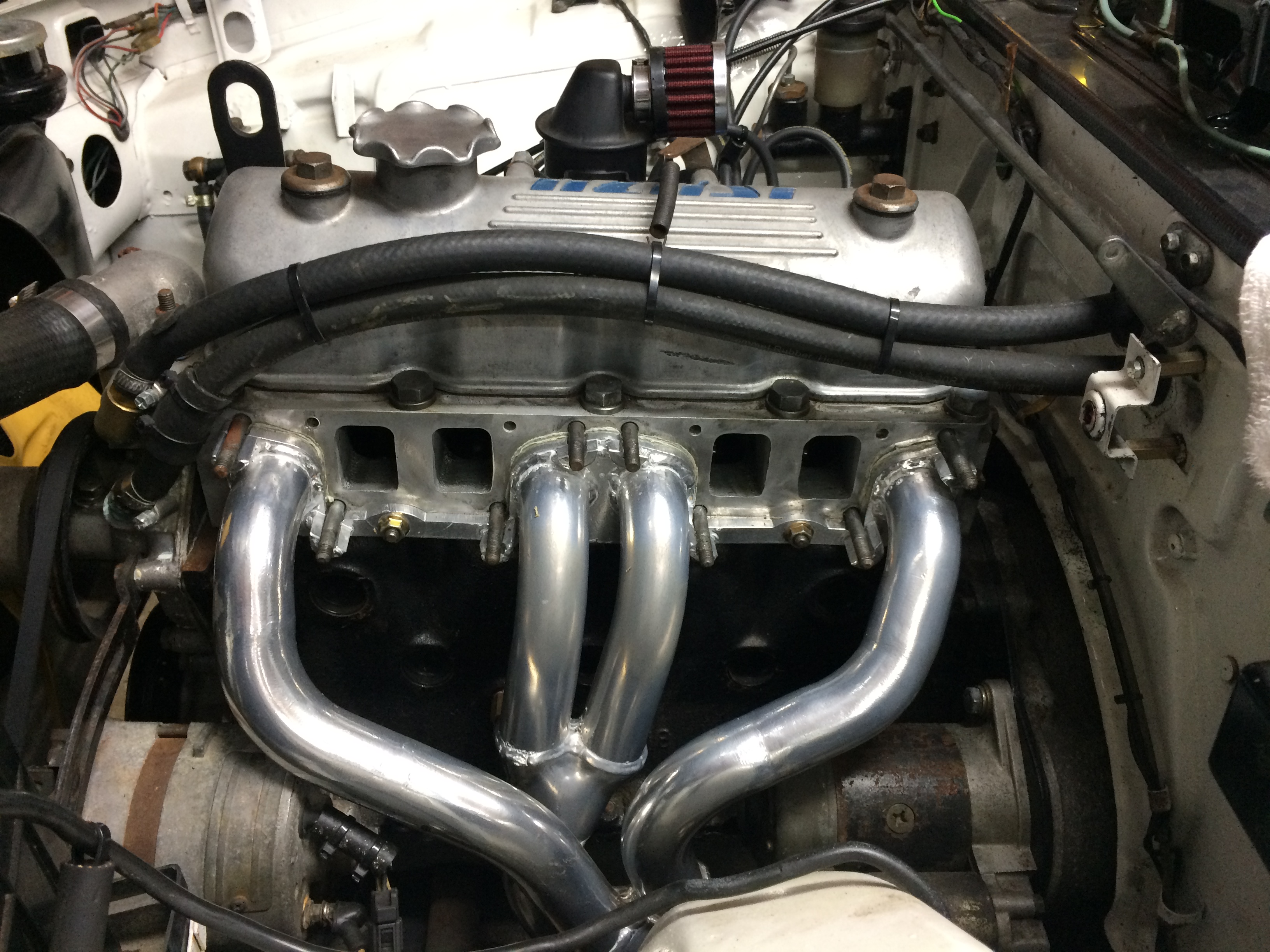

Another question about the cabin heater. Could someone explain the lever positions, the labels on my car are in such a bad condition. The right one moves the air flow (floor or window), the left one should be for temperature adjustment I suppose.
The water from the pump goes up towards cabin heater, but the pipes behind the heater unit are bit blocked. I'll try to set them better, hopefully it will bring some heat to the cabin.
Hi from Tasmania
Well we are the coldest state here in Tassie though nothing like you so I run a constant flow through my heater
As you can see in the photo with carbies removed
Top hose return to thermostat housing on head
Low hose feed to heater from water pump
Traditional there is a manual turn brass valve at the head
Some remove and retro-fit an inline valve either manual or cable operated
Regarding levers I just move till I get what's needed where needed
