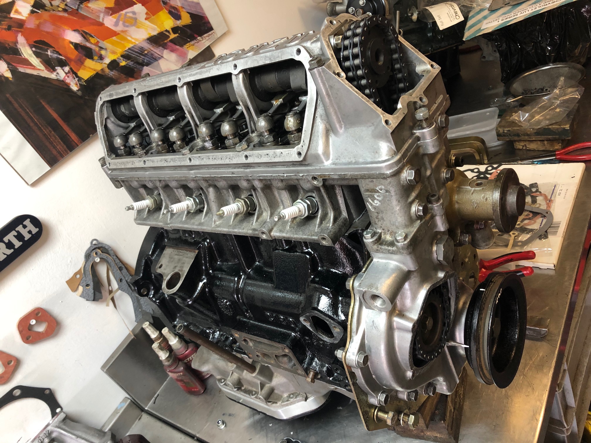

Nearly there....we found a cam company who are prepared to push the cam re-grind a bit further, and the work is finished on the 1600 head we intend to use, this should give us more compression than the 1800 head was offering us.
In the picture you can see our funky new sump extender/insert..

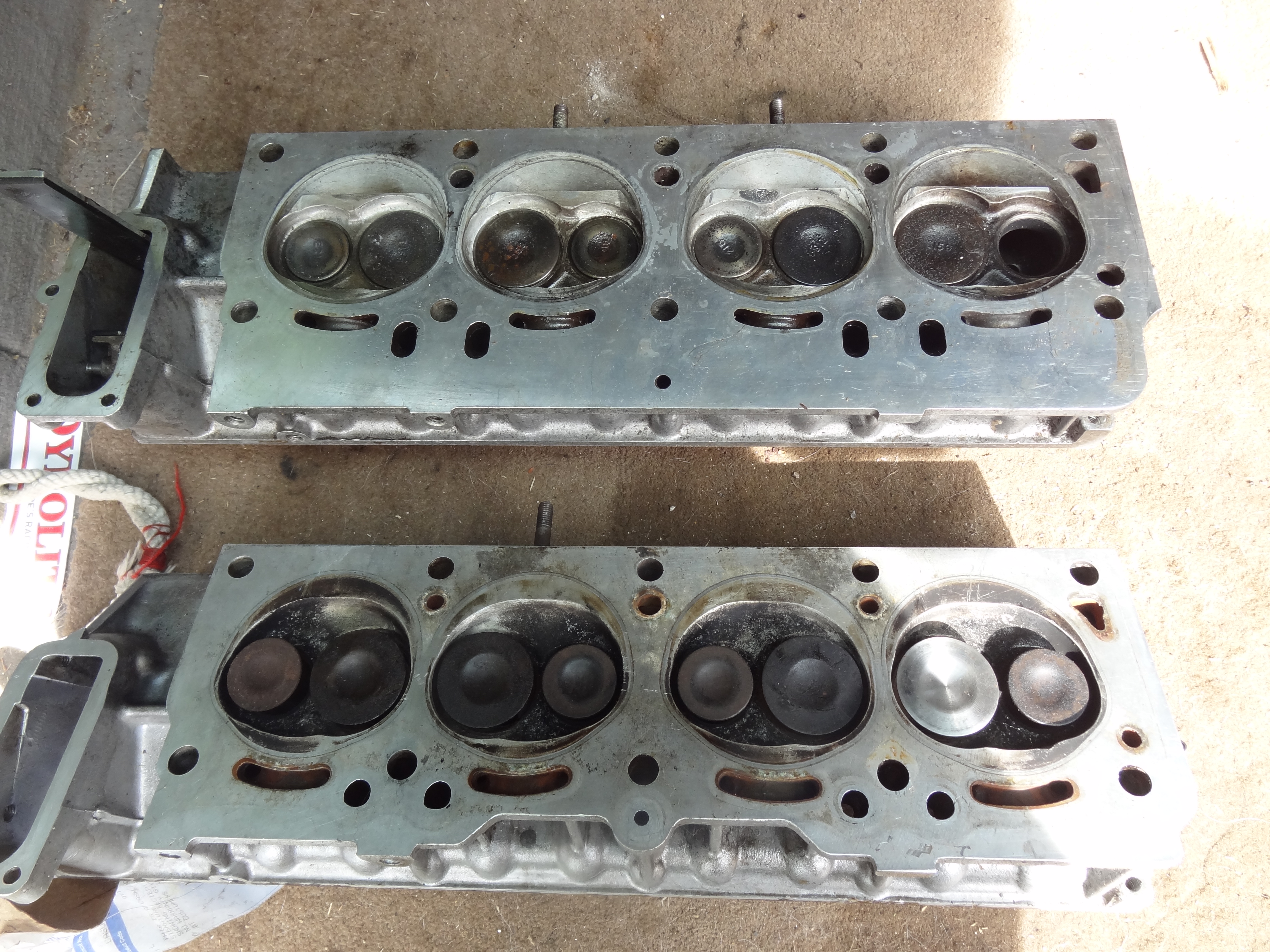

Well, the 1600 head has gone onto the 1800 block..and our Frankenstein engine is taking shape. The theory behind this strange hybrid, is that the smaller combustion chamber of the 1600 will give us more of our much sought after compression. Top is 1600 above the 1800.
We calculate we'll get somewhere around 10.5 - 10.6 : 1

The weird looking overhang under the plugs is the wider part of the 1600 head that covered over the blanked off pushrod galleries in the 1600 block.
Not pretty, but this isn't a beauty pageant is it?

The 1600 head looks like a better shape than the salad bowl 1800
Is it an optical illusion or are the 1800 valves bigger?

Posts: 490
From memory the 1800's valves are marginally bigger....but rather annoyingly they are also a couple mm longer.

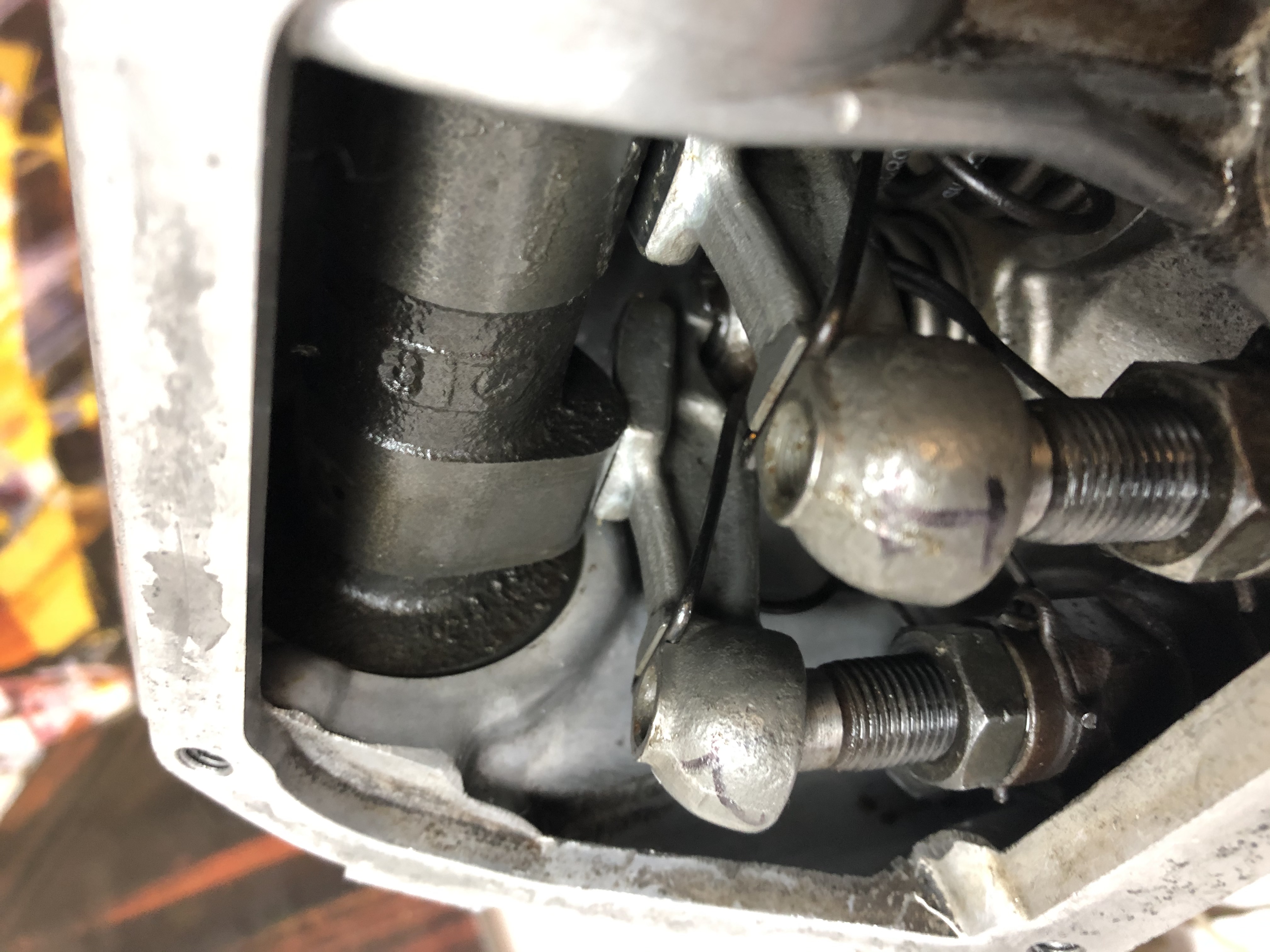

The new cam, with its higher lift, is now attacking the rockers all wrong.
To correct this longer valve stems would do it....or easier thicker lash caps....here's some we made earlier!

This will allow us to wind the pivot screw in a few mm and pull the follower back toward the middle of the pad on the cam.
