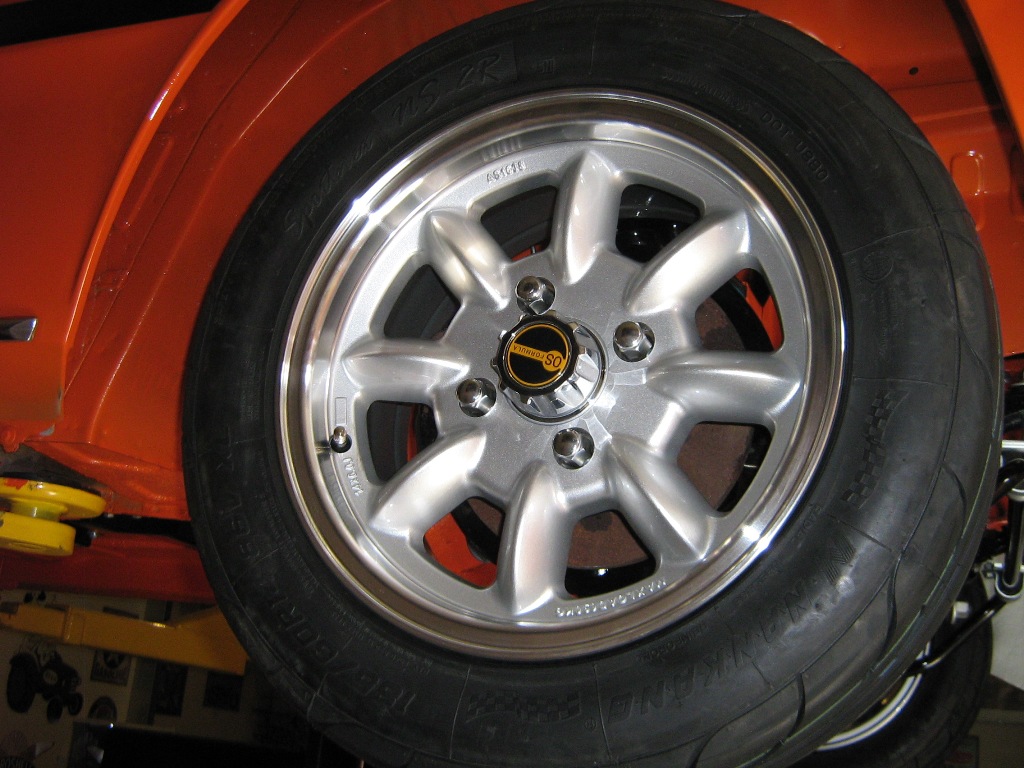

Yes Glen, wheels are 14 x 6 Superlites with a 26P offset. Got them from Chris Neale in Queensland, he had sets available and machined them to my requirements. Craig gave me the off set.
They are now fitted with Nankang 185x60R14 tyres but they took a while to come it. Have attached picture of the tyre on the wheeland you can see it fits the rim nicely.

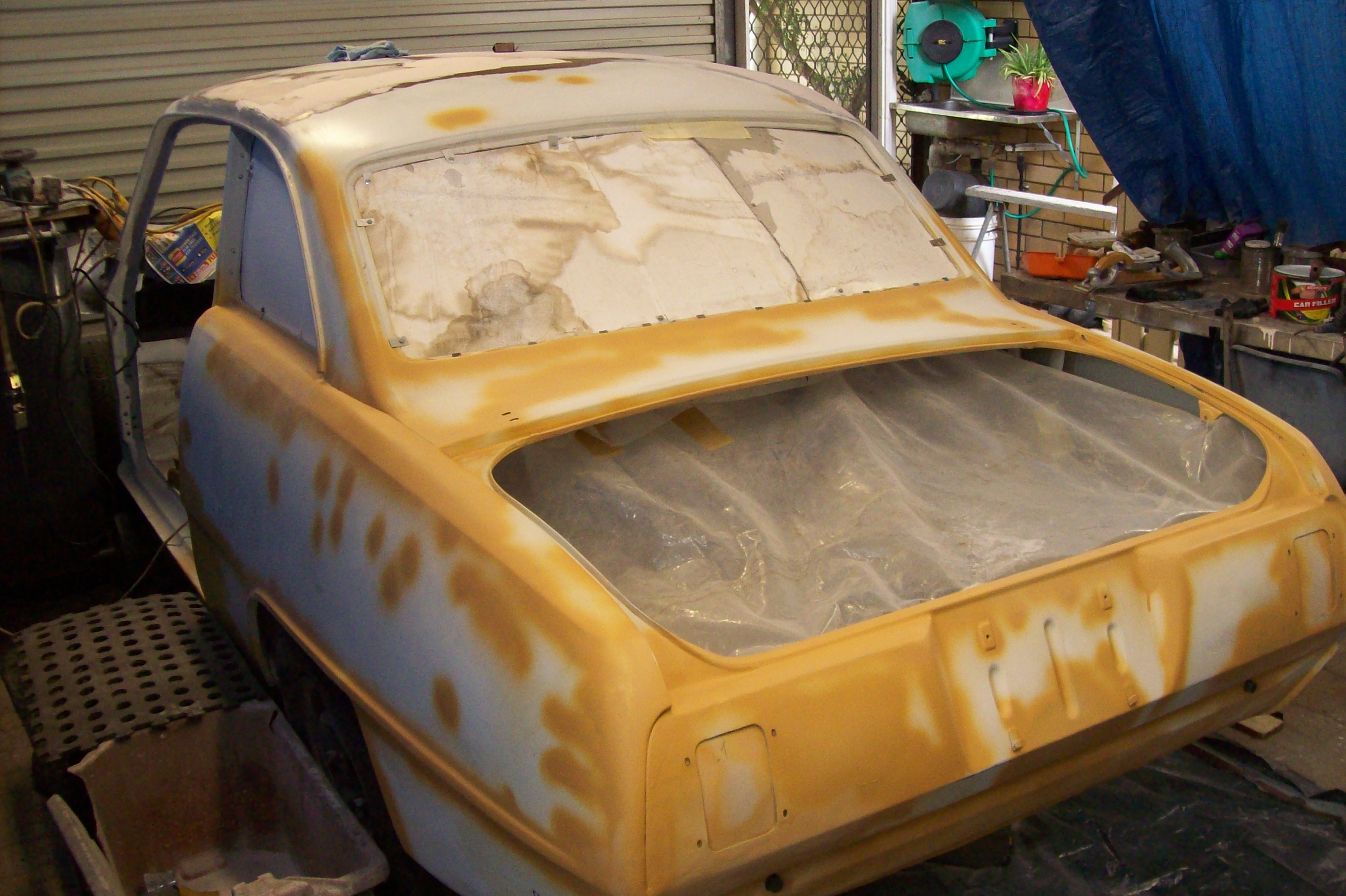

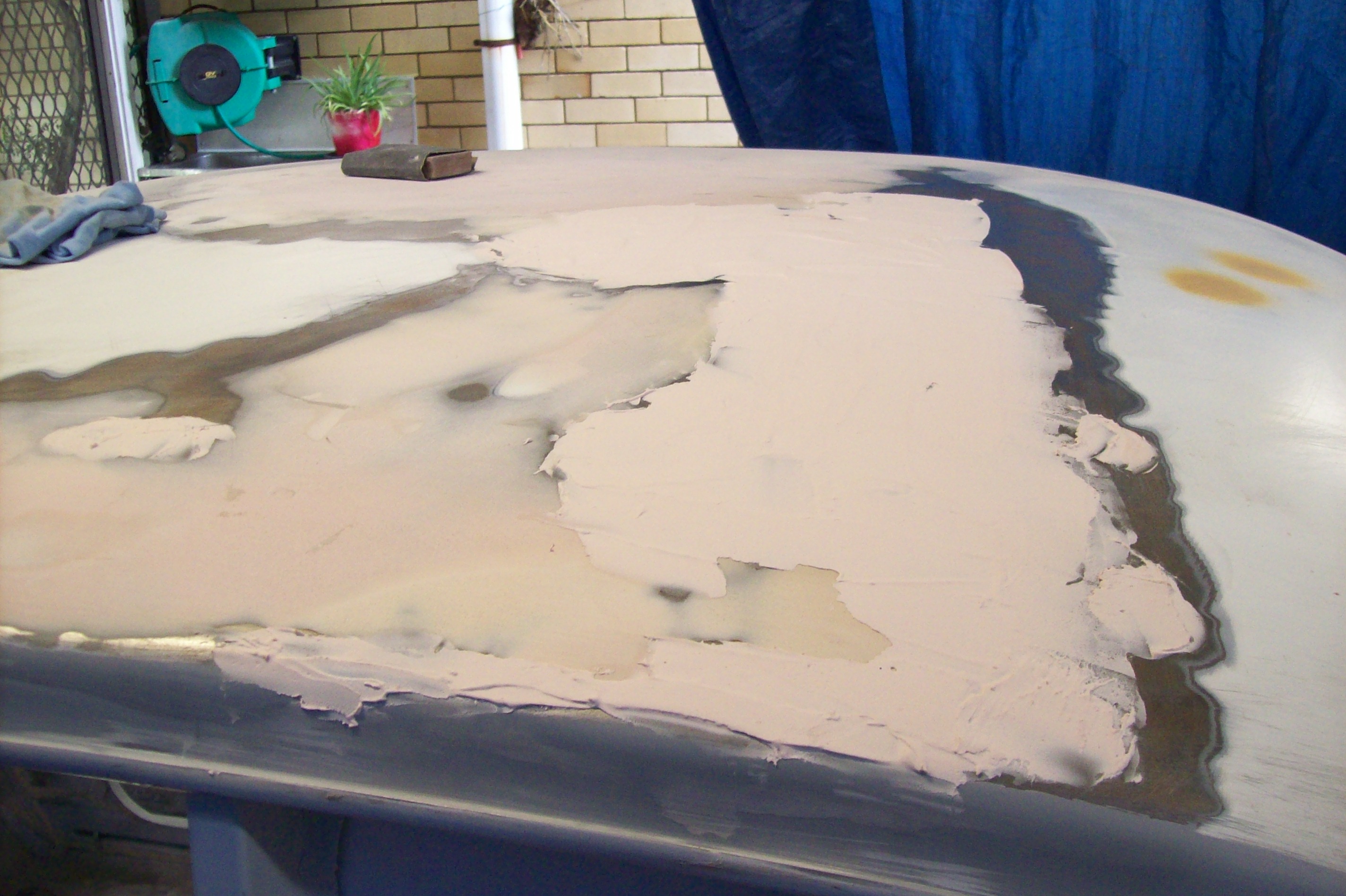

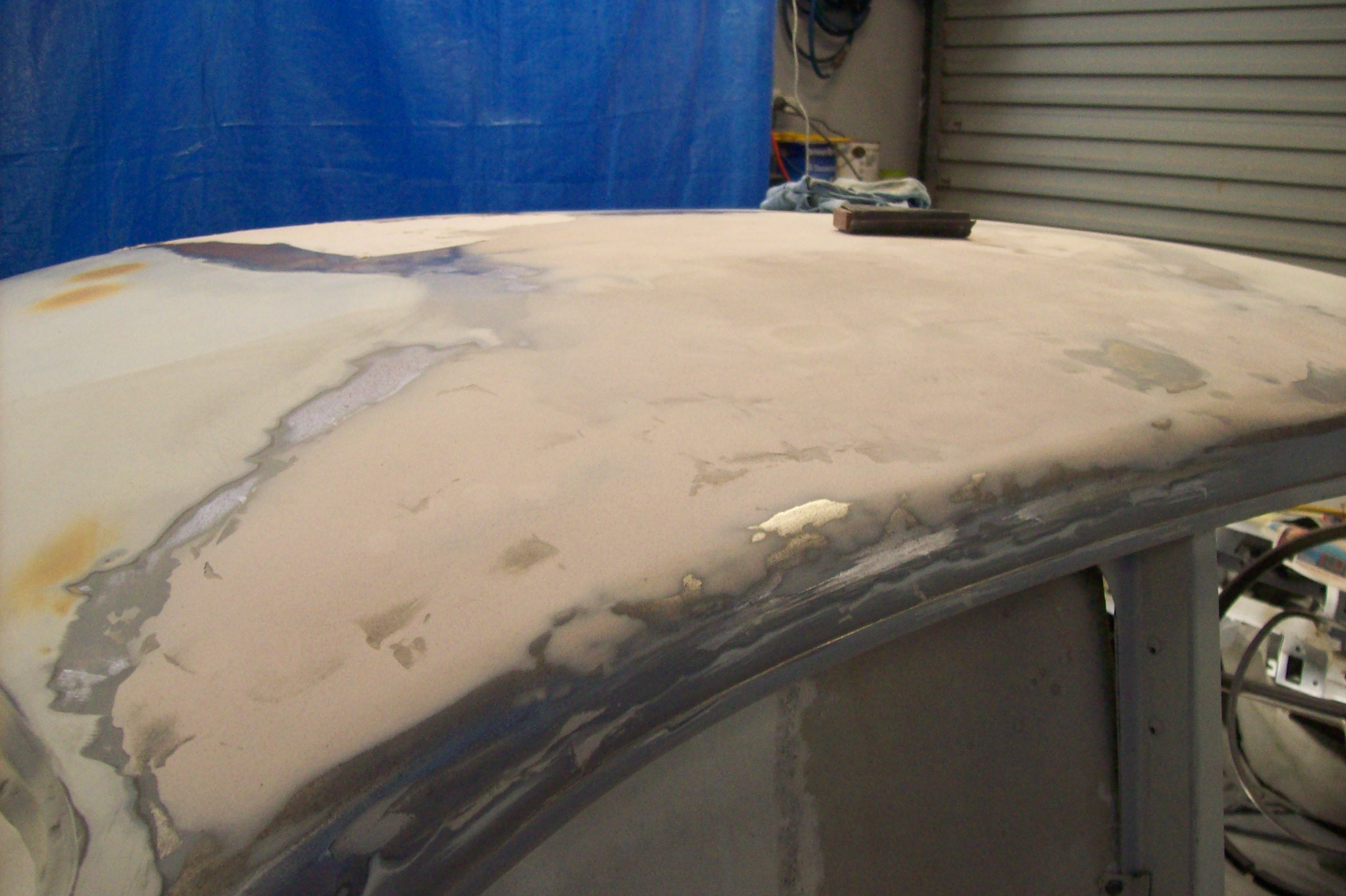

Thanks for the pics Peter. Good to follow a resto.
Your paint work has given me inspiration in what I should do for my resto.
Will make a final decision on the side stripes when the time comes.
Most of my time has been knocking 2 big dents out of the roof.
Has been too cold to paint at the moment.
