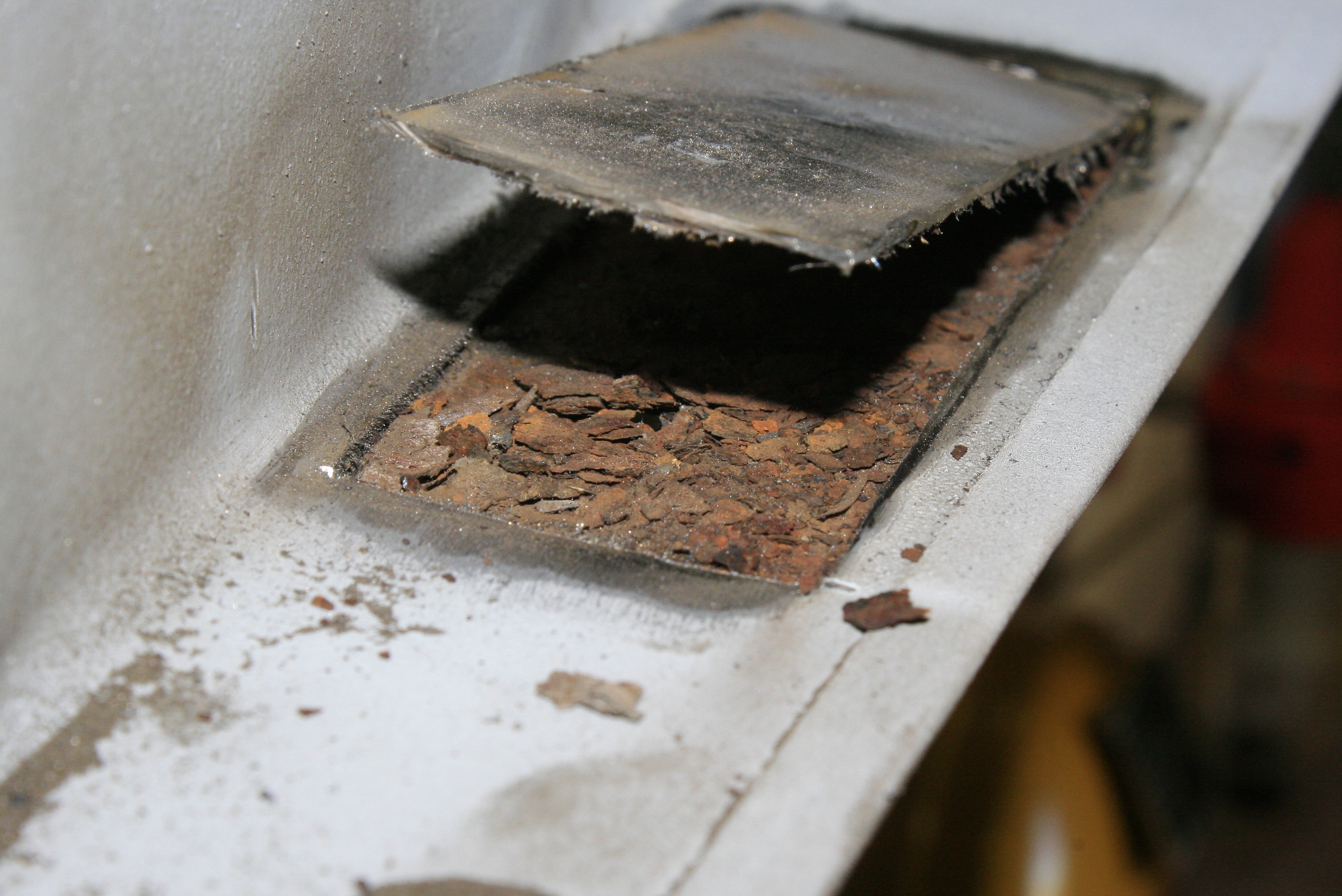

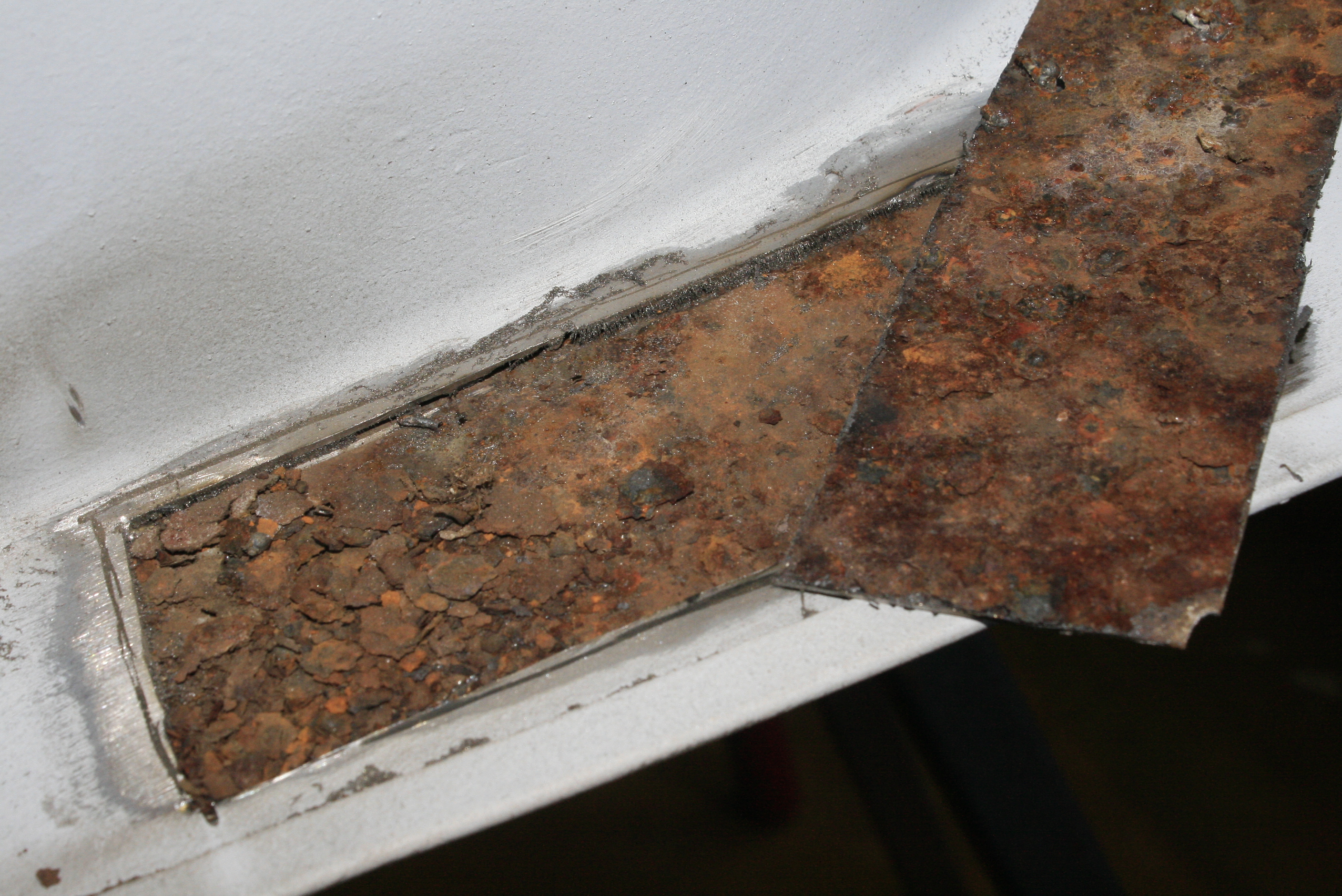

Posts: 368
...Once Cut & Pried Apart I Was Able To See Why The Bulge Was There, Plenty Of Rust Within As I Expected...

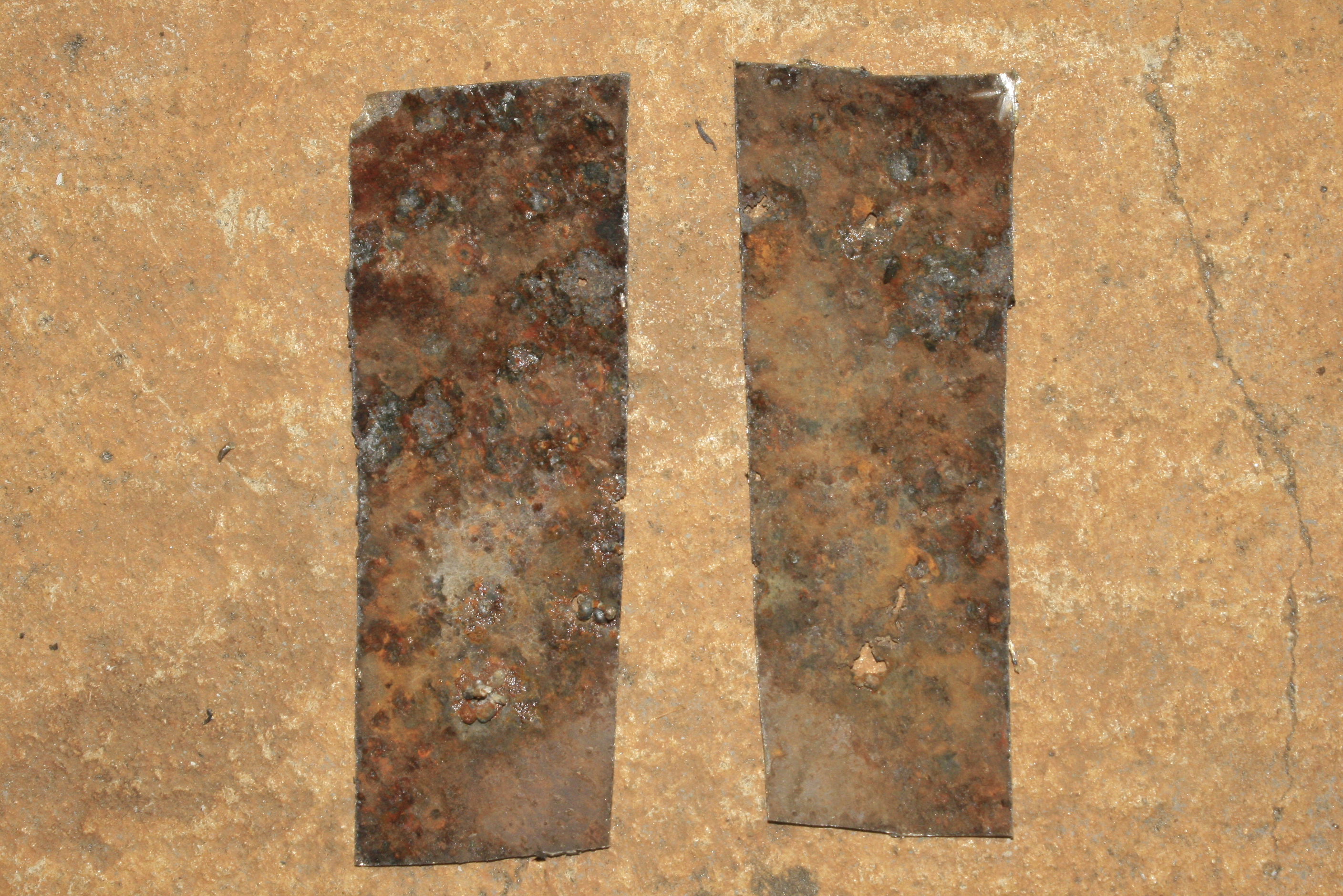

Posts: 368
.....After I Cleaned Out All The Rust Shards I Was Then Able To See Just How Bad The Surface Rust Was On The Inner Faces & Made The Choice To Continue Cutting My Way Through To Continue On With My Original Plan Of Replacing Both Sections.....

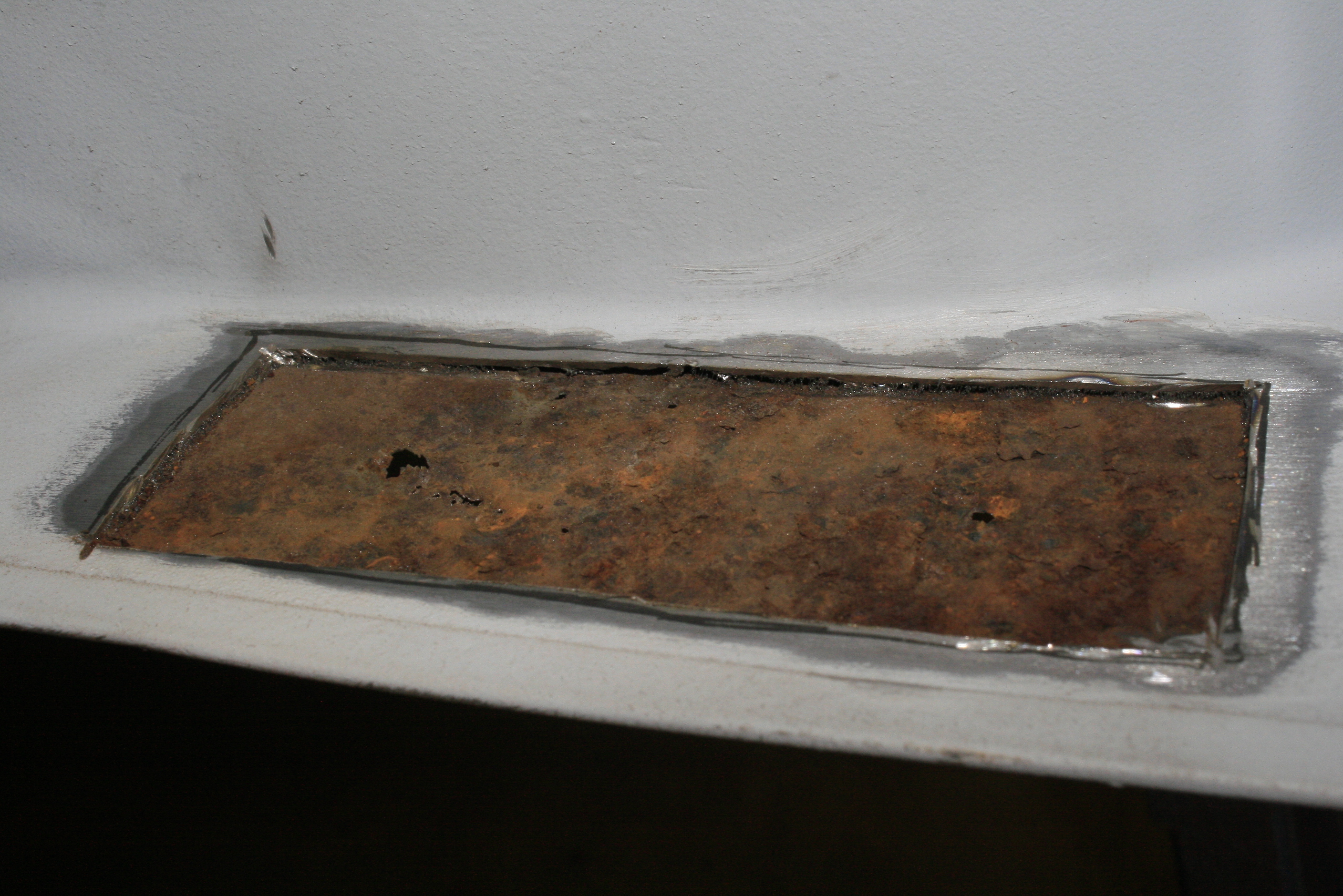

..........& Now A Closer Look At The Unexposed Sides.(Scary)..........
Ted Freeman

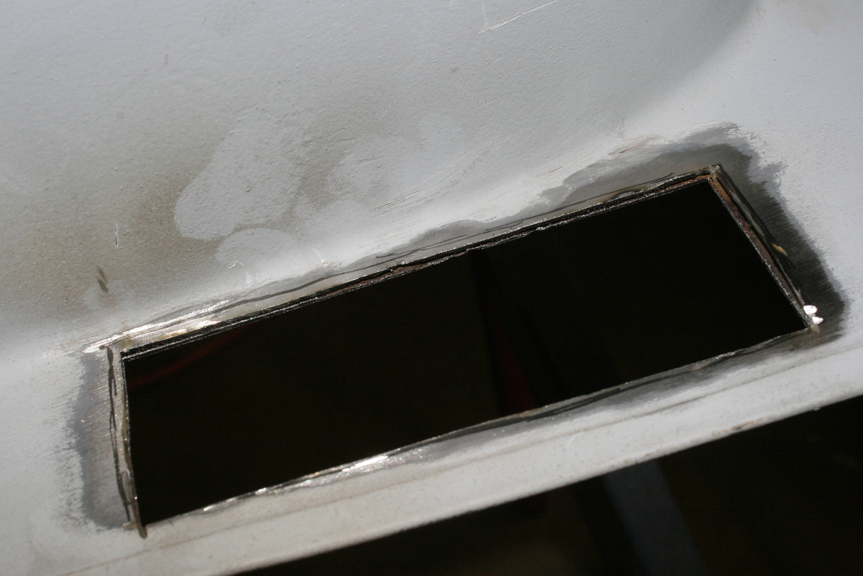

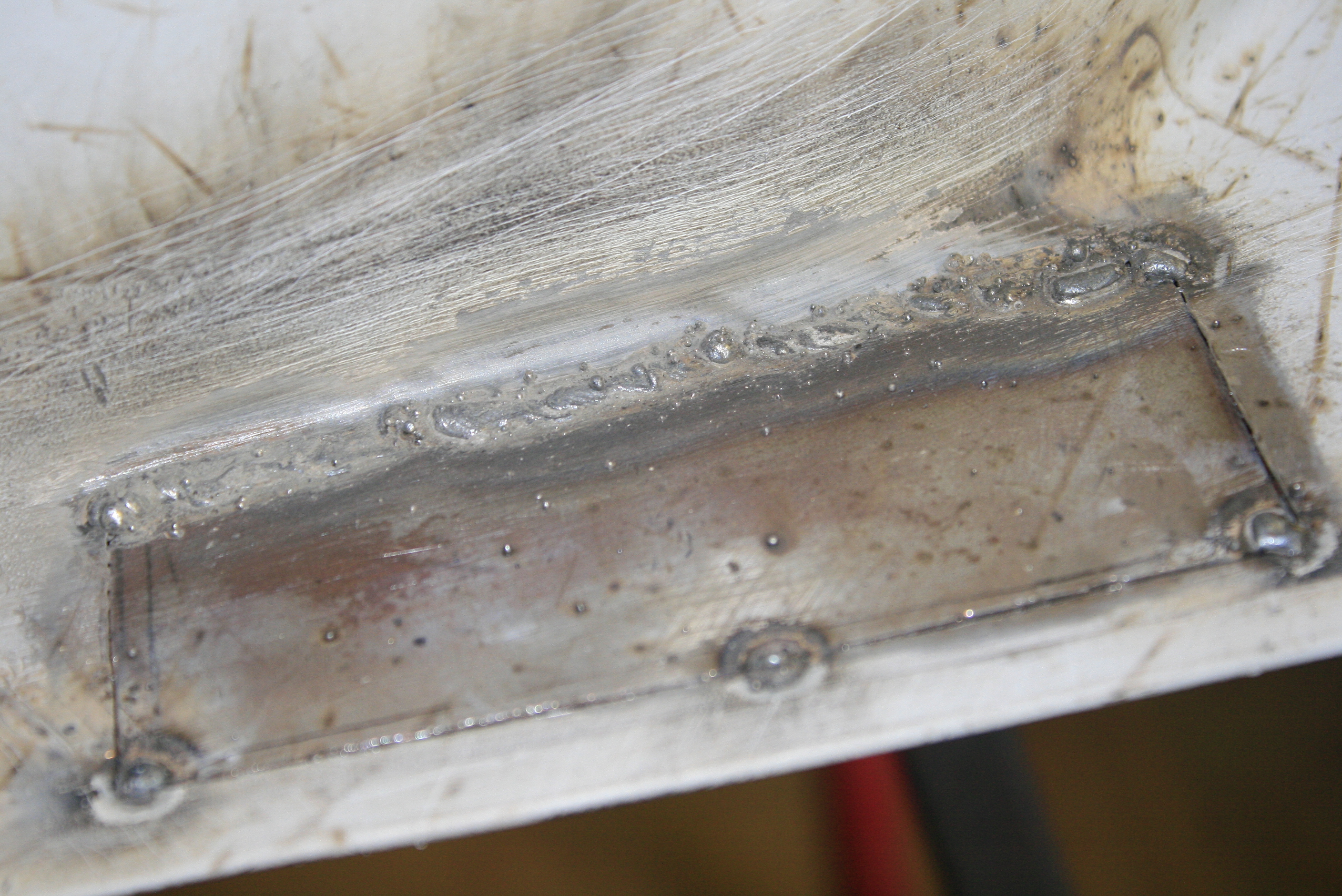

Posts: 368

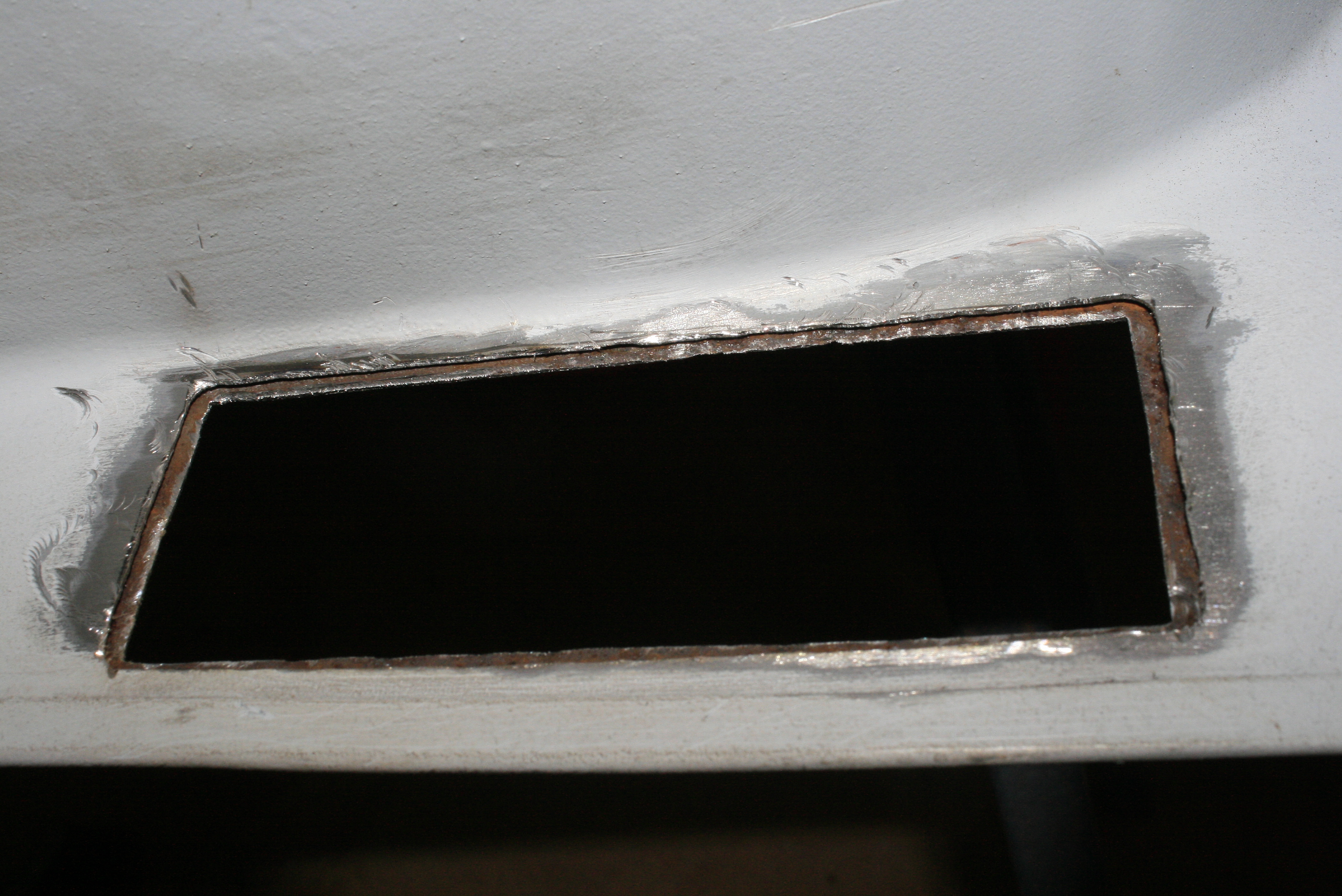

..Dad Suggested To Grind The Inner Sheet In A-Bit So To Create A Step All Way Round Which Will Help Absorb The Heat When Welding & It Works To, It Greatly Lessened The Chance Of A Blow-Through When Welding (Thanks Dad)..

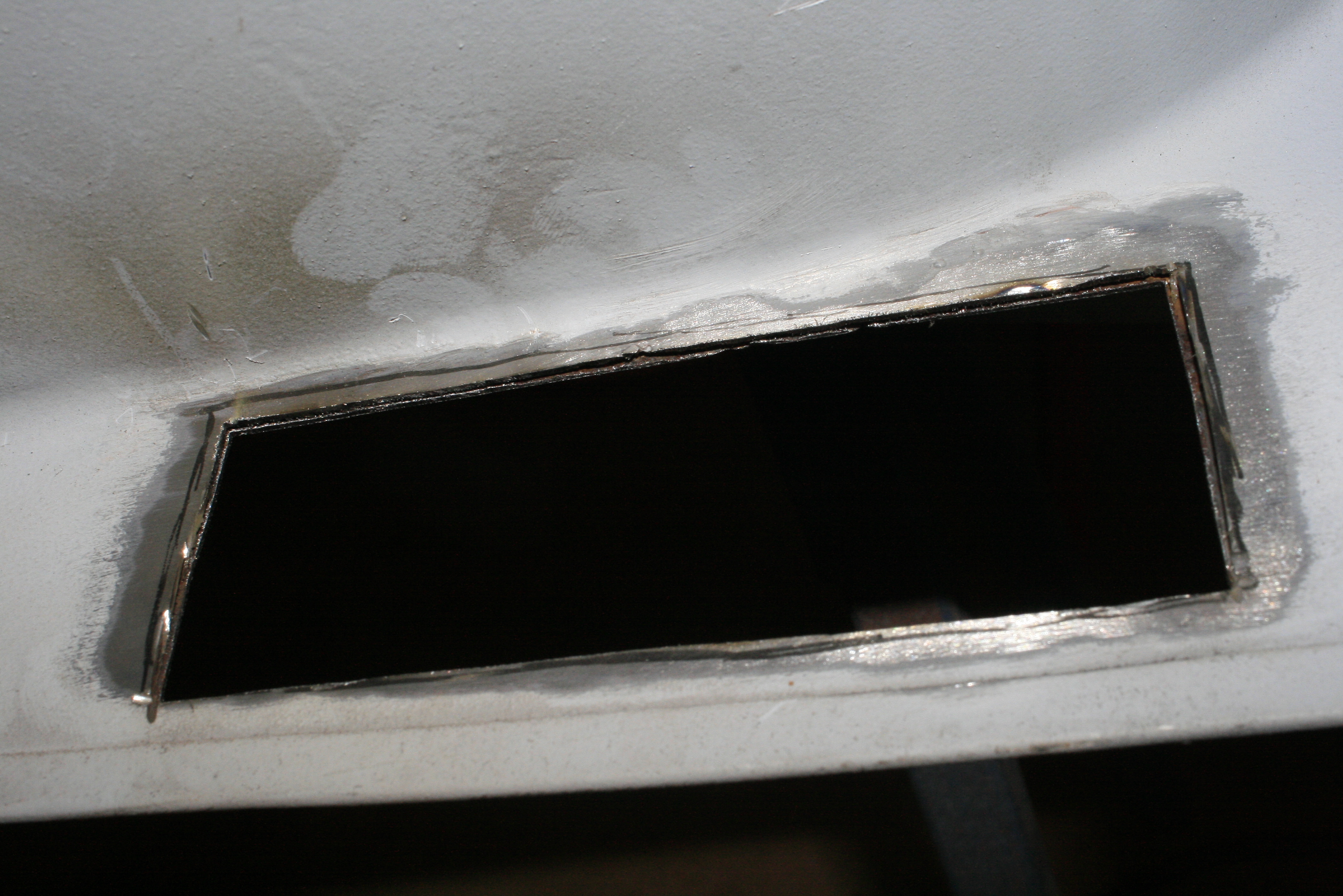

Posts: 368

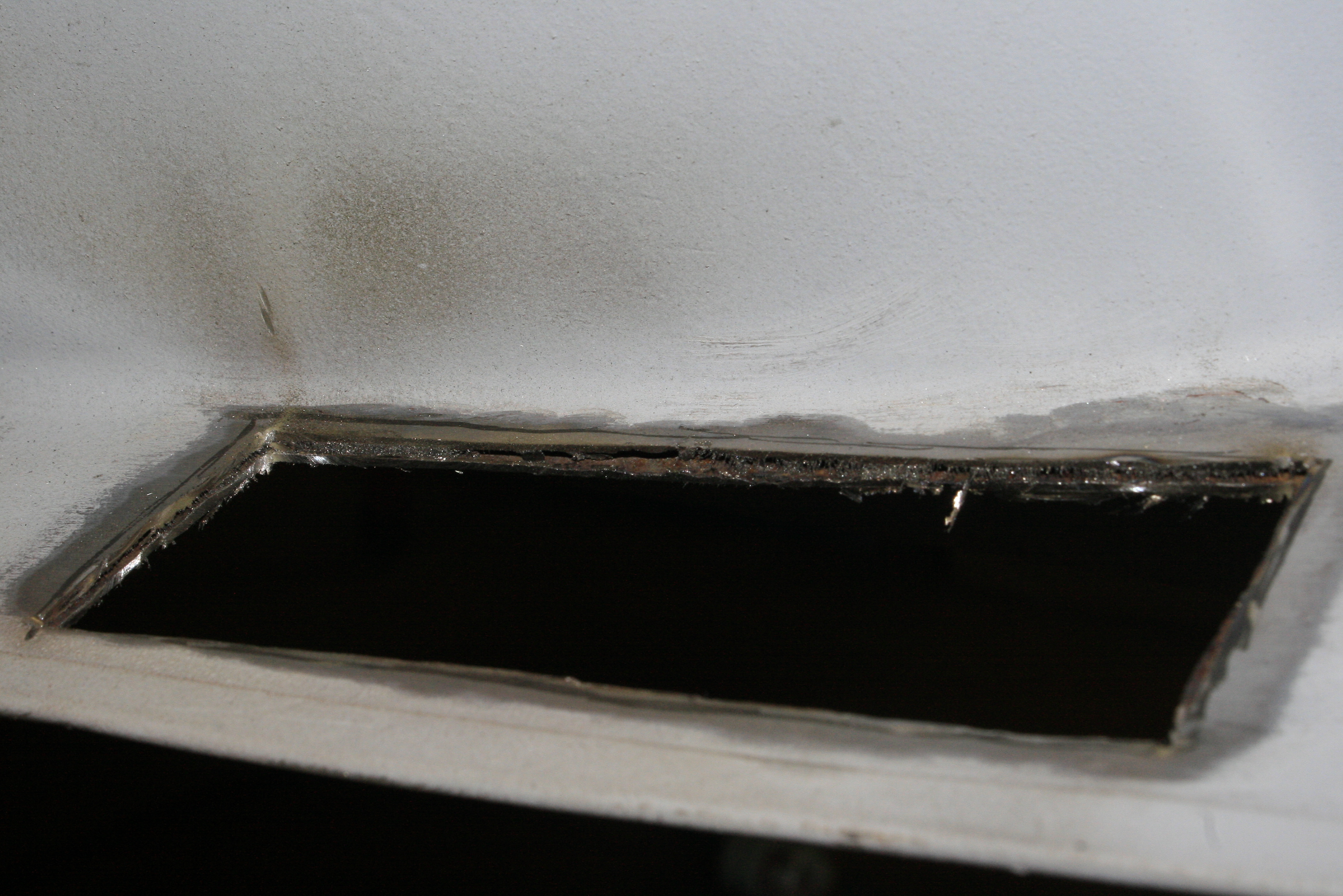

...A Few Dummy Fits & Fine Tuning Before Welding, It's Easy To Get Ahead Of Oneself Sorry...

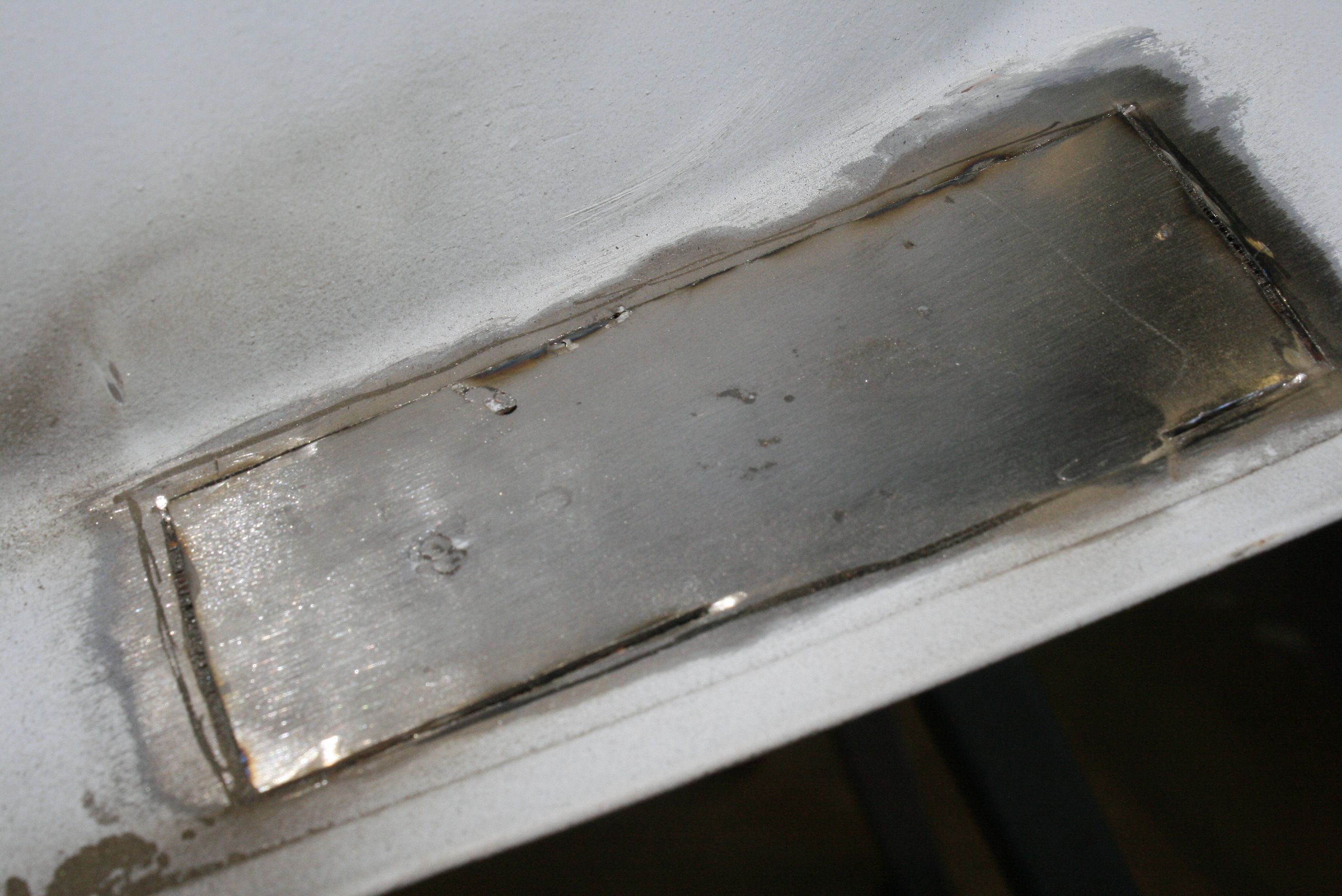

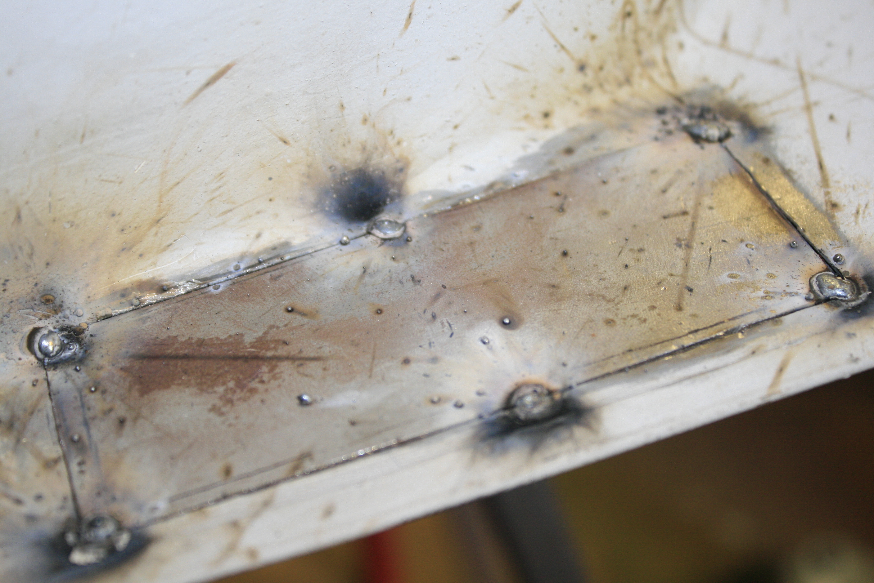

Posts: 368

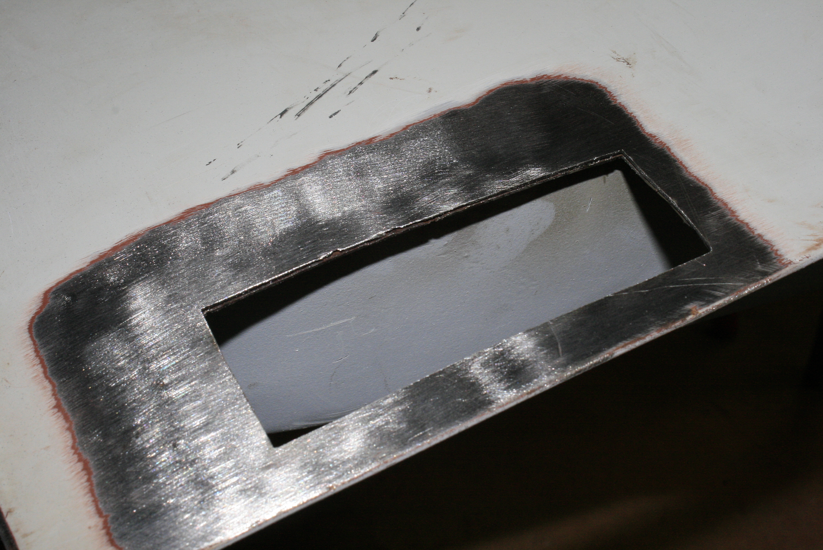

....I Hit It With A Few Spot-Welds So It Won't Distort When Welding It In....

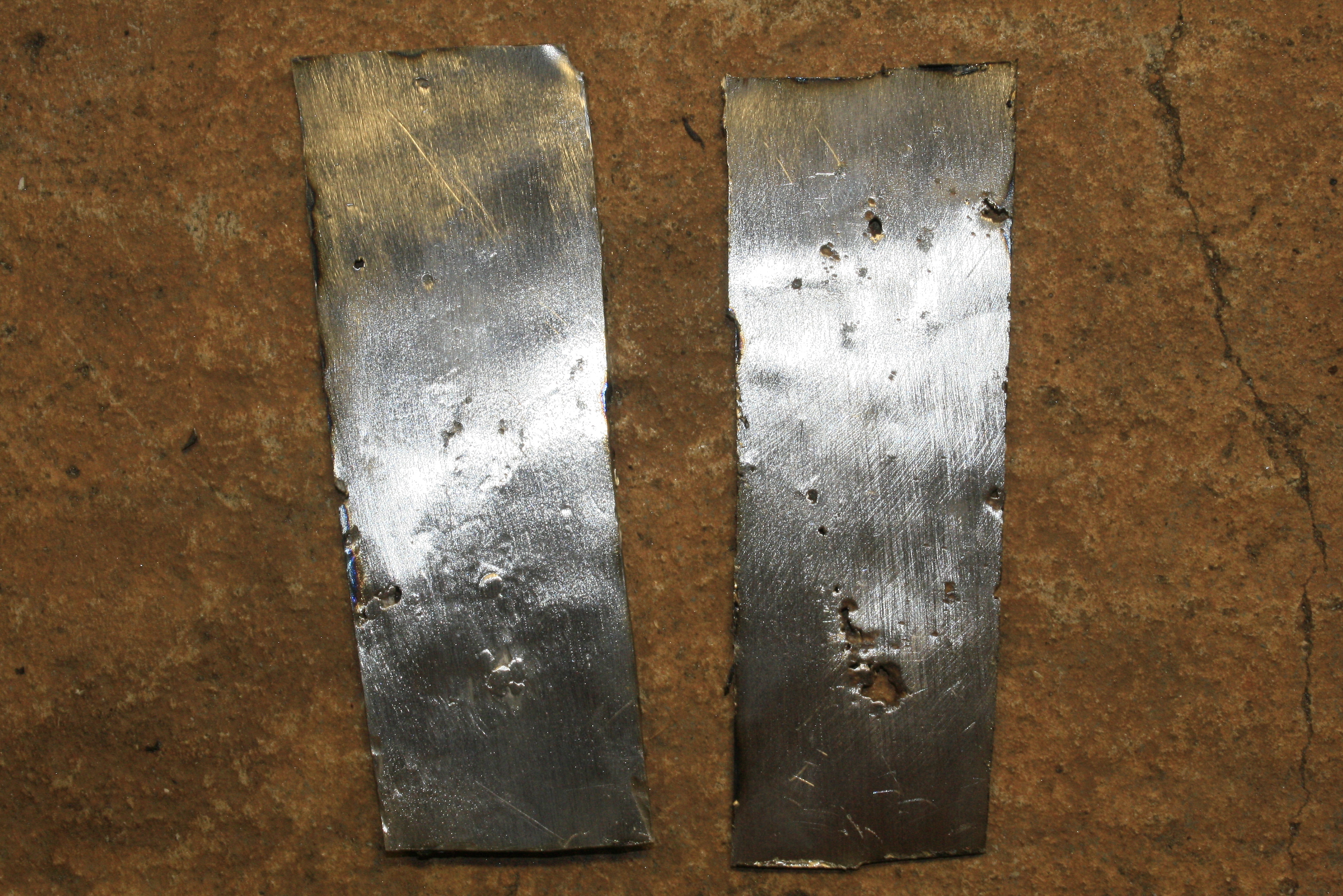

.....& Away I Went!

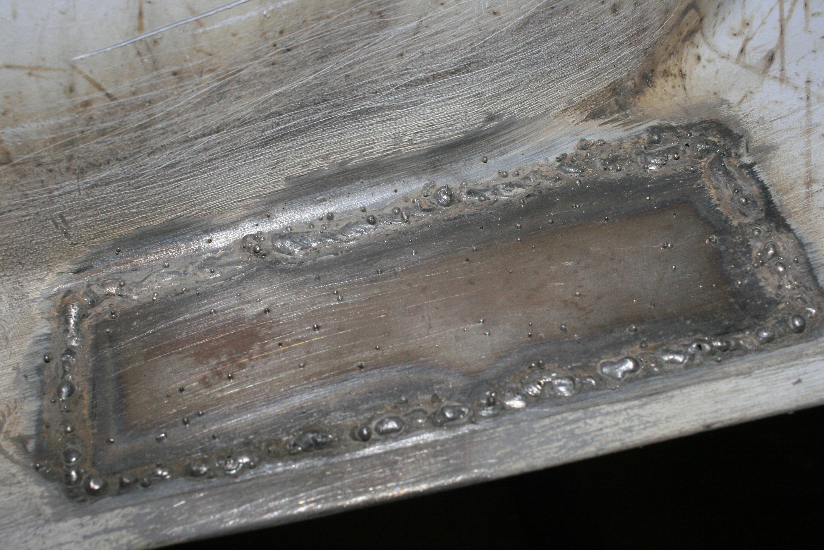

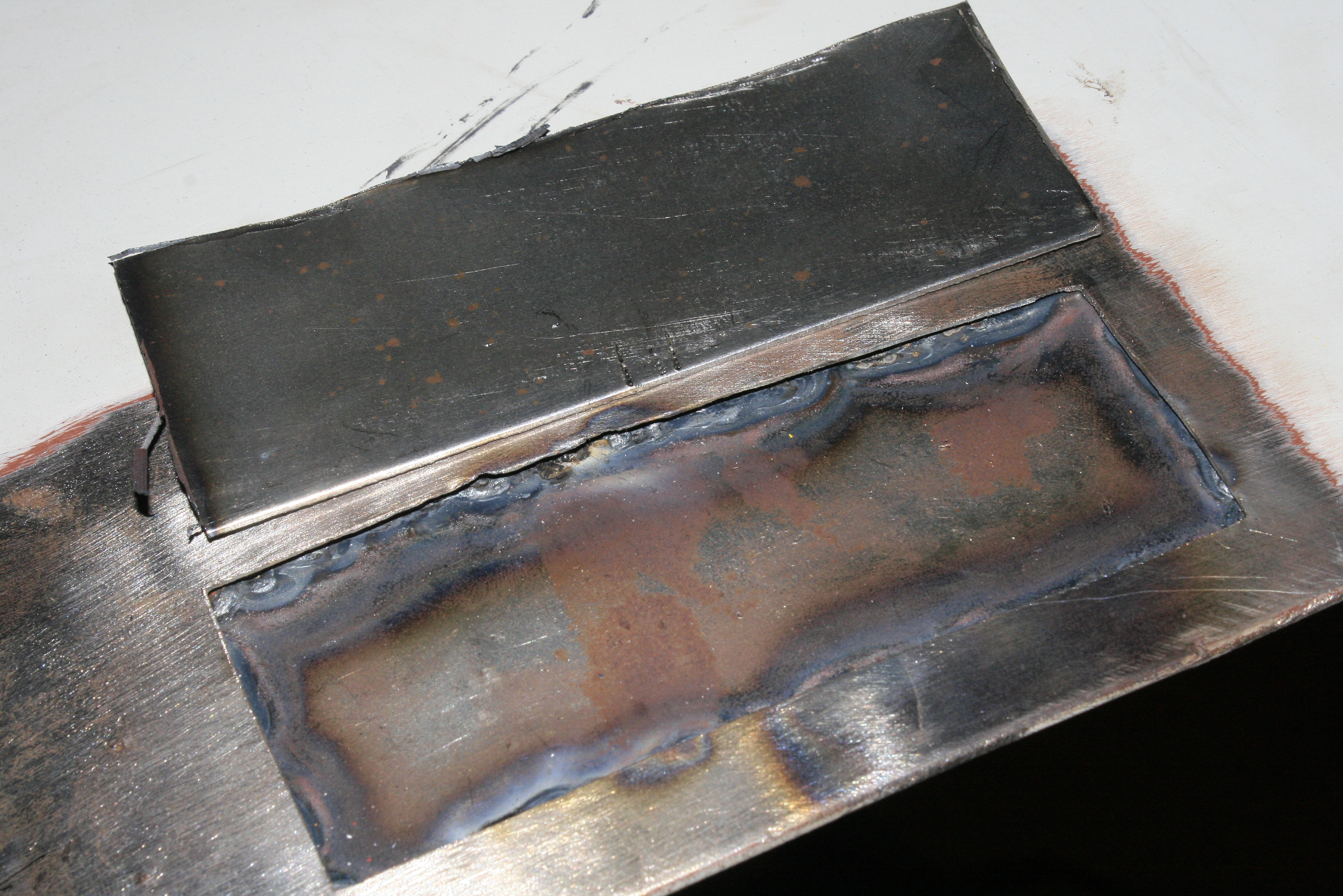

Posts: 368

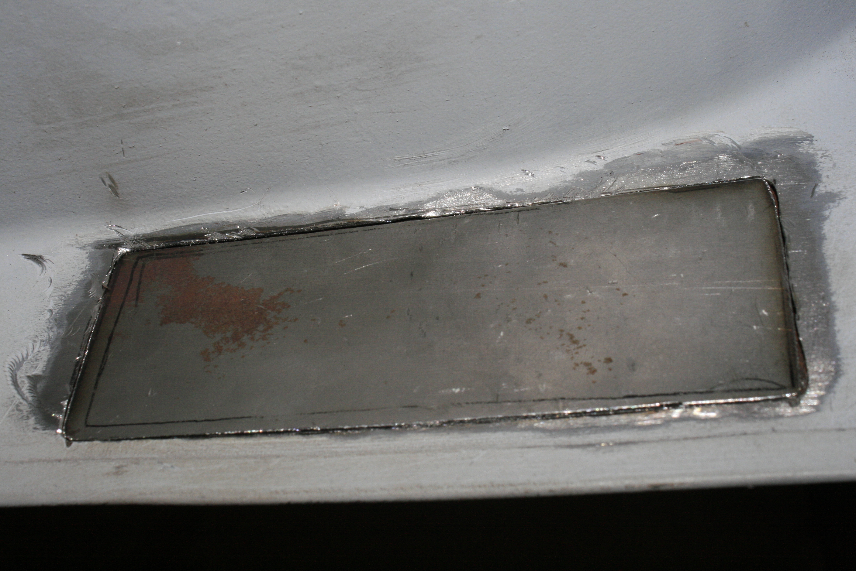

......Not The Best Job I Know, It's Quite Hard To Weld & Work With Half Rusted Sheet Metal (That Being All The Bellett's Metal) But Dad's Step Idea Helped Dissipate A-Lot Of The Heat & Most Of The Welds Were Fused Correct From What I Can See But I Can Also See A-Lot Of Bad Welds (More So After The Clean Up) & A Need To Go Back Over It Again Haunts My Mind......

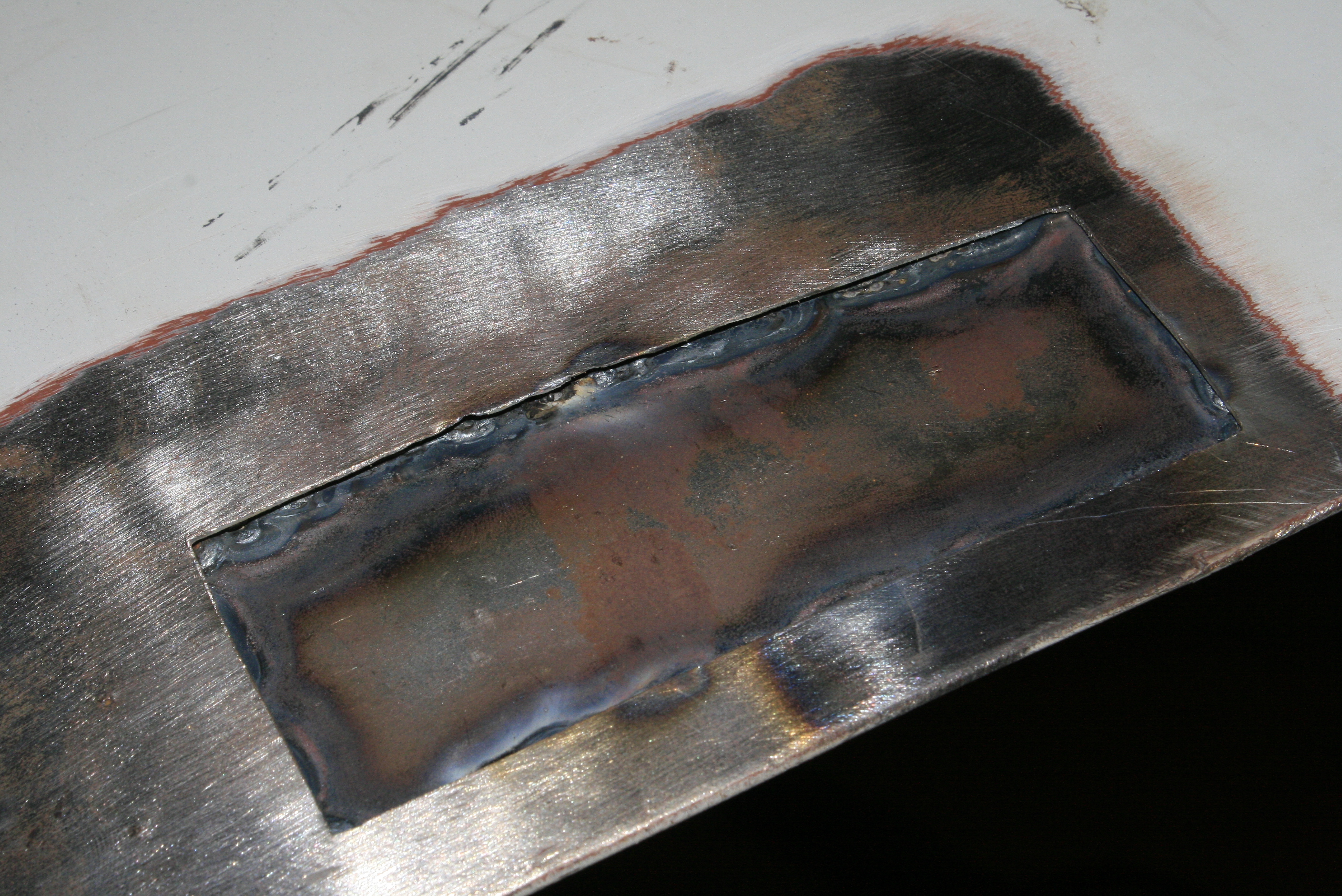

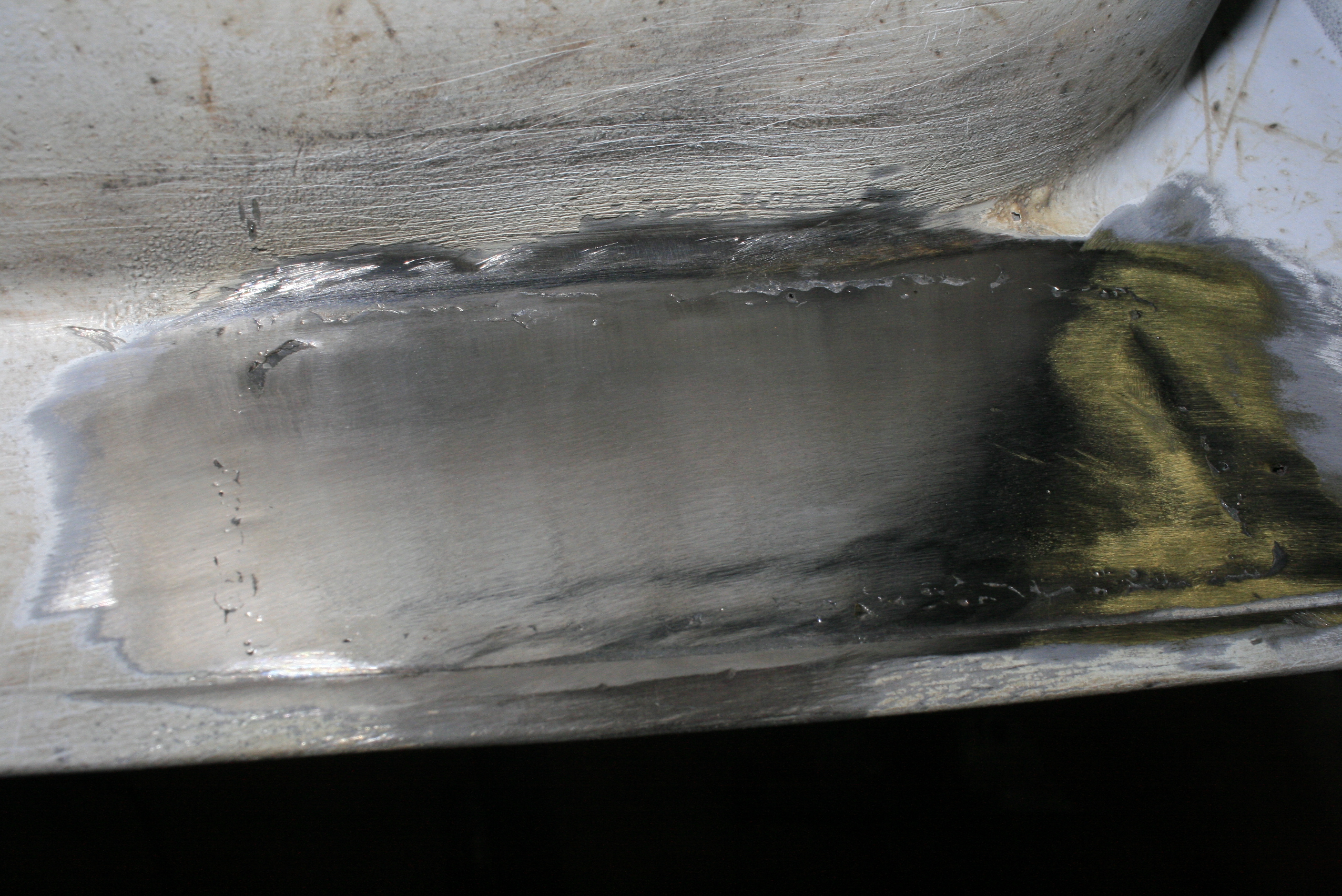

Posts: 368
.......After The Welds Are Sanded Back Is When I Get To Check & See If Its All Fused In Or Not, (?).......

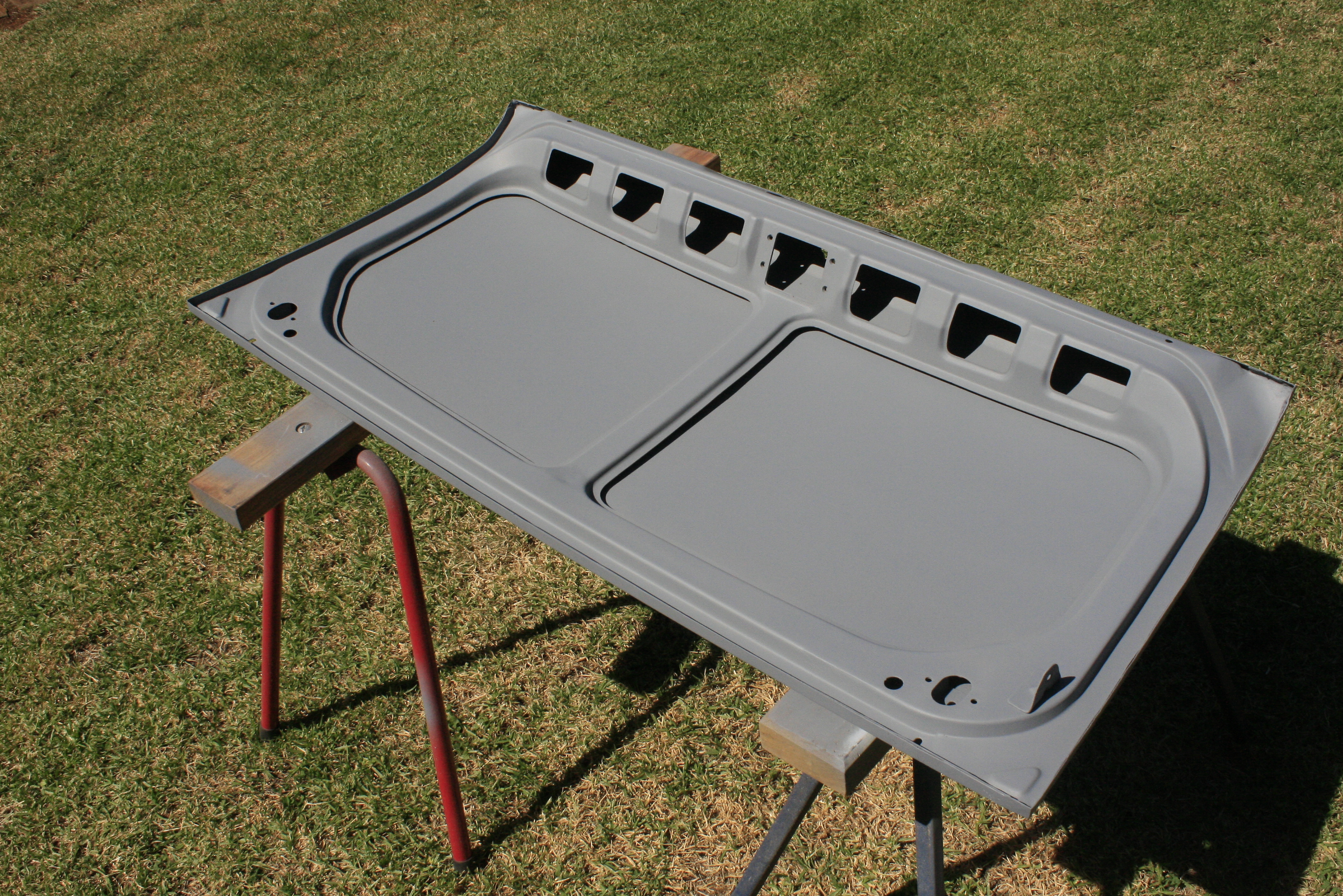

Posts: 368

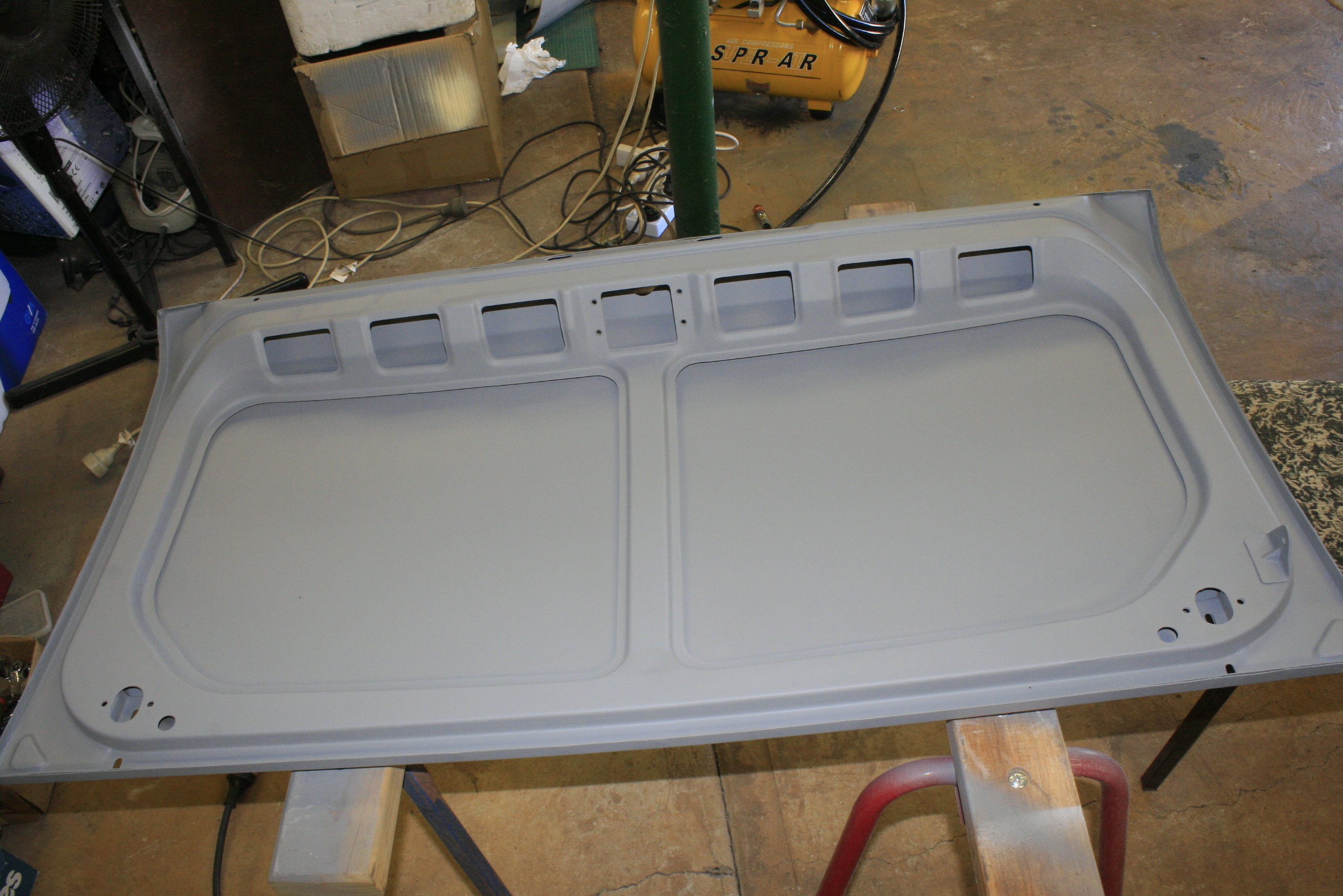

.The Boots Inner After A Coat Of Etch Primer.
