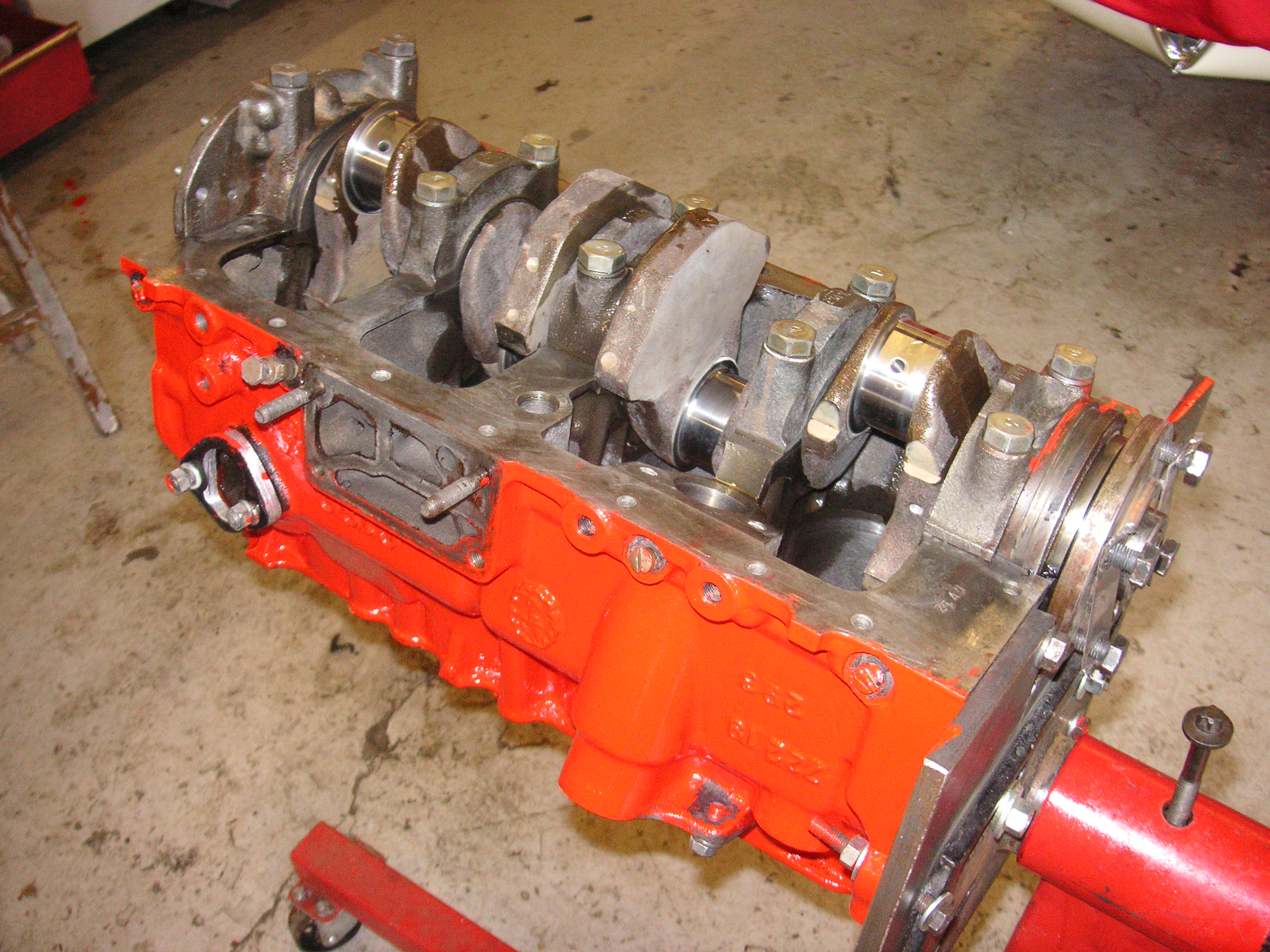

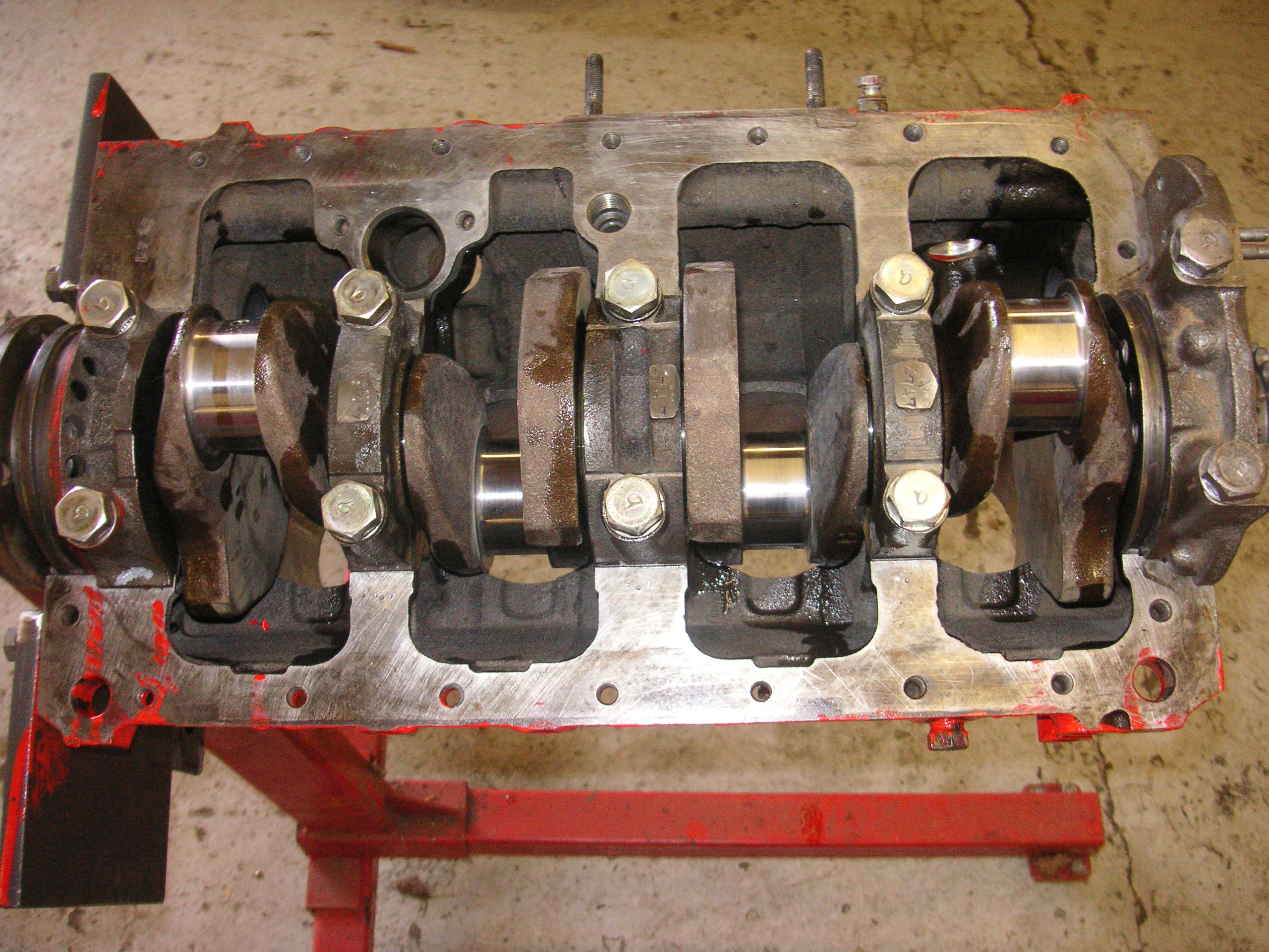

OK Rolie fans...the block is back, the crank, flywheel and clutch are balanced.
And we've splashed Sticky's favourite 'go faster' super quick paint all over the place.

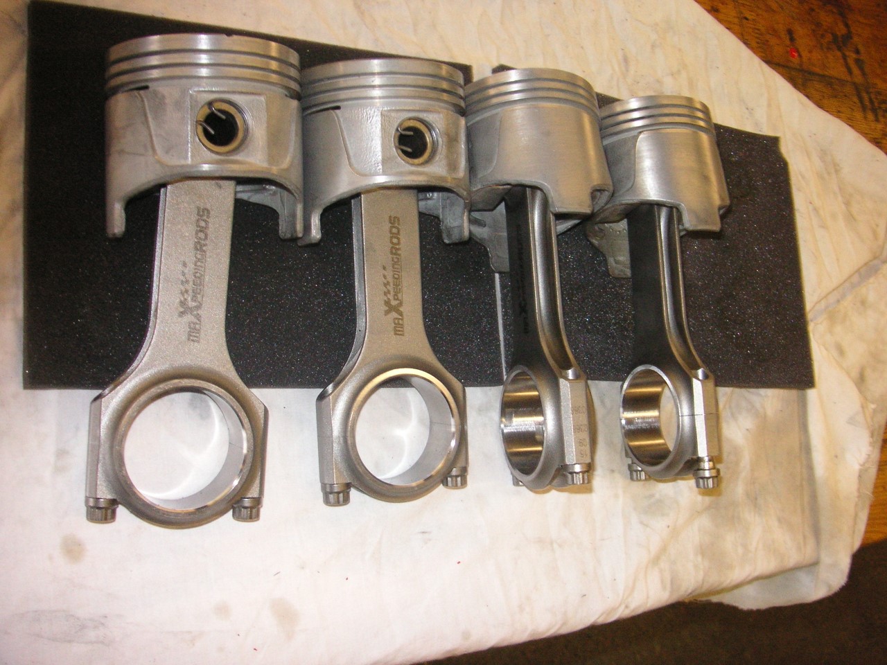

My 'aero' spec rods don't match the gudgeon pins, so there's a little extra work to be done there, but otherwise we're on schedule...........good grief, did I really just say that?!

Damn right Sticky, although if you think the paint looks quick....check out these rods.
They've even got "maXpeeding" embossed on them!

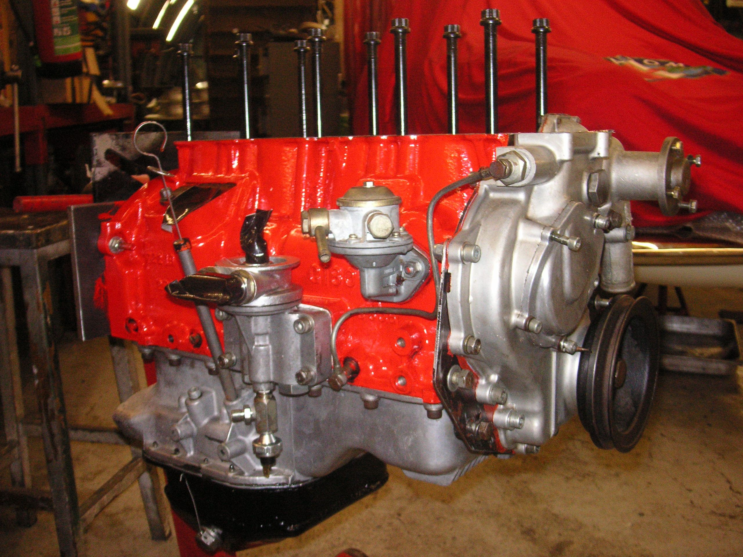

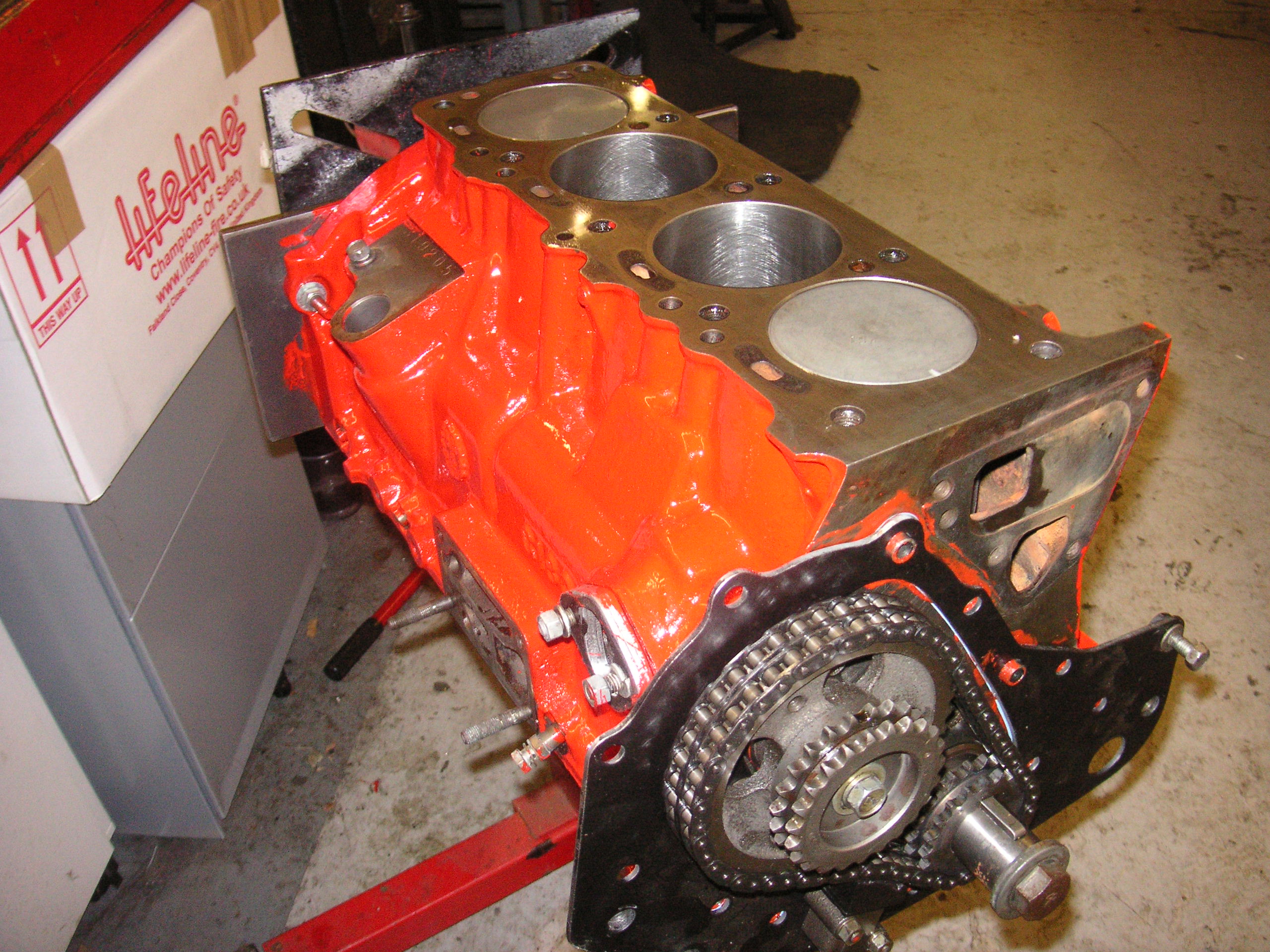

I'm with you there Glen........anyway a few more shots of the engine build.
+1.5mm pistons in, giving us a displacement of 1889cc.

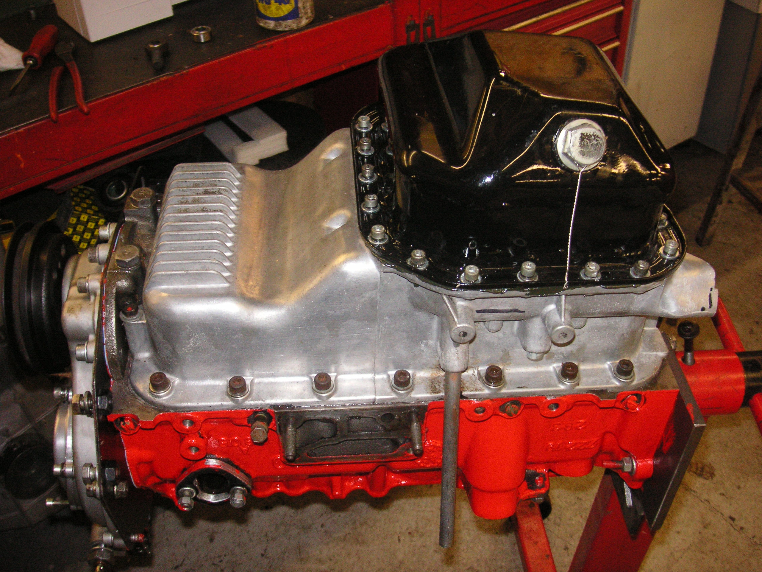

We've also got our trick 'deep' sump on.
I'm so excited about testing this thing, that I'm going to blow the froth off a couple with Ben Stokes.

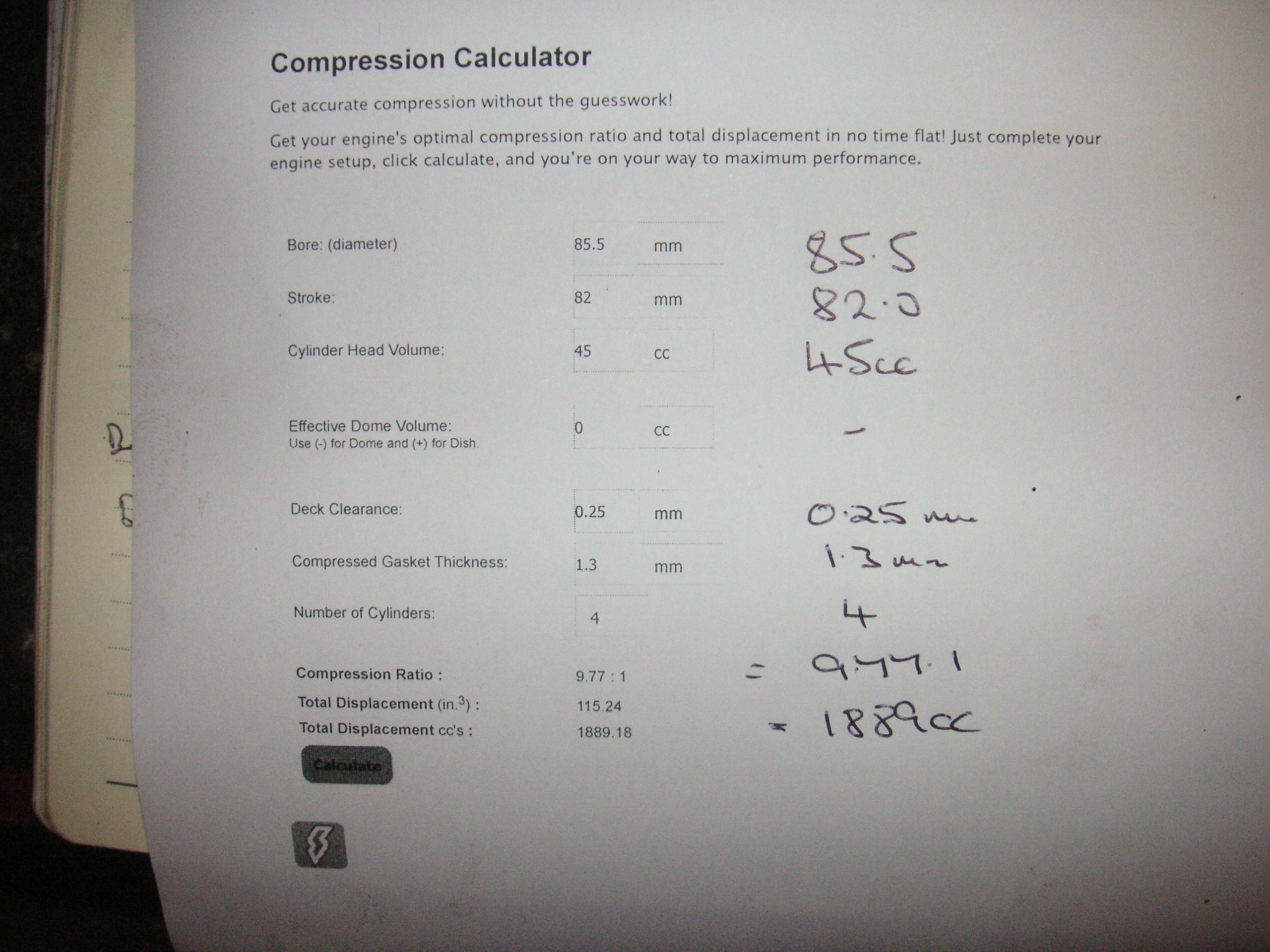

whats the calculated CR Mark
As you can see Glenn we're at 9.77...previously we were at 9.29. This will help us go a little more aggressive with the cam...but my cam folk are not sure whether the stock donor cam can handle such a re-grind, we should find out in the next few days.
Thanks for the info. I thought it maybe a bit on the low side with the flat top pistons. Not that i am any expert.

http://www.csgnetwork.com/compcalc.html
Mark, just curious, this calc gives 9.52:1 ?
Wed Nov 01, 2017 8:35 am
Posts: 487
Ha. It appears the figure you end up with depends on who's calculator you use....the only difference I can see between the two is that yours has a column for 'head gasket bore diameter'
Fortunately we're only really concerned with how we compare with our last engine build, so we're safe as long as we always use the same calculator.

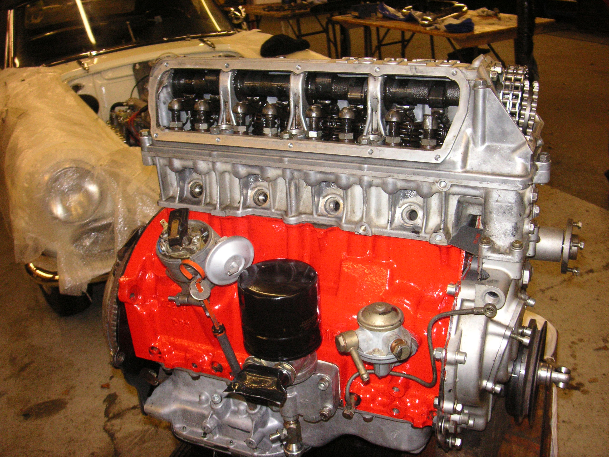

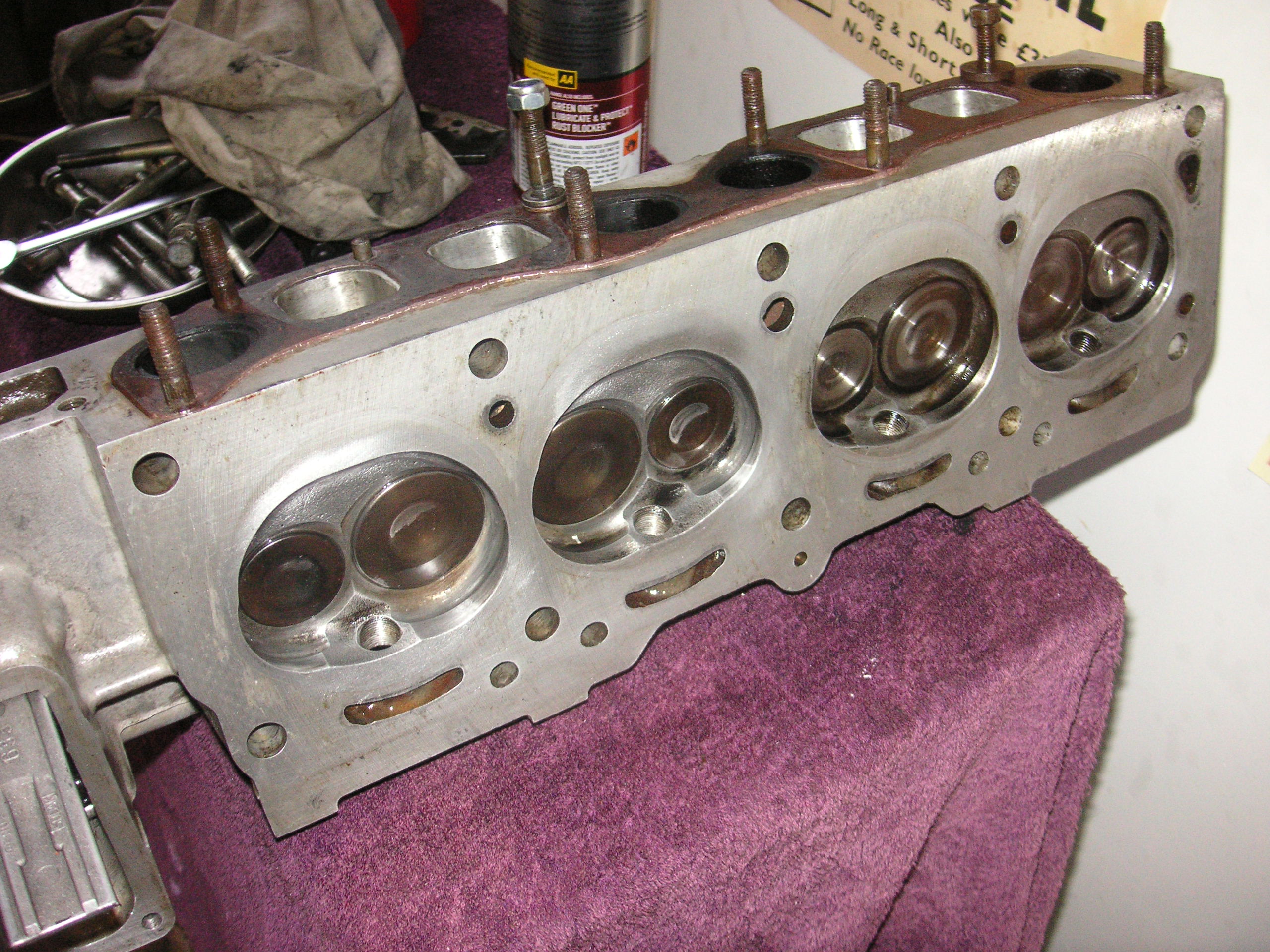

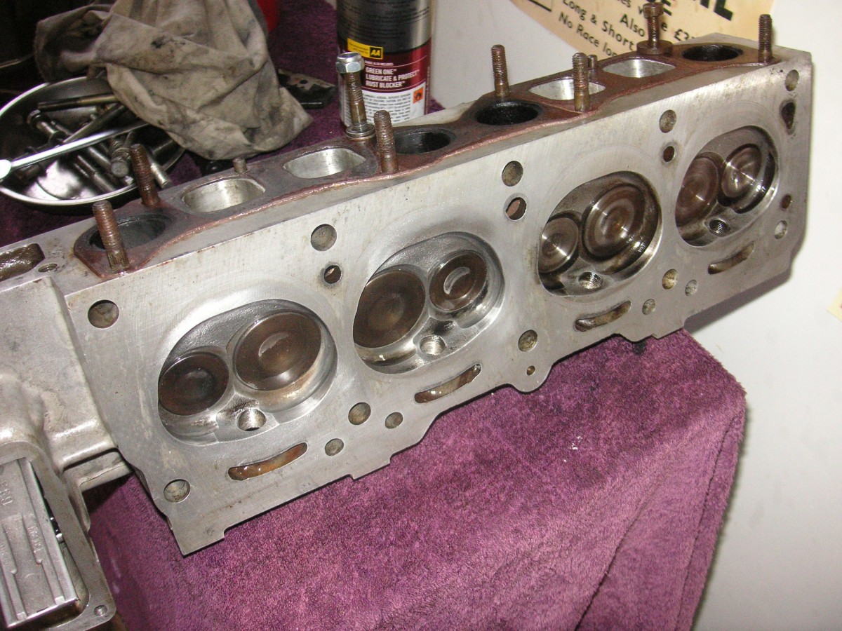

The motor's pretty much done now...here's the business end before it goes on.
Torqued down.

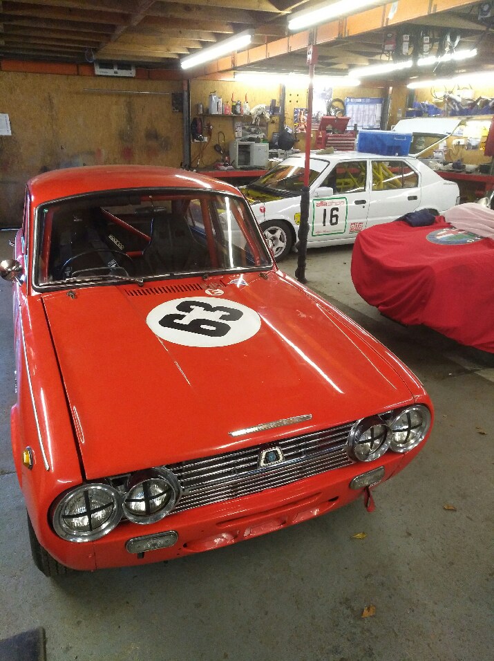

Well, I'm sort of surprised to be saying this, but the car is ready for the test tomorrow. And I'm really looking forward it, that seductive but money grabbing hand of motorsport has got a good grip of me again.
What's also really pleased me is that Big Simon (my sometime second driver) has resurrected the old Alfa 33 we raced a good few years back.....it was my second race car, but my first love.
He'll be testing it tomorrow as well.....if it goes well, it'll bring back a few happy memories.
Here's both cars, prepared and ready to go.
