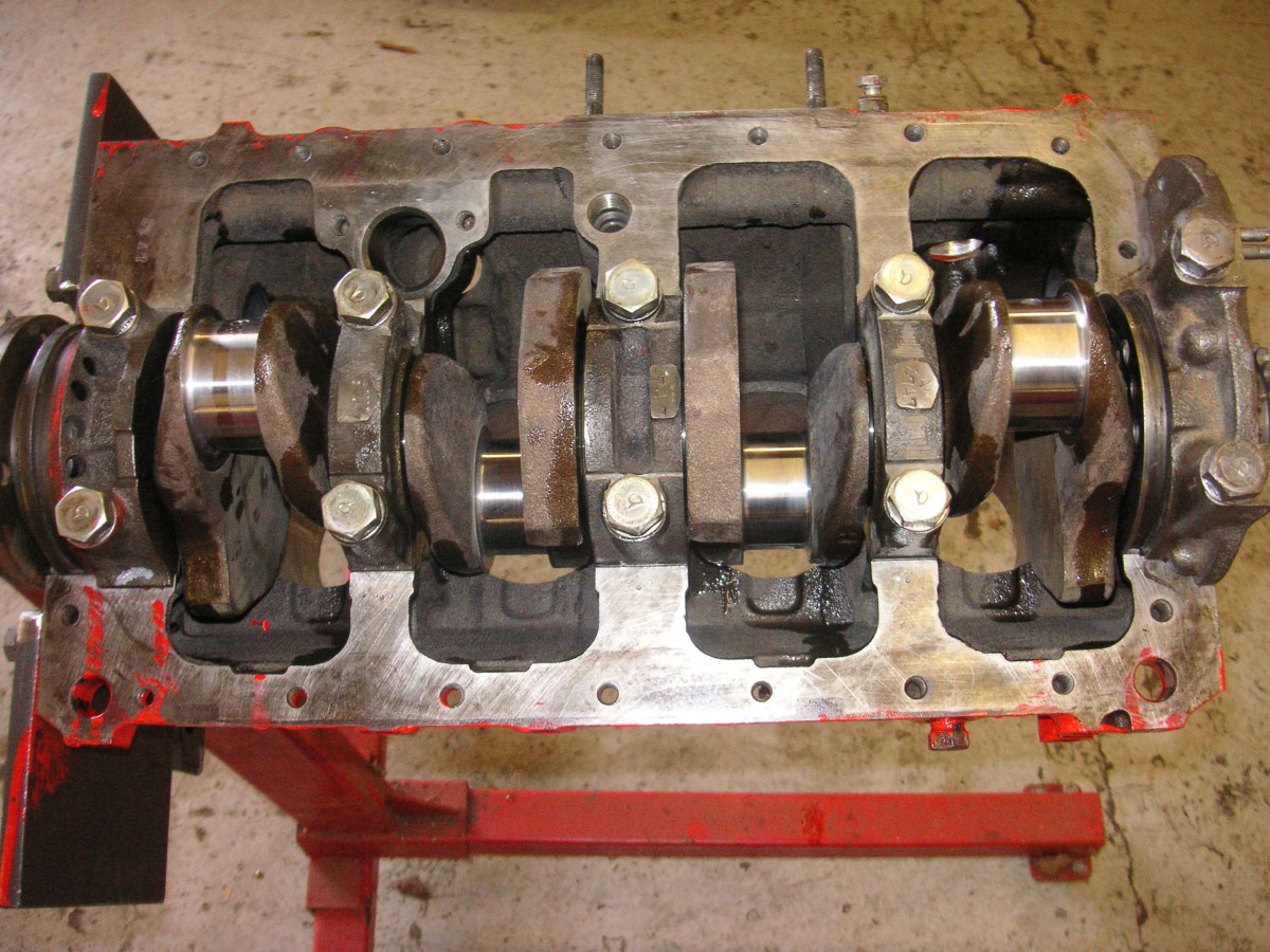

I'm with you there Glen........anyway a few more shots of the engine build.
+1.5mm pistons in, giving us a displacement of 1889cc.

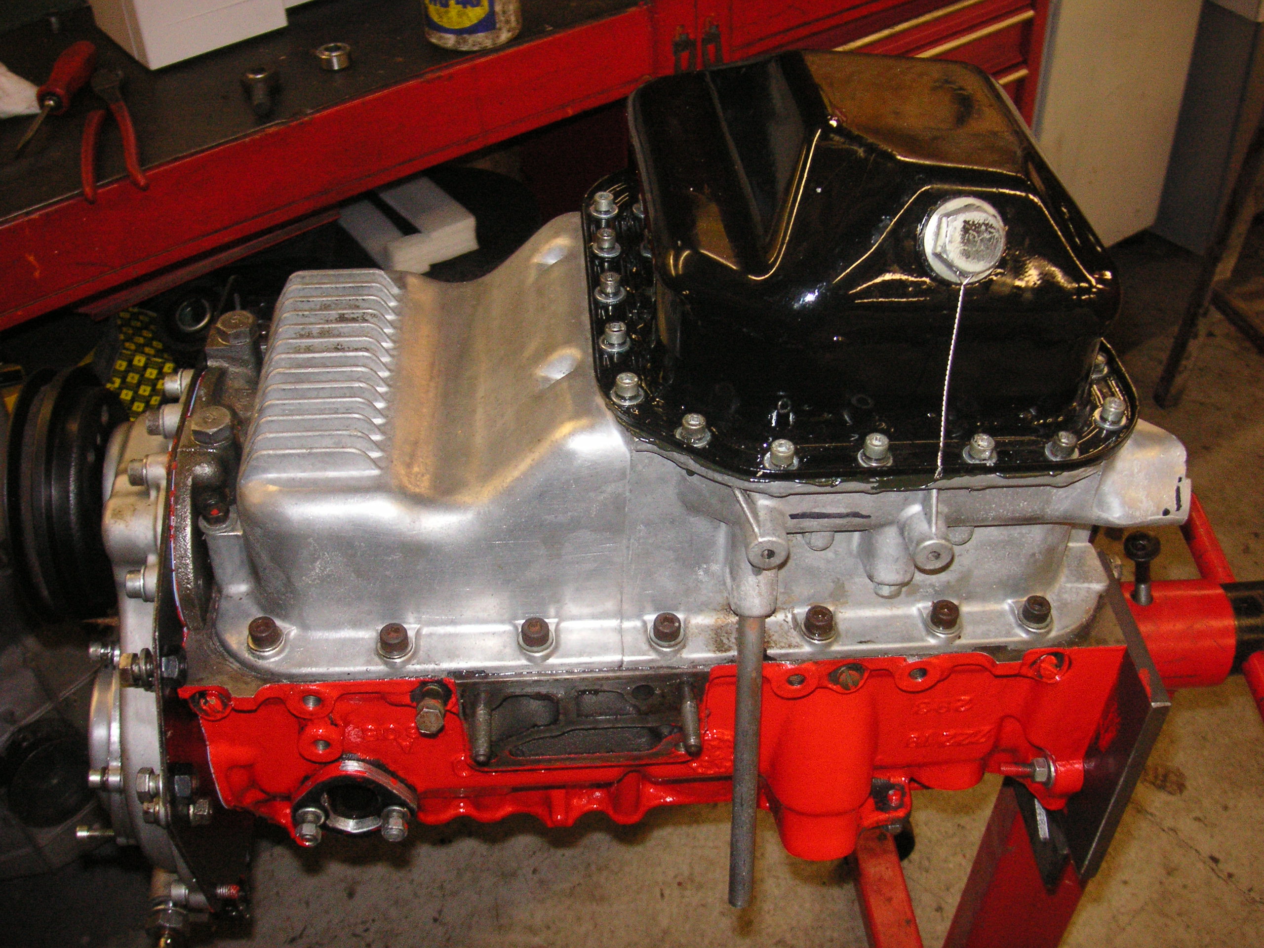

We've also got our trick 'deep' sump on.

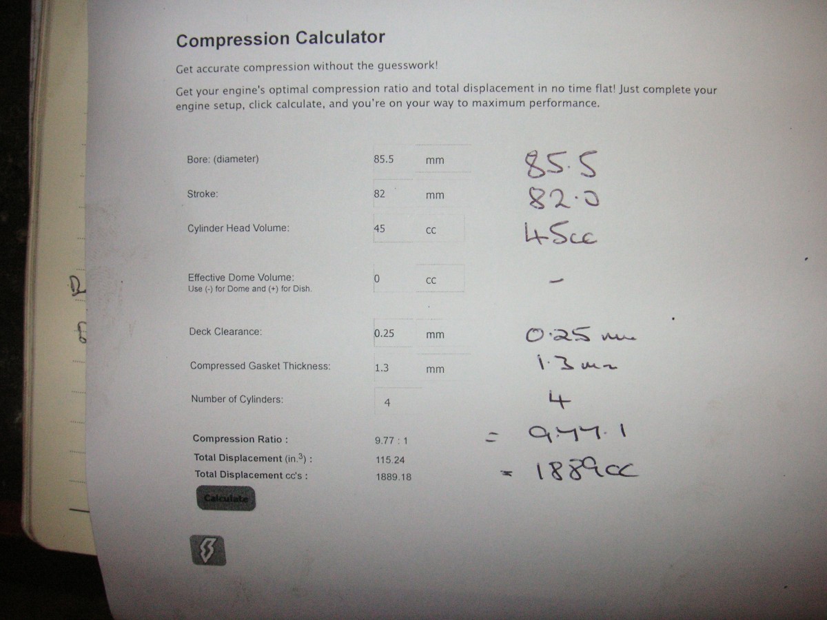

whats the calculated CR Mark
As you can see Glenn we're at 9.77...previously we were at 9.29. This will help us go a little more aggressive with the cam...but my cam folk are not sure whether the stock donor cam can handle such a re-grind, we should find out in the next few days.

http://www.csgnetwork.com/compcalc.html
Mark, just curious, this calc gives 9.52:1 ?
Wed Nov 01, 2017 8:35 am
Posts: 490
Ha. It appears the figure you end up with depends on who's calculator you use....the only difference I can see between the two is that yours has a column for 'head gasket bore diameter'
Fortunately we're only really concerned with how we compare with our last engine build, so we're safe as long as we always use the same calculator.

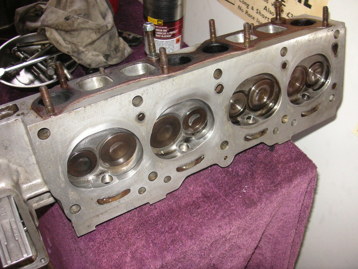

The motor's pretty much done now...here's the business end before it goes on.
