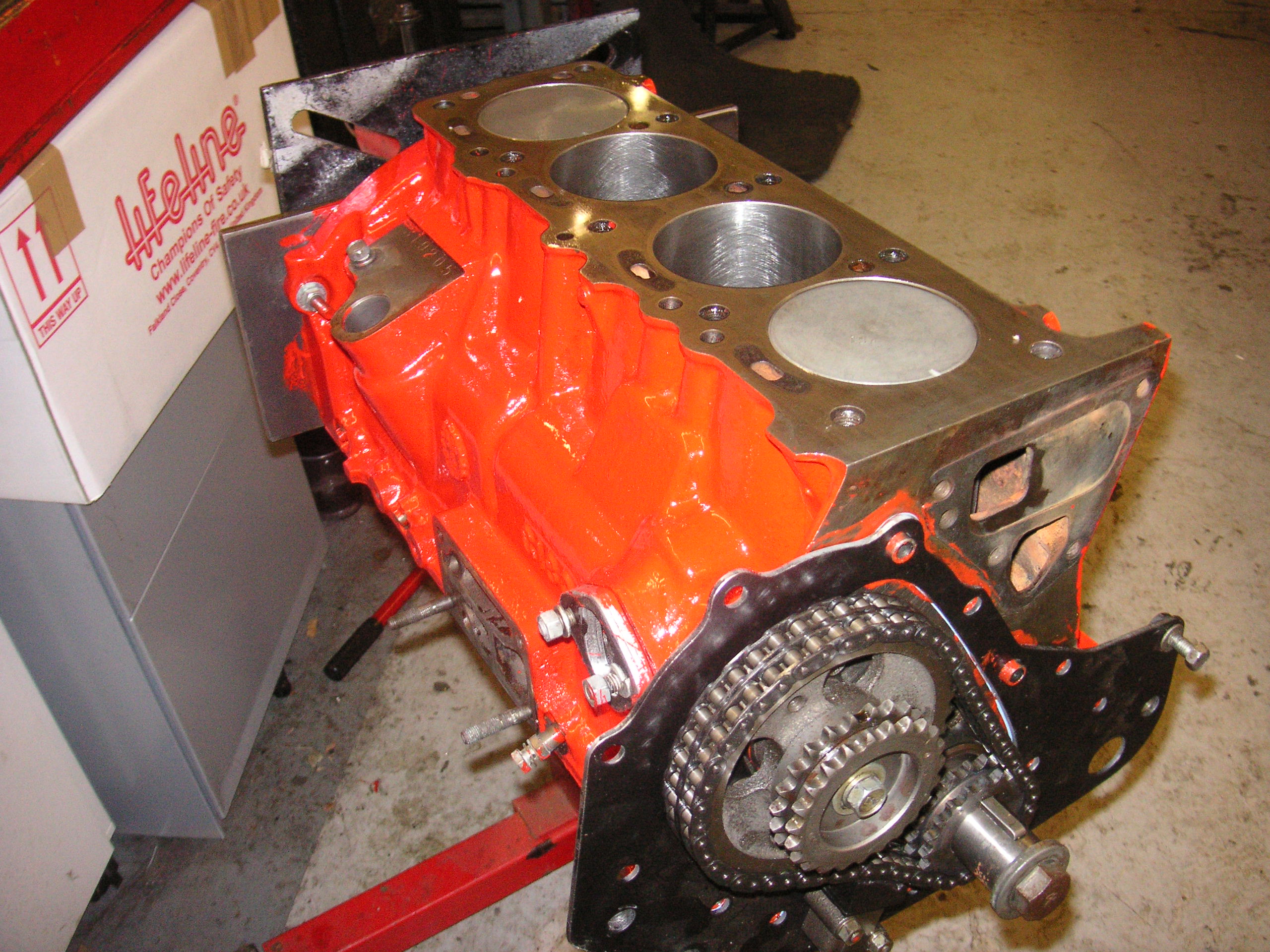

OK Rolie fans...the block is back, the crank, flywheel and clutch are balanced. Attachment:
And we've splashed Sticky's favourite 'go faster' super quick paint all over the place. Attachment:
My 'aero' spec rods don't match the gudgeon pins, so there's a little extra work to be done there, but otherwise we're on schedule...........good grief, did I really just say that?!

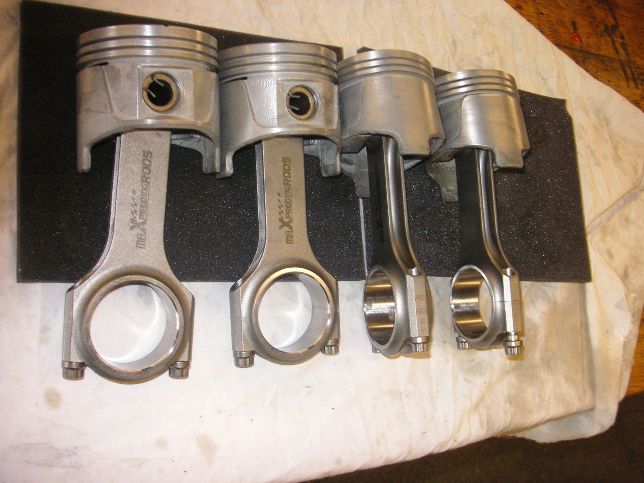

Damn right Sticky, although if you think the paint looks quick....check out these rods. Attachment:
They've even got "maXpeeding" embossed on them!
| Mon Oct 09, 2017 3:00 pm |
Stickman
Those beauties look as though they would empty your wallet at least 2 seconds a lap quicker There are only termites that have starved to death in my wallet
| Mon Oct 09, 2017 9:03 pm |
Joined: Tue May 10, 2011 2:23 am Posts: 2826 Location: Melb.
Pombellett wrote: Damn right Sticky, although if you think the paint looks quick....check out these rods. They've even got "maXpeeding" embossed on them! Hope they are 'fast' as they sure look expensive .......... glenn

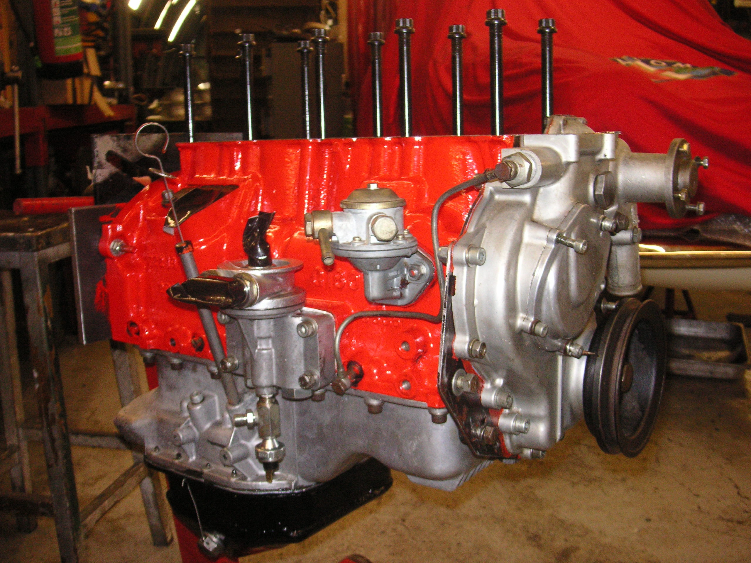

I'm with you there Glen........anyway a few more shots of the engine build. Attachment:
+1.5mm pistons in, giving us a displacement of 1889cc. We've also got our trick 'deep' sump on. Attachment:
