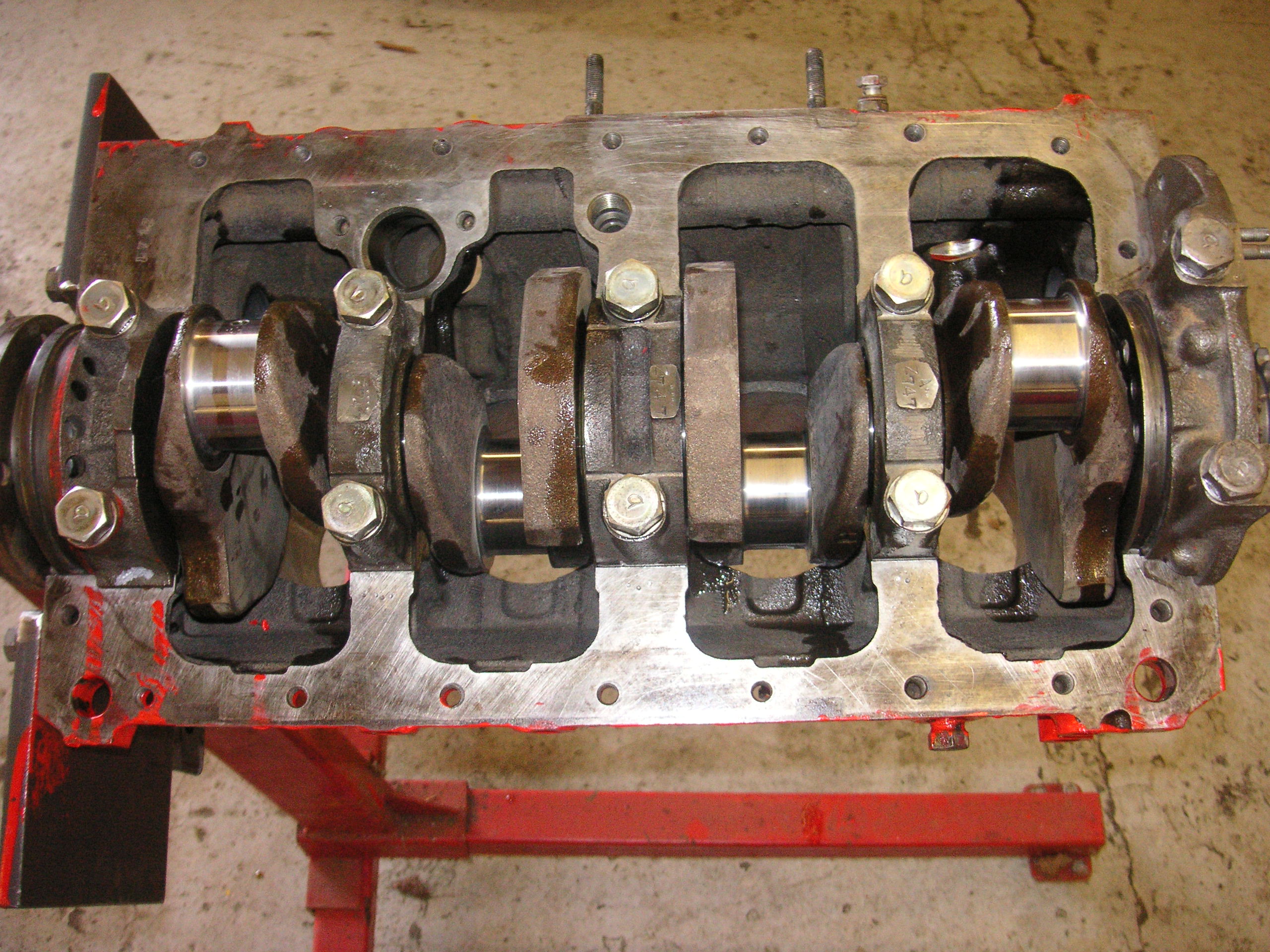

OK Rolie fans...the block is back, the crank, flywheel and clutch are balanced.

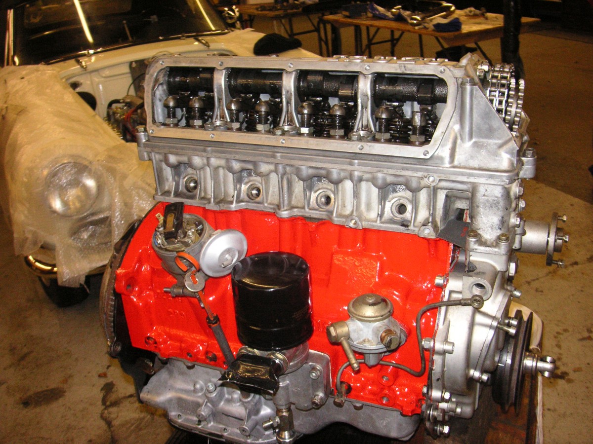

The motor's pretty much done now...here's the business end before it goes on.
Torqued down.

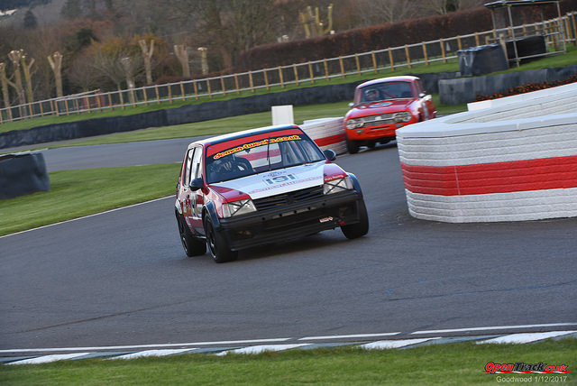

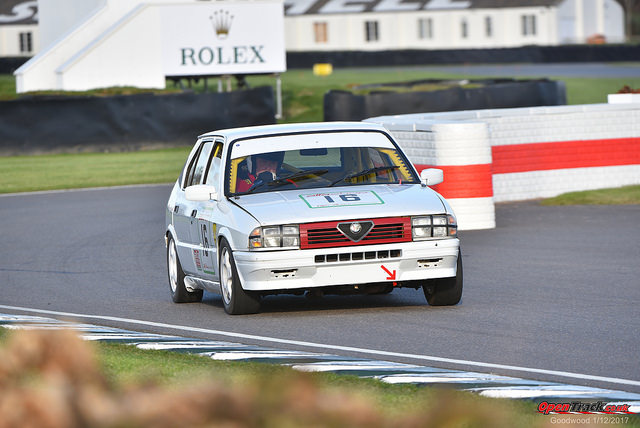

This is also the first time we've run at Goodwood with the GT box and short diff, and the improvement is startling.....we're pretty much at peak revs all around the circuit, and we could give a few of the 'track day warriors' the hurry up.
