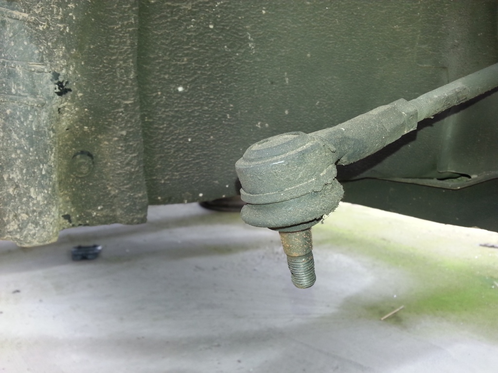

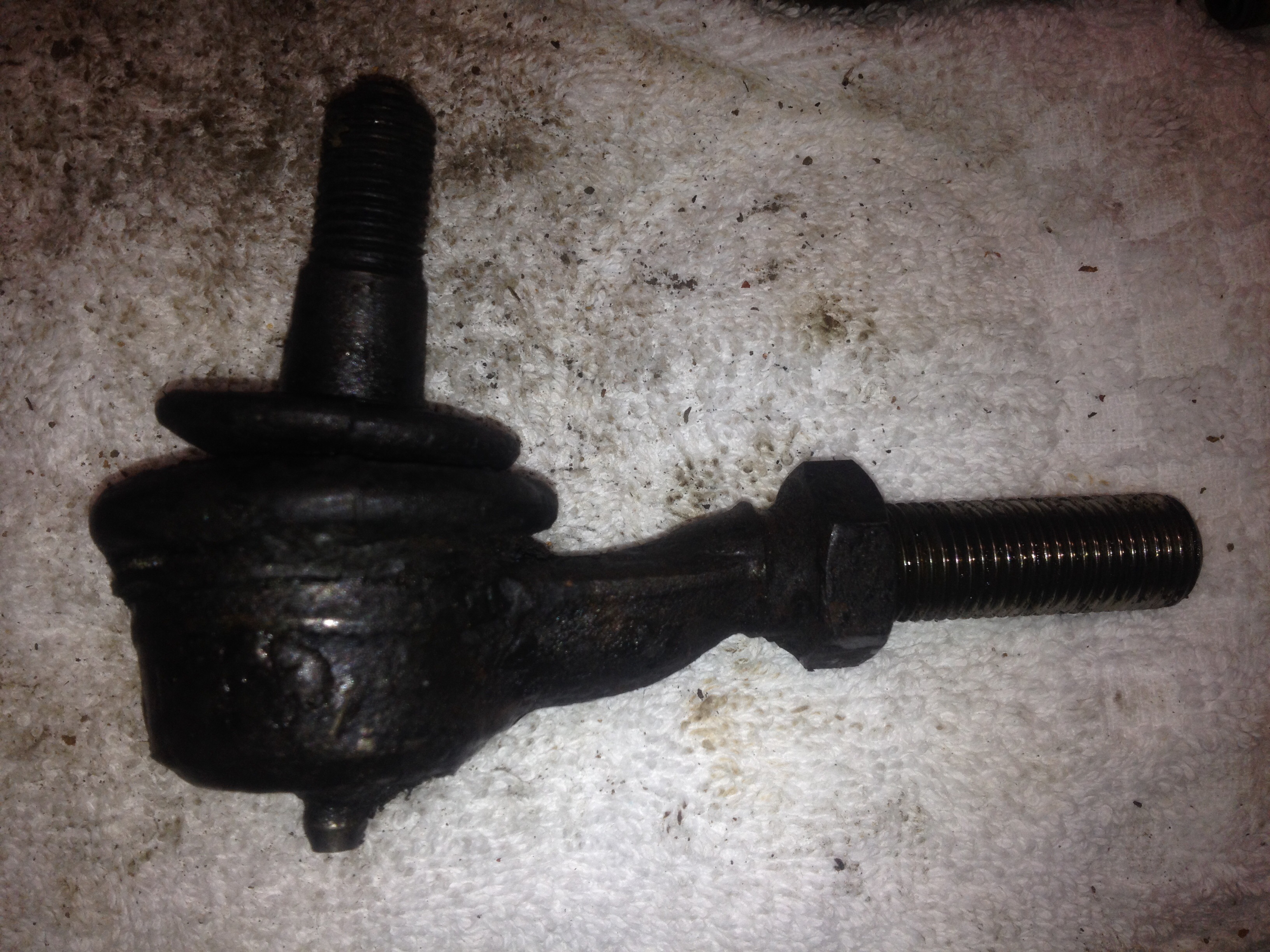

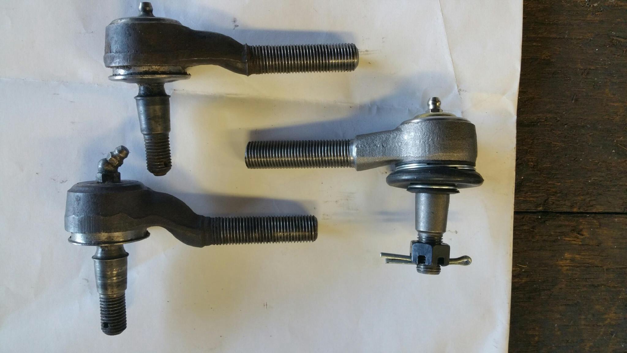

I was in the wreckers the other day and saw a couple of tie rod ends.......... CAUTION, i have no idea if these actually fit but they look similar in size to Bellett. Info given as is... ! Might be worth checking further if one has a spare steering arm ( I don't) to try the fit, and if ok, measure up length, thread size etc.

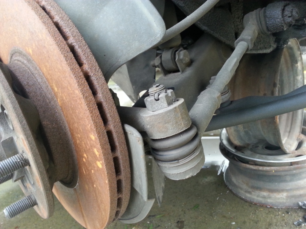

Kia...... forgot to check actual model.

Hi all
I am still on the hunt for Tie rod ends
Has anyone ever tried Datsun 200B or Toyota Corona ?
J

Asroc66 wrote:
Anyone?
The critical part is the taper. The thread section can be overcome with an adapter if needed.

Negative for the Corona, taper too big
Next..... Datsun 200B / 240K
J

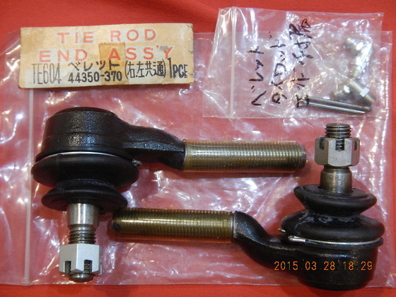

this is the ones ...in japan ...on yahoo

Yep
They Could be the ones....
I'm trying to find a longer solution for all by finding cheap readily available alternative.....
Much like the brake upgrade....
Thinking long term so we can keep enjoying our little cars
J
Thu Nov 05, 2015 8:49 am
this way up easier to compare

Finally found the add in Japan
$388 + Postage is the starting bit.......
So my point wasn't specifically relating to the brake upgrade as such rather to find a cheap, readily available alternative to the NOS Bellett tie rod ends for standard vehicles....
J
Thu Nov 05, 2015 9:01 pm
The part number 44350-370 is the genuine number for sedans and GT's up to '66.5.
After that date it is 44350-418. According to Isuzu there is NO interchange.
They changed the steering arm at the same time. If I had a used arm and end off of a
vehicle I would use both to be safe. But. Before I do. I would check the history of the donor
and also check dimensions.
Isuzu did quite a lot of changes in the front end around certain chassis numbers and dates. '66/'67.
I haven't got any parts for the steering and suspension for vehicles prior to "66.5 so I'm not able to
compare. Maybe somebody with access to these parts might be able to check.
